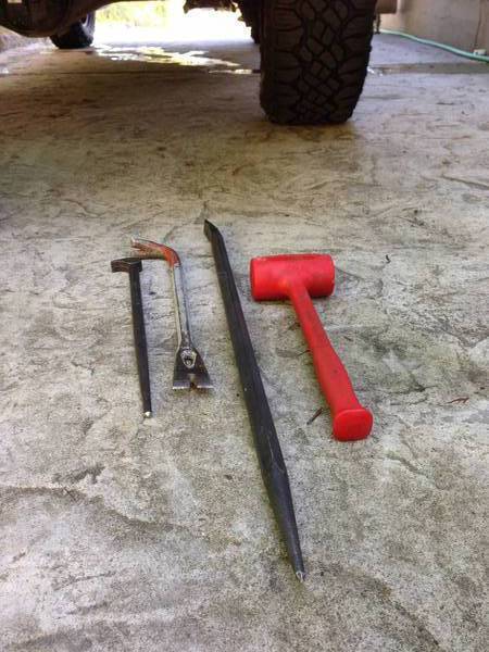

    Tools needed:
    Dead-blow hammer
    Various pry bars

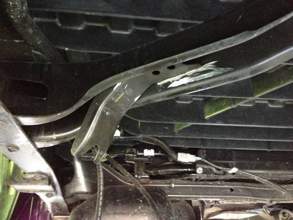

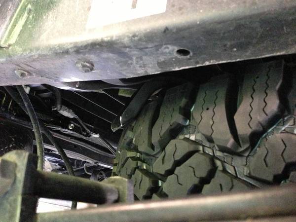

    I started to cut out the driver side tire locator tab; then realized that I could just bend both tabs. The dead-blow hammer made easy work out of it. I bent them out about 1" - 1 1/2". Leaving these tabs in place; keeps the spare pushed back against the hitch receiver and away from the rear diff. (I painted my grinder marks later).
    [​IMG][​IMG][/url][/IMG]

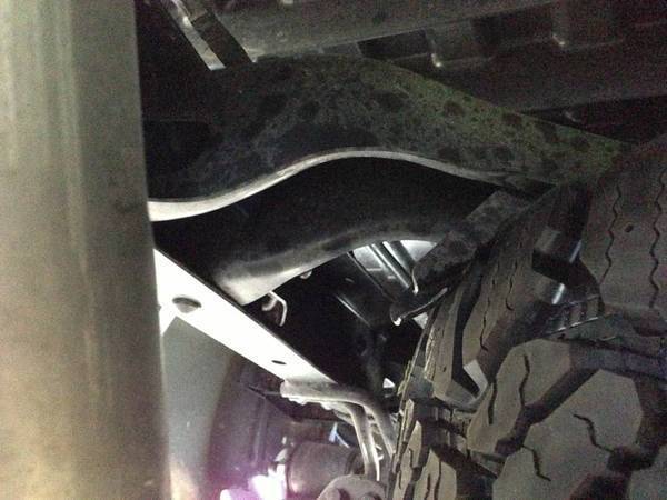

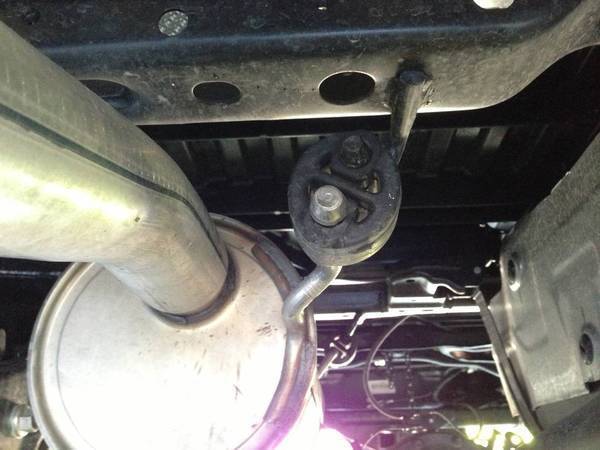

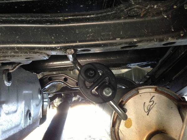

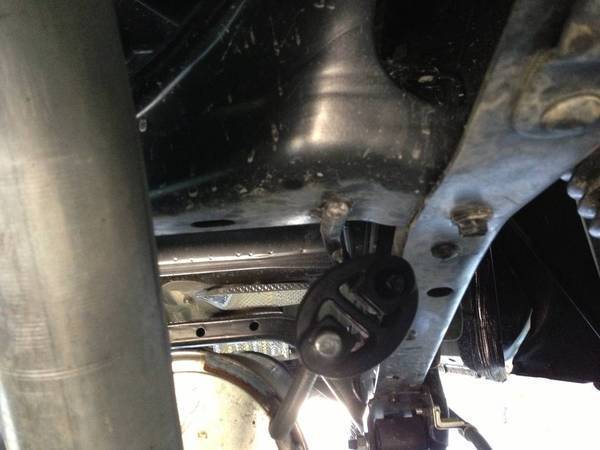

    In test fitting the tire, I found that the tire was hard up against the driver's side spring perch and my TRD exhaust; like others have experienced and was expected. While this is not a big problem, I still wanted a little bit of space between the tire and tail pipe. So I used various pry bars; and re-located my exhaust hangers about an inch. Removing the rubber hangers on either side of the muffler made things much easier. I chose not to bend the rear most hanger; it didn't seem necessary. I found this process very easy to do; and bending the hangers in front & behind the muffler only took about 20 minutes. This resulted in moving the tail pipe out to the side about an inch; and gave me great clearance.
    Here's the forward exhaust hanger.
    Here's the hangers just to the rear of the muffler.
    [​IMG] [​IMG]

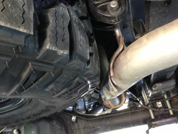

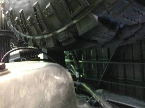

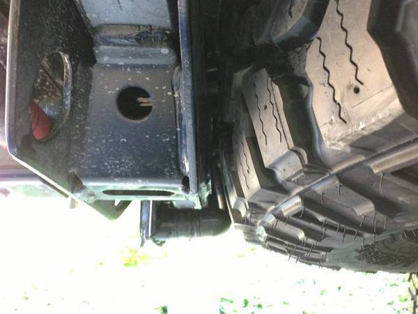

    Here's the results:
    Clearance to tail pipe
    Driver's side locator tab
    Passenger side locator tab
    Clearance to hitch receiver & rear diff.
    [​IMG] [​IMG]
    The tire isn't quite level because the spare crossmember curves down as it approaches the driver side spring perch. I don't care - it's out of my bed!:D
