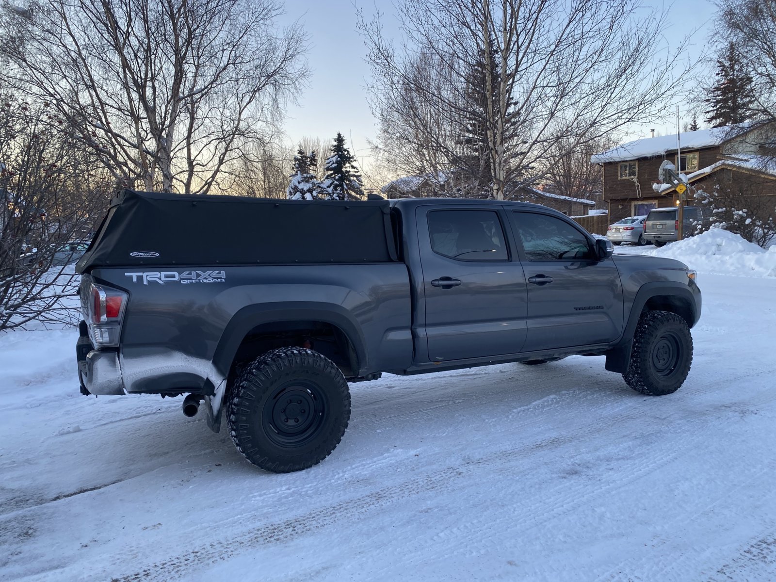

    Fifteen52. Analog HD, 16x7.5 0° Wrapped in 265/75/16 Goodyear Duratrac. Studded & Sipped

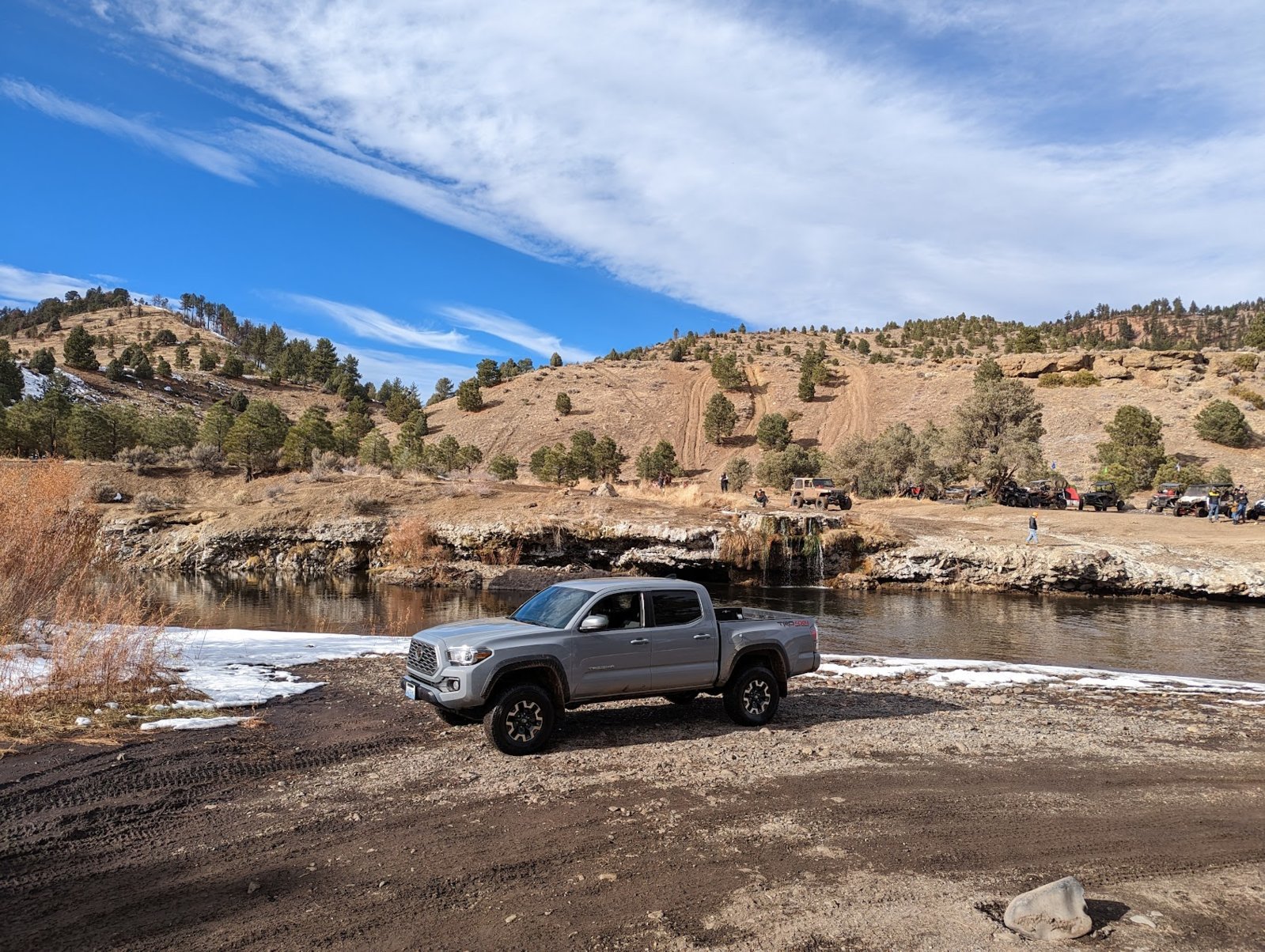

    Here's a better shot of my truck with the 2" spacer and 1.5" Add a Leaf.
    VS the Bilstein 6112's lifted slightly higher on 285/70R17.

    Wow! That looks amazing! The 285 set up is glorious, but that being said, the 265's on stock wheels and 2/1.5" looks really good too!
    I think I have found the answer to my question: I'll go with the full lift (probably 2.5/1.5) and then put the 285's on later. If it looks as good as your 265 set up I can deal with that for a few month or a year.

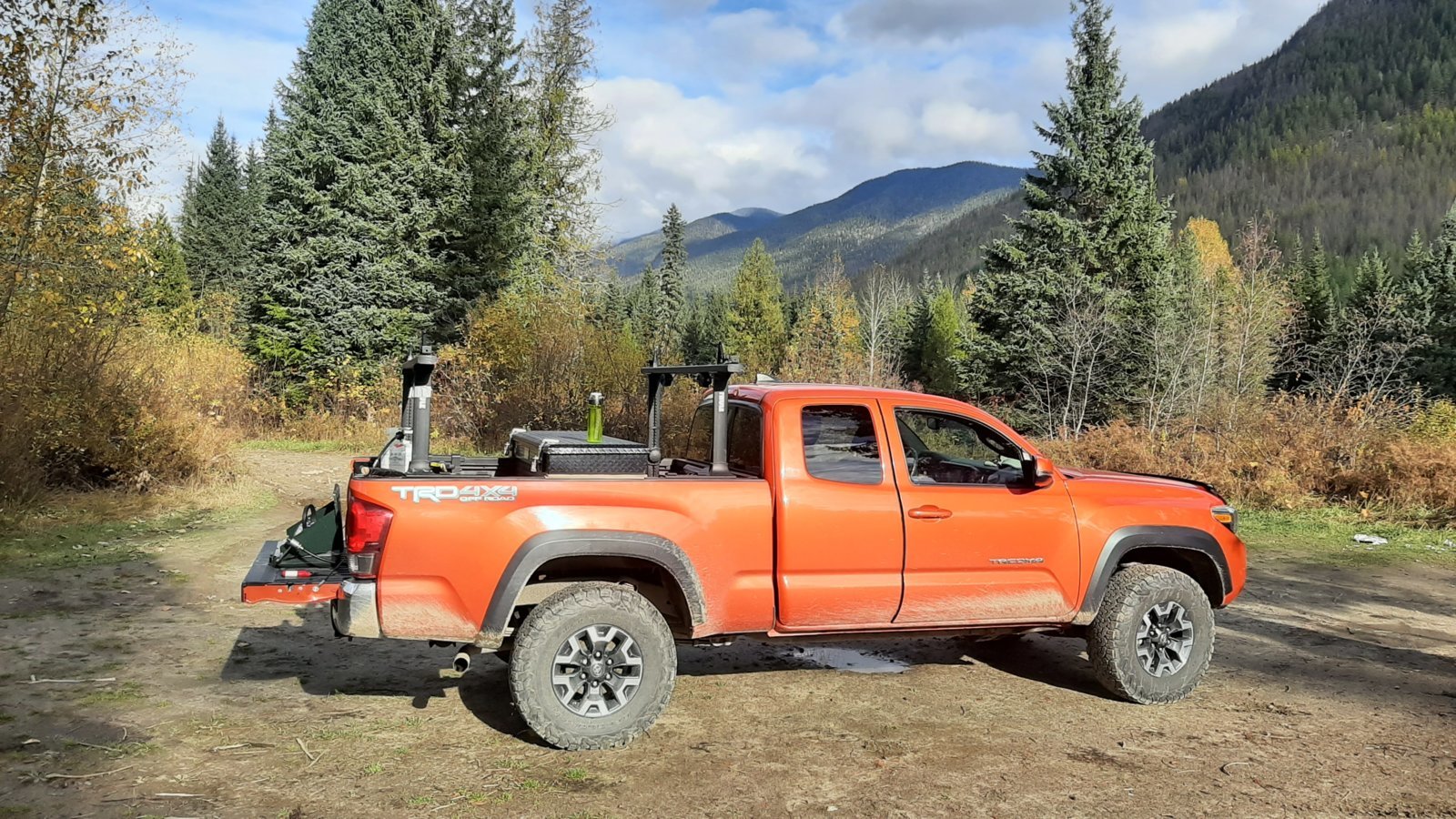

    Just added toolbox and roof-rack to haul my fishing boat 100's of miles into the backwoods every week. Goodrich K02s, Bilstein 5100 front and back, no lift.
    Make sure you are both talking same country for mpg.
    USA (3.8L per gal) so 17mpg = CDN (4.5L per gal) 20mpg.
    1 CDN gallon = 1.2 USA gallons.
    BTW, thats the only math I know aside from addition…
    My truck with Bilstein 5100s and KO2 265 75 16.
    Bilstein lift on front is a massive 0.8 inch…
    Back sits higher depending on what load I carry as I have Firestone air bags in the back. Those air bags are the best money I have ever spent on any truck over the past 40 years.
    My mpg dropped significantly going from 265 70 16 to 265 75 16, and both sets were KO2. I lost an average of 2.5 mpg with just that minor bump in size .
    On steep hills like the Coquihalla connector from Kelowna to Merritt, I also lost significant power on the steepest grades. With a heavy load in the pickup, I am now hitting a max 115kmh versus 130kmh with the smaller tire. So the engine working a lot harder on those steep grades due to the bigger tires.
    On the flats I would not have noticed much change in power.

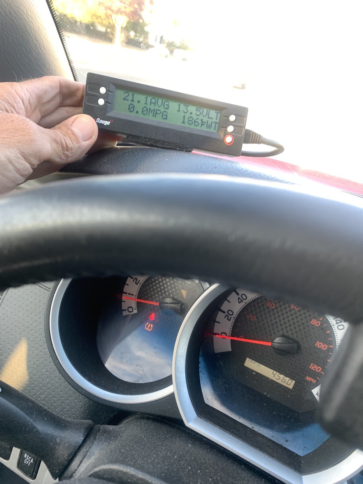

    Yeah I use a scan gauge with US gallons, I haven’t adjusted for the bigger tires so could be a hair better as well.
    I was running C load 285s KO2s which are lighter than the 265s E load.
    This is a shot of my scan gauge driving non stop from Kamloops to Jasper, 456 km getting 21 US mpg on that trip. 60mph speed limit though, which makes for easy driving.

    I believe you, if I was only going 60 MPH, it's much higher, when we drive HWY 2 over Steven's Pass or other 2 lane mountain roads that are 60 MPH or less, I see 18-19 MPG sometimes. It's usually fully loaded down with camping gear in the bed. I'm running SL's with the same load rating as a C, so I can understand how you're getting 20.
