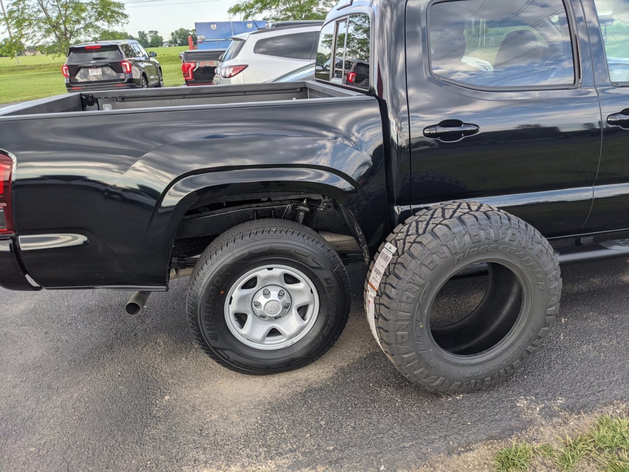

    Dropped the truck off today for a full ceramic tint & was able to compare some 33" wheels next to the stock. Definitely will help fill the wheel wells after lifting 3 inches. Stand alone, these 33s look huge, but next to the truck they're just right.
