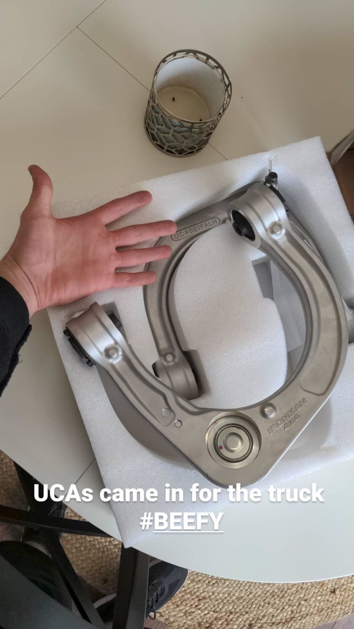

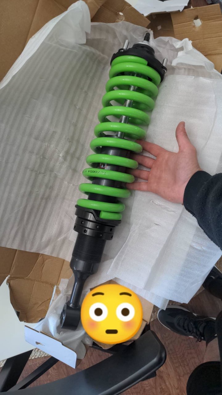

    Front Suspension Components came in today, just waiting on wheels & tires so I can get everything installed.
    Is there anything in particular I need to be aware of or that I should mention when I get everything installed?

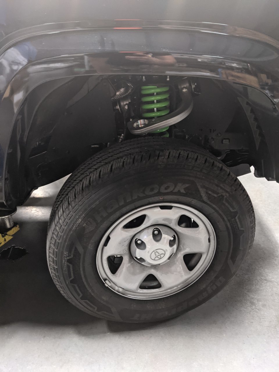

    My buddy & I installed the ironman lift today. Took about 4 hours. Wheels and tires getting installed Thursday. Feel accomplished & happy to have things coming together.
    The install was pretty straight forward, it was nice to learn about the suspension a bit, and local shops quoted me $1700 for installation. So it was nice to save some $$

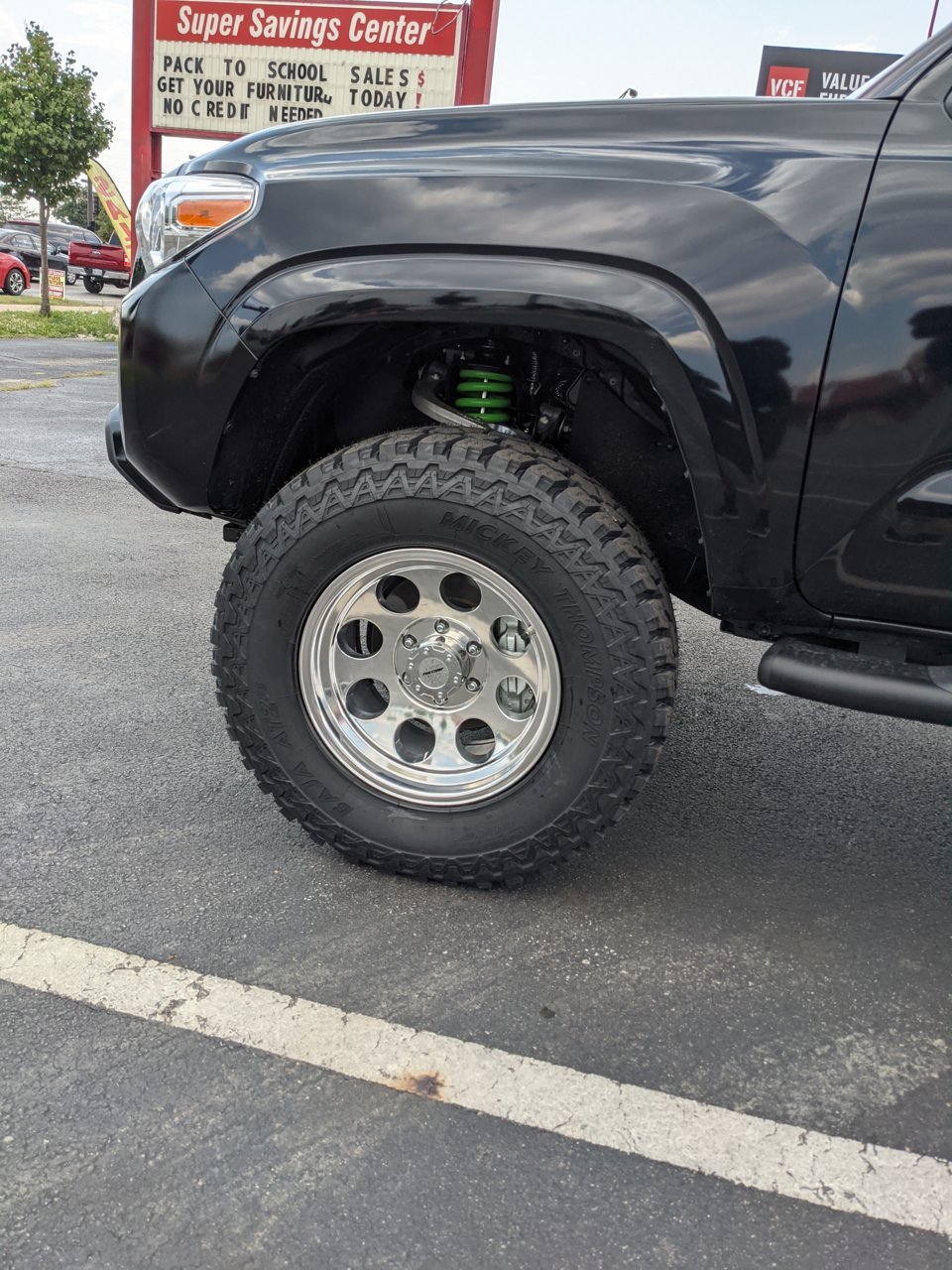

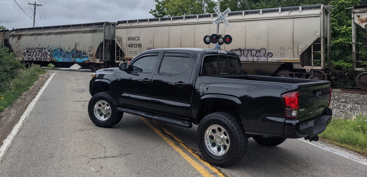

    Absolutely love the lift! Suspension is smooth as butter, runs much better than my stock suspension (SR Model)
    The tires I went with are mickey thompson atzp3. I don't hear the road noise at all. Rides smooth as well.
    I opted to install the lift myself with my friend who has a 2 post lift. It took maybe 4-5 hours, and was fairly straight forward following their install video.
    Hope you like yours! Send pics when you get it installed!
    Wheels I opted for are 17x9 -6mm offset.
    Tires are 285.70.17 Mickey Thompson atzp3
