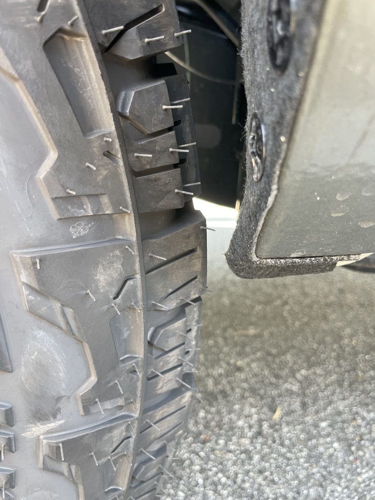

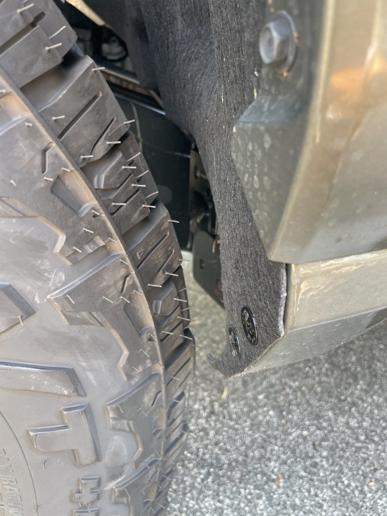

    Wow. Didn’t think it would fit.

    Was surprised myself, thought they were going to be 34s.
    So there you go, 35s and load range C. Pretty cool. Personally I would do 33s for lower rotational weight, but that is just me.

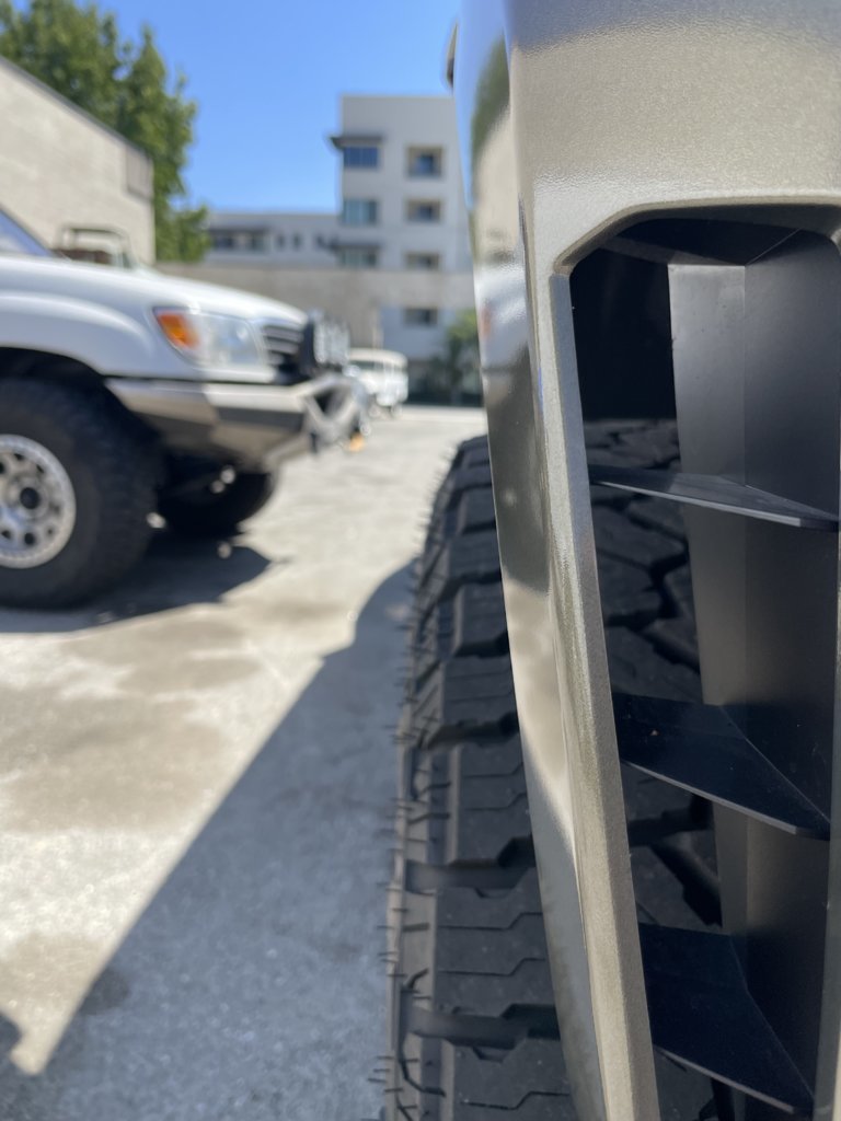

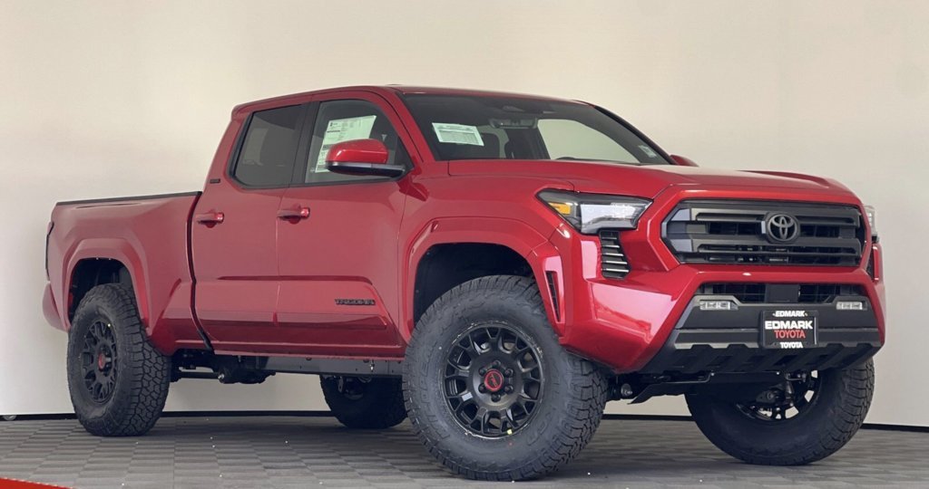

    Yes. People have been running varying positive offsets on the 4G to get the wheel back under the fender. I read somewhere +55 came with a stock rim in a particular trim, forgot which. Our TH rims have +20. This is a departure from the 3G, where negative offset was common.

    I see - dumb question then - where is the extra track width coming from? The +55 / +20 delta?

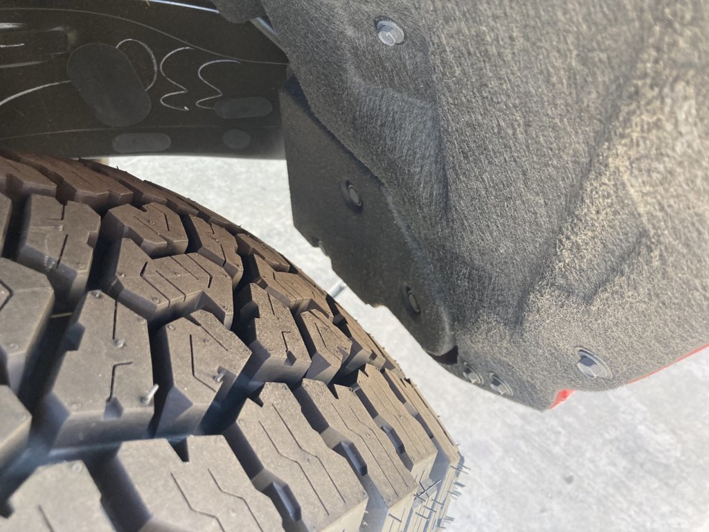

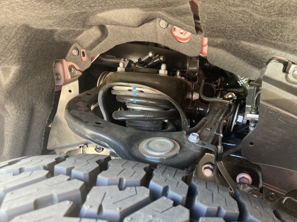

    My theory on the felt is that there are more electronics at the wheel and more wires they needed to pin back there behind the flap. But that’s just a guess.

    Wheel well liners have always been hard yet semi flexible plastic, the change to felt is cost cutting, lower trims are now using felt skid plates (more like splash plate) when they use to be metal.
    Yet another sign of Toyota getting cheap in areas, while charging more. Not a trend I like seeing. If they are cheaping out on the basics where-else did they cut corners?

    Probably so. My 3G had a very hard resin material up front. It was indestructible. Not sure how these will hold up to constant power washing.

    Here in the north, it is going get ice buildup most likely causing it to tear. The stuff is falling apart already with people barely touching it. They are also lining the storage bins under the rear seat with it. The premium they are charging for these trucks they need to do better.

    The felt does do some sound deadening but it should be on top of something more robust if that was the goal.
