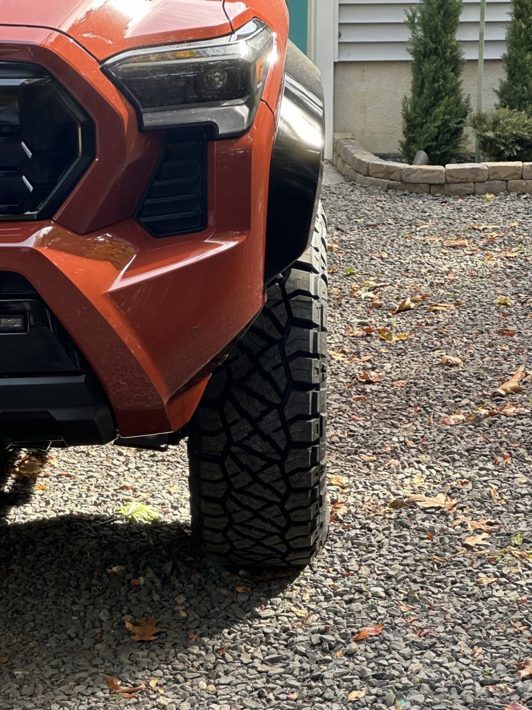

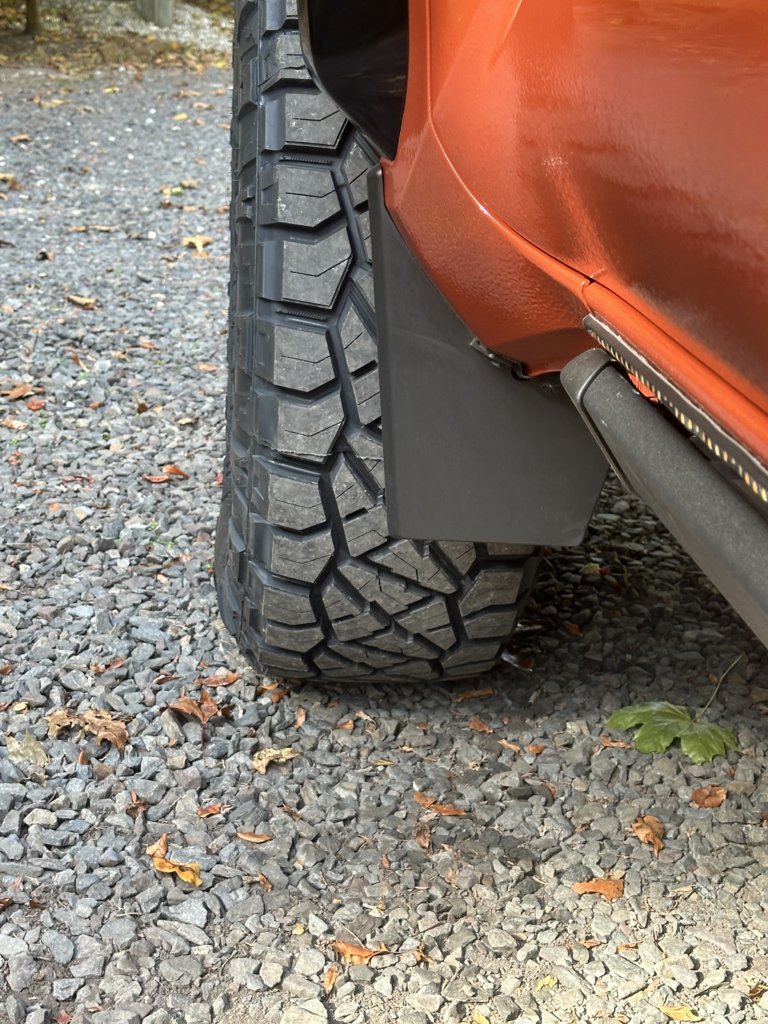

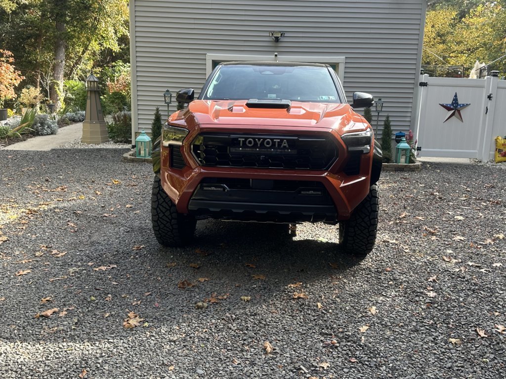

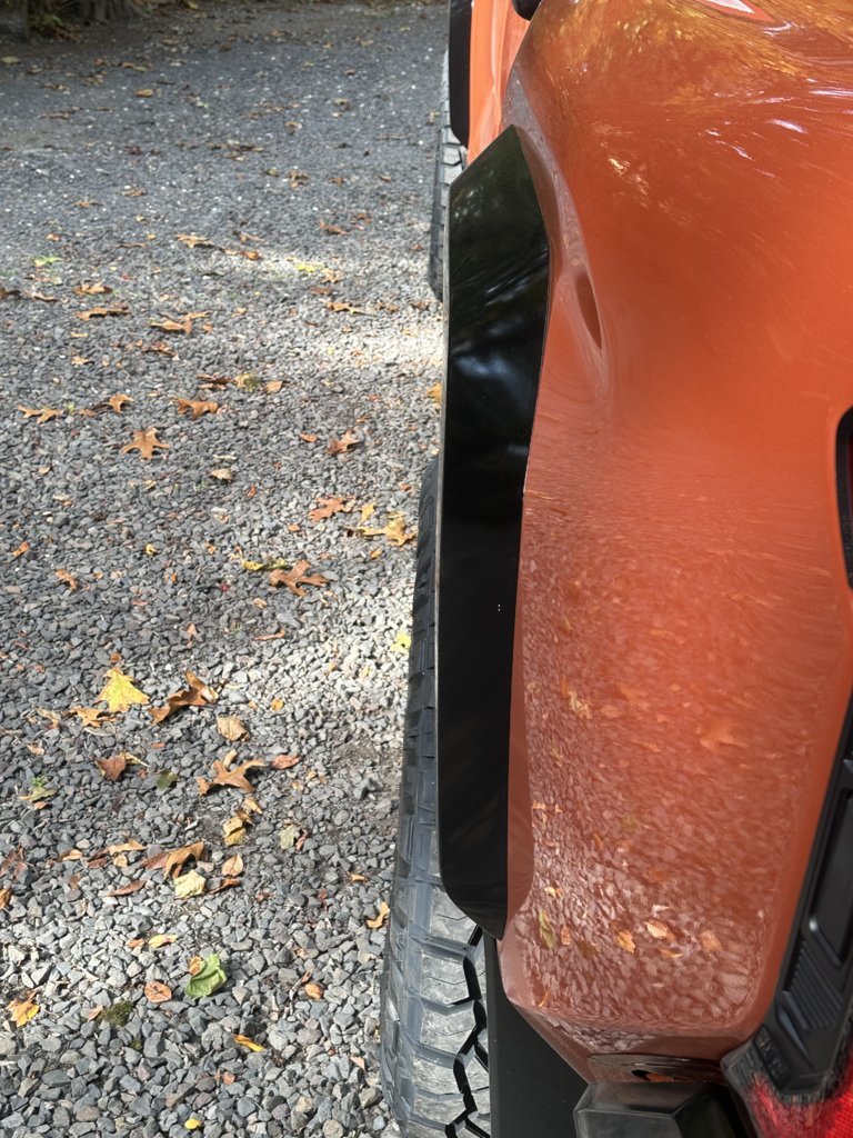

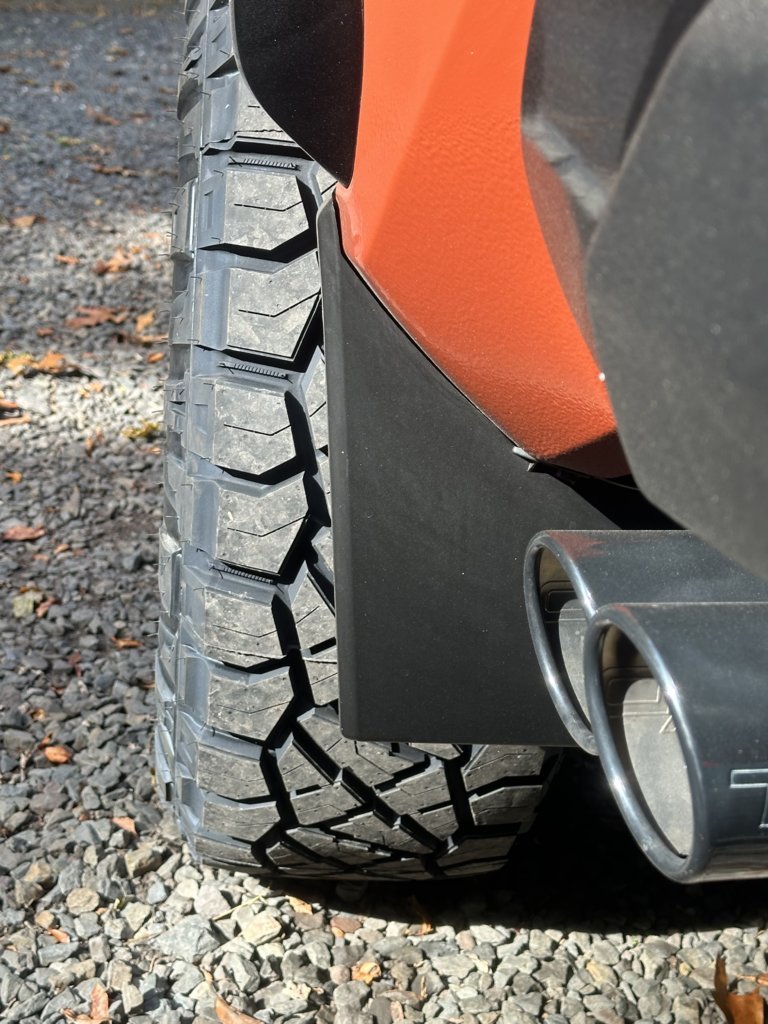

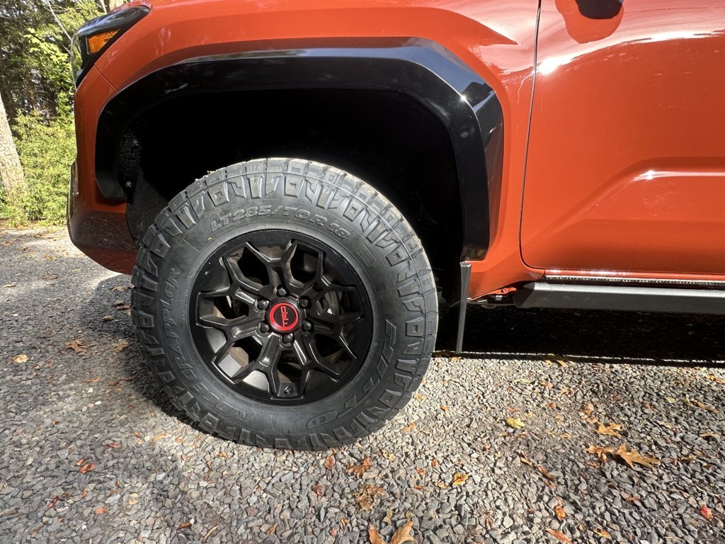

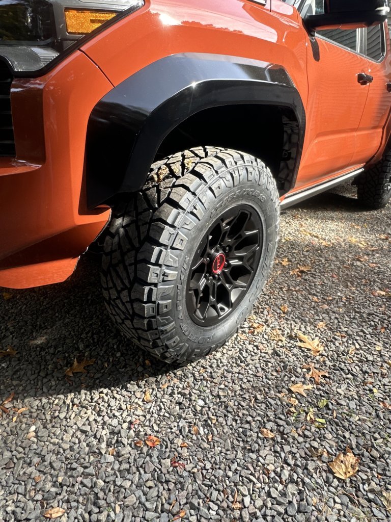

    Today I had my Nitto ridge Grappers 285x70x18 installed. There is no rubbing what so ever. There is still so much clearance the tires look factory. I kept the factory mud flaps on. I will change out flaps in time because they only cover 1/2 the original tire. Now more tire exposed. The didn't modify the mud flap to the extra wide pro fenders and they look crappy.

    Looks great :thumbsup:

    Buddy how is that fitting so well? I saw a 285/70/18 KO3 on a TH and it was a close fit. Same lift as the PRO. Also — I think your tires are indeed a “true 34” versus the KO3’s being 33.7” — confusing! I’m interested in your tires because I think they are only 61lb. How does it drive? Noise level, vibration, power loss, MPG, etc?

    I have only driven it from tire shop to my home 10 miles or so. I Also thought there was a lot of clearance still left after install. I will post more information later about MPG ride comfort. My truck only had 440 miles before putting on other tires. I was getting 20 mpg on stock tires. this was 250 miles doing around 75 to 78 on PA Turnpike . Here is the tire spec from nittotire.com.
    TIRE
    SIZE
    STOCK
    NUMBER
    TREAD
    DEPTH(1/32 in)
    Overall Dia (in)Inflated Dimensions
    Overall Width (in)Inflated Dimensions
    APPROVED RIM
    WIDTH RANGEMin-(Measuring)-Max (in)
    MAXIMUM
    Load (lbs.) @ Press. (PSI)
    WEIGHT
    (lbs)
    LT285/70R18 E 127/124Q 217370 16.4 33.98 11.50 7.5-(8.5)-9.5 3860 @ 80 59.94
