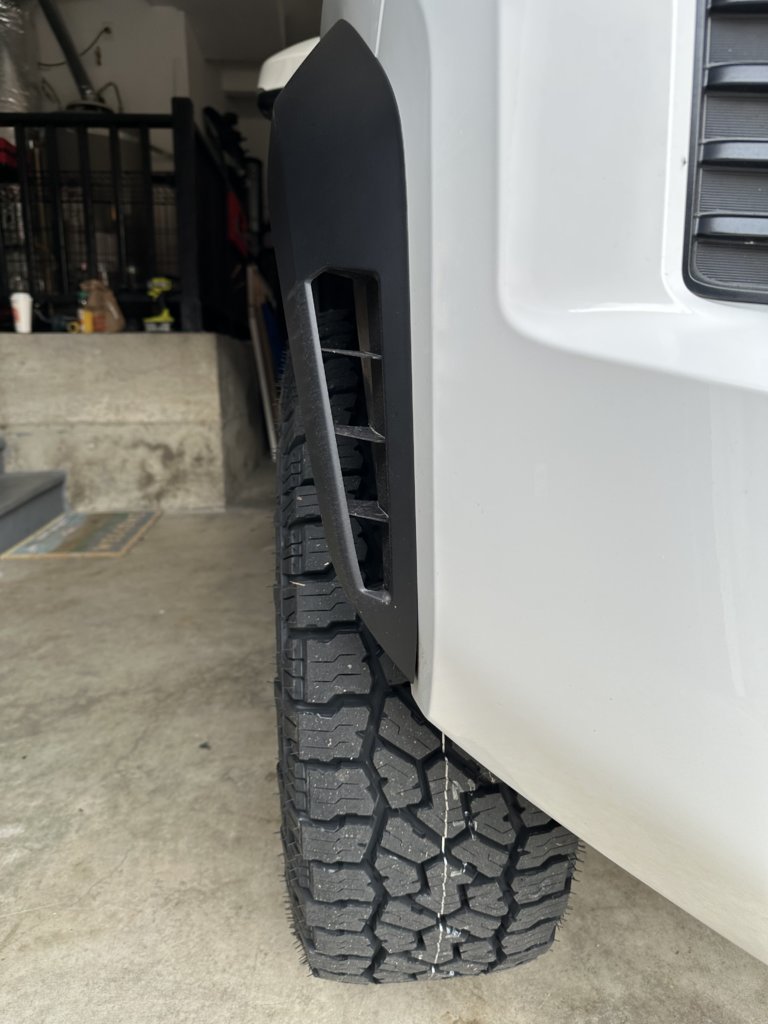

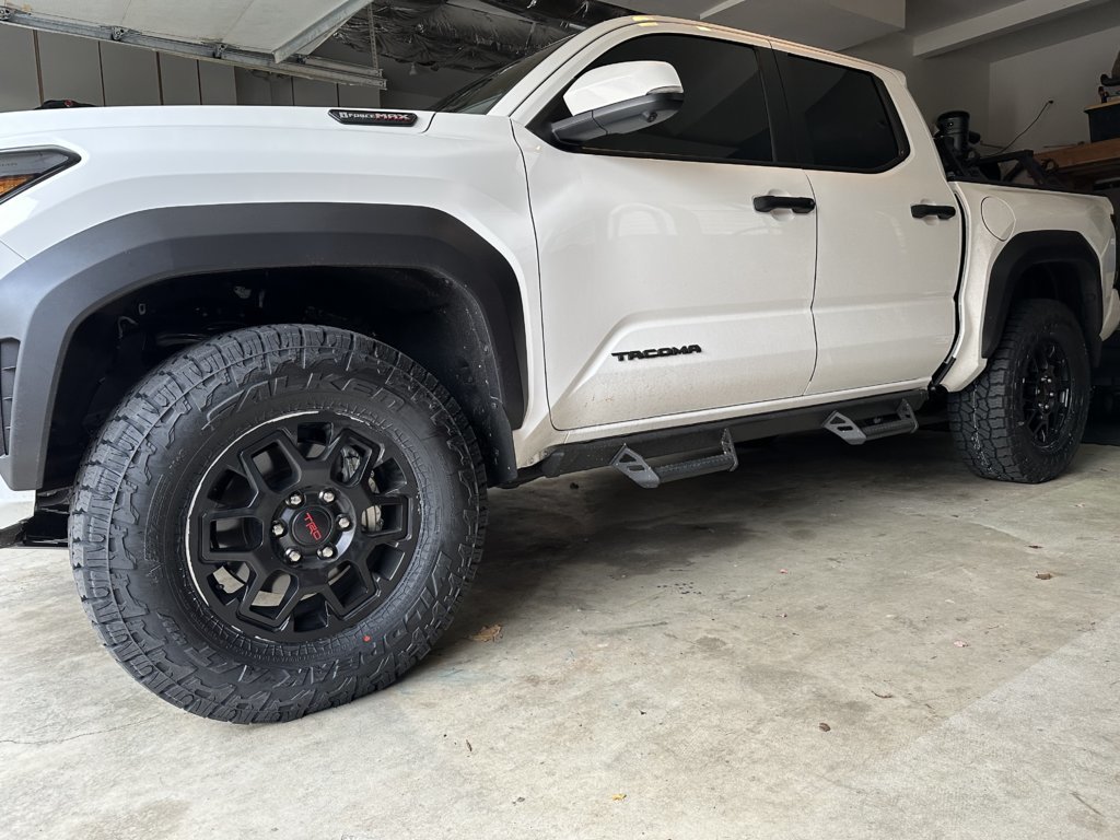

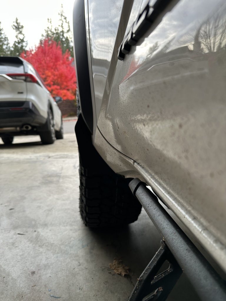

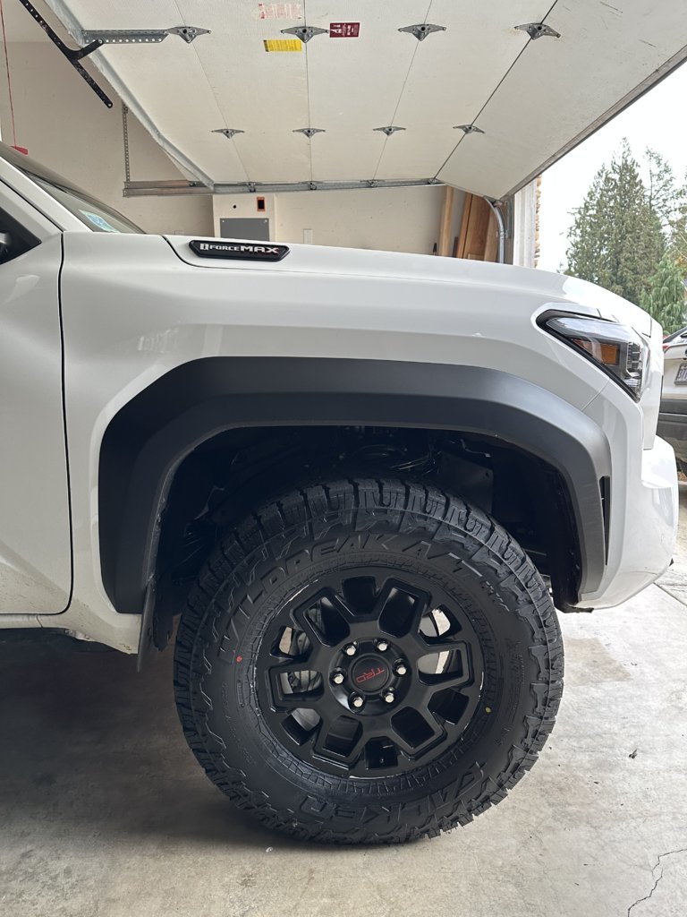

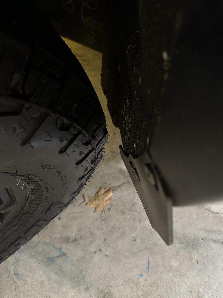

    Just wanted to post to help others still researching. I just had a set of Falken Wildpeak at4w installed. No rubbing so far on full lock or speed bumps.
    24 Tacoma Hybrid Off Road
    285/70-18 Falken Wildpeak C load.
    No lift. No spacers. OEM 18” wheels.
    FYI. For those contemplating about TVD vinyl wheel overlays. They’re a pain in the ass to install and they got shredded on the tire install.

    So confused that some people get rubbing with this size. Did you remove the crash pad? What was impact to ride quality and performance ?

    Crash pad is still in place. It was hard to find people on the internet running this with the 18” OEM off road wheels. One guy on tacoma4g.com with 18” TRD sport wheels said he was getting very little rubbing on the crash pad so he removed it. (I think you were talking to him lol) I’ve never ran tires this close to rubbing so I can’t speak on whether it’ll rub when I get on a trail. I probably won’t be able to get to some trails until next week but I’ll report back then!

    That’s close. How’s the ride and MPG/ acceleration ?

    It’s riding great. I drive mostly on normal and the acceleration doesn’t feel much different. This truck has been great. I’ve had a rooftop tent, 2 big dogs, and camping equipment in the bed and it hasn’t felt bogged down one bit.

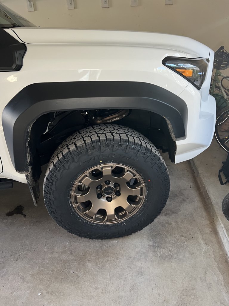

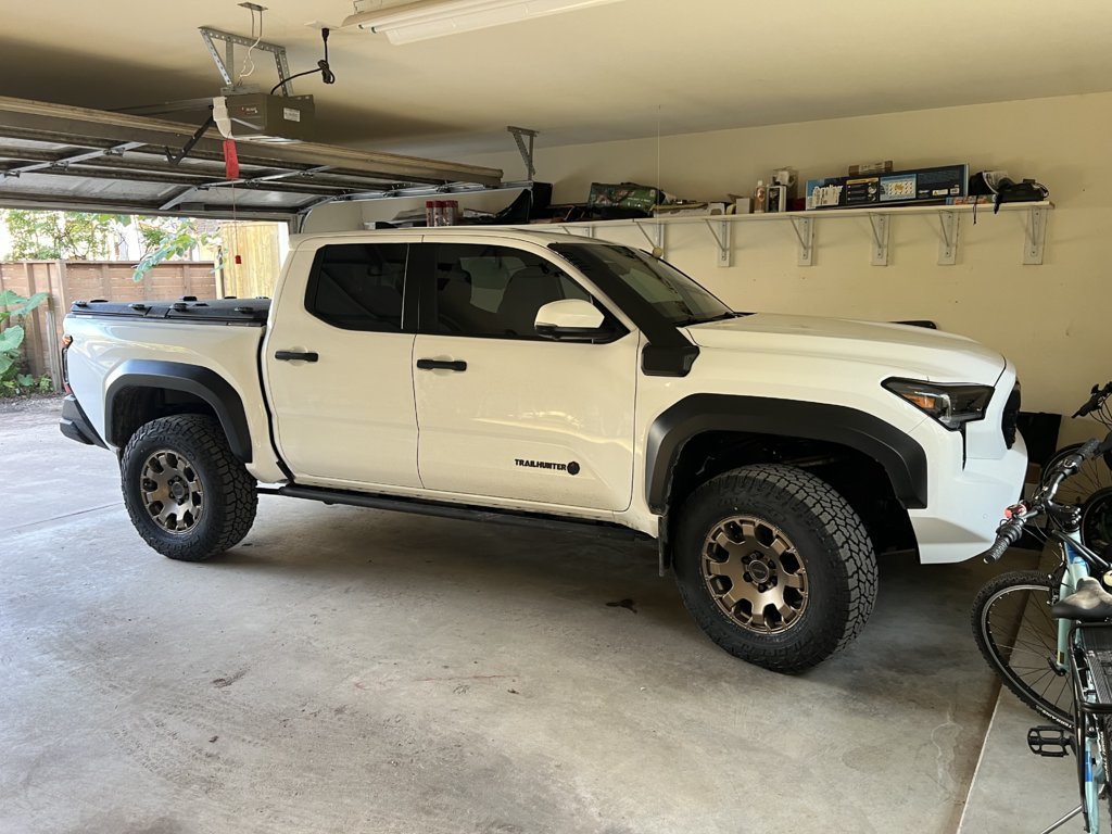

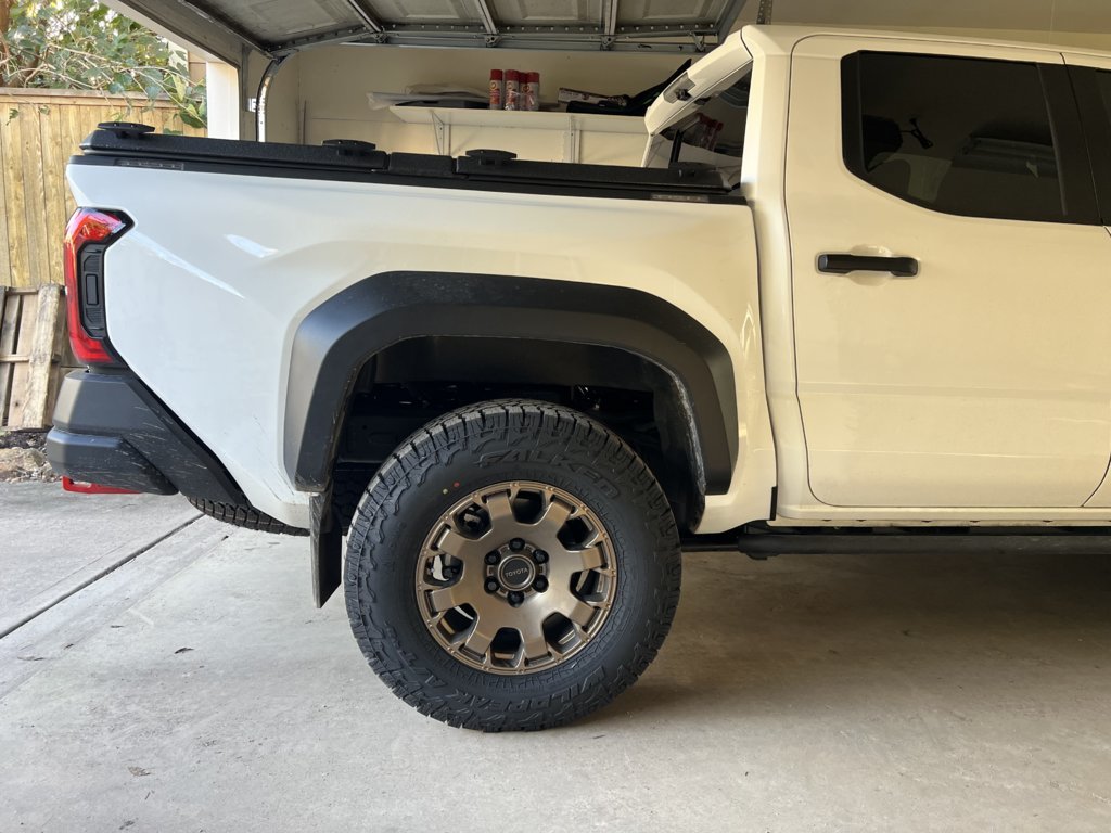

    Went with Falken AT4W in 275/70/18. Plenty big for me. I like it. Seems right at the limit.

    It looks really beefy in person. It does not look small.

    It was 265/70/18 on the most feeble Wrangler OEM tires ever made. I think they are made of cardboard and black paint.
    My size went up by 0.8" -- these tires are 33.4" and the old ones were 32.6". And it checks out. I did a bunch of measurements and the truck got about a 0.4" lift all around.
    The biggest thing is that these tires are very high quality. It's immediately apparent from how they look and feel and the drive is so smooth and planted. There is absolutely no comparison whatsoever. Falken makes a good product.
    The tires took about 1.5 ounces each to balance? Not sure if that's good or bad. Just FYI.
