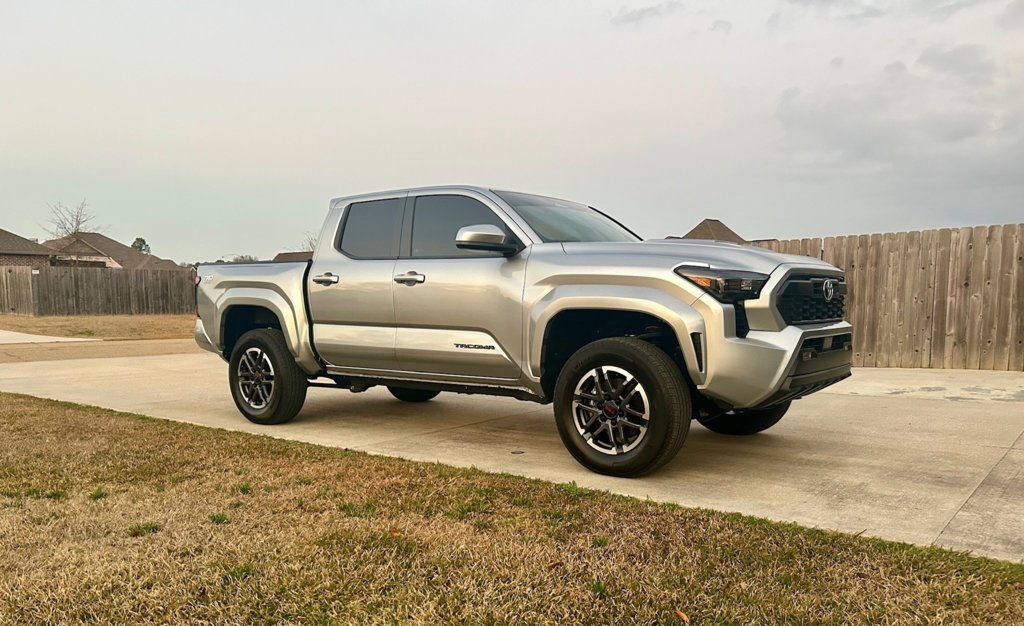

    Howdy! Anyone recently add 285/70r18 to their sport? Having the 1.5 level installed today, I do have the 265/65r18 upgraded RT tires but wanting to go 34"s in the near future.

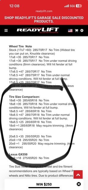

    I am curious on the same. I have 2024 TRD Sport with 1.5" ReadyLift Leveling Kit installed. Factory wheel reset, with 265/65r18's stock. I am looking to get 285/70/18 Nitto Ridge Grapplers.
    Added ReadyLift tire size comparison sheet I have been reviewing. Any feedback is greatly appreciated. Thank you

    Update. I found a good deal on a set of Cooper Rugged Trek 275/70 R 18’s measuring 33.66. Fits well, no rub. The 285’s will be close depending on exact dimensions. Should fit, but may rub on hard turns.

    It all depends on wheel offset. Your factory +55 stock offset is very conservative stance vs my 0 offset which is very aggressive stance.
