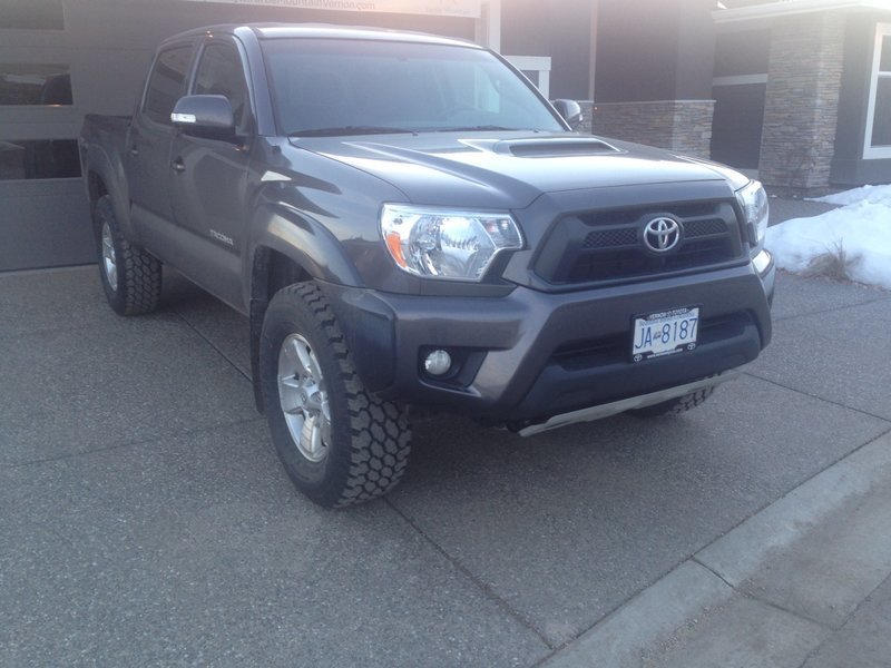

    I'm no pro here, so maybe the others can correct me if I'm wrong. But wheel spacers make no sense if you are hitting the body. Your problem looks to be solved by removing wheel spacers. Offset and spacers = body contact if my math is correct. That said, if you hit the UCA you will need to increase the offset, so its a balance.
    A lift will have nothing to do with UCA contact or not, if my math is correct. Again, a pro could correct me. Pics coming.

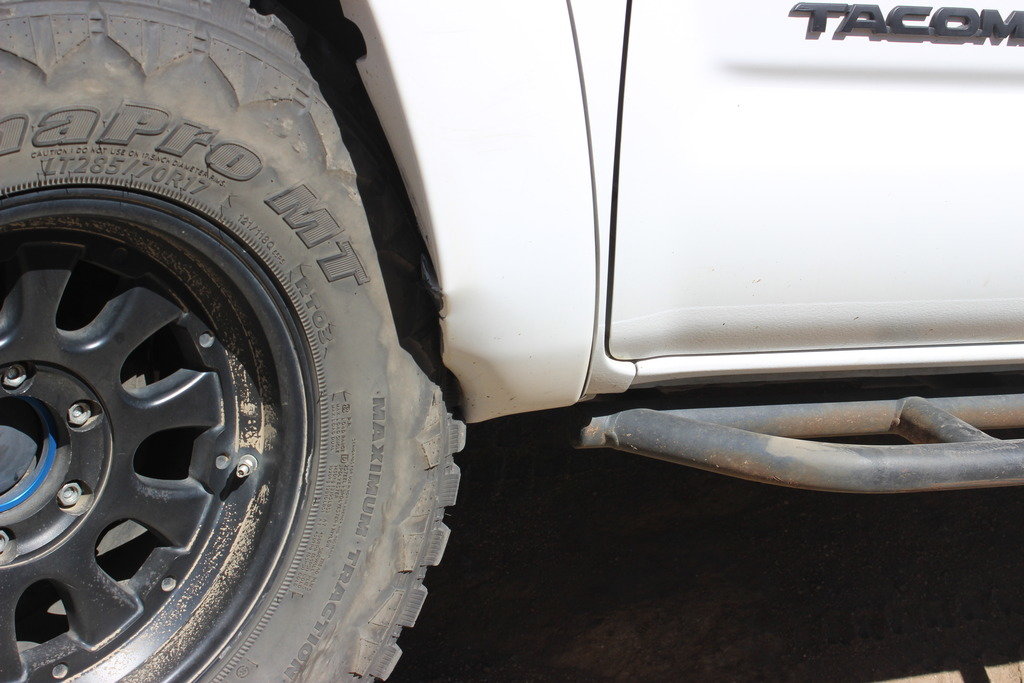

    With the lift and spacers I didn't rub till I went offroad. Photo was a long time ago. Now I have a 35s without spacers.

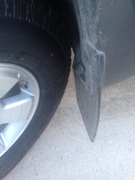

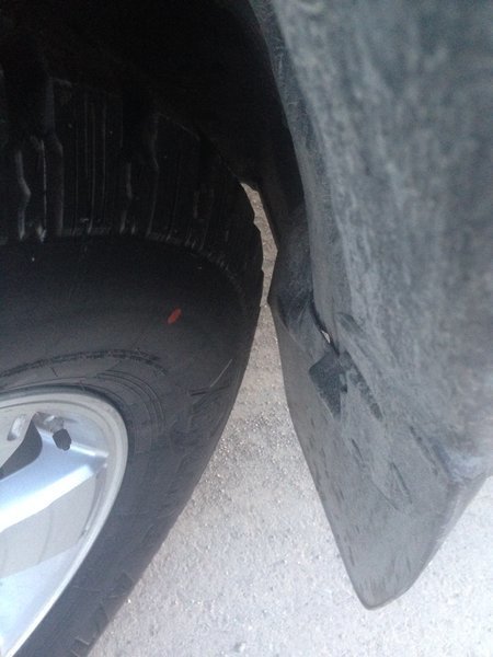

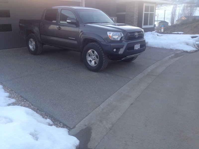

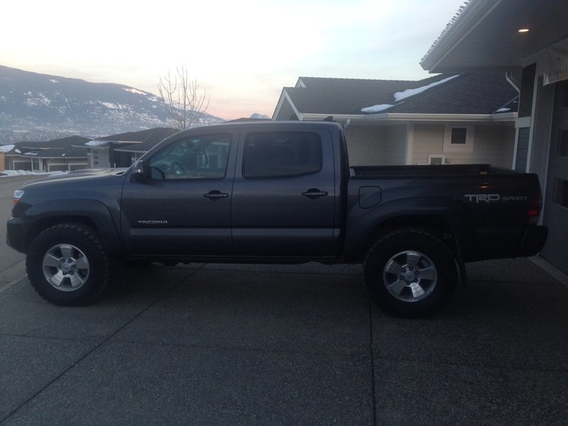

    Here are pics at full lock and from the side as requested.

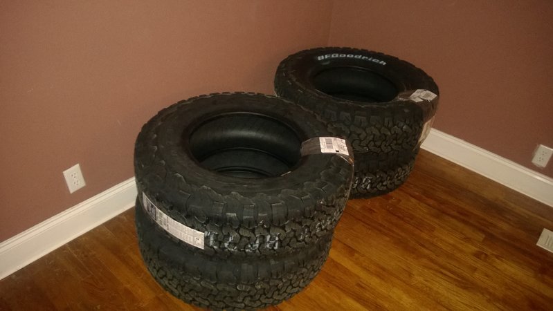

    17x9" scs br6 -38 offset wheels. Bilstein coilover suspension. Viper cut and cmc in front. Add a leaf 2" lifted in rear.
    I with you bud. I just got my 285/70r17s bf goody ko2's for my 2015 Trd sport (not yet installed) but it looks like they will fit just fine.WP_20160401_009.jpg I will post pics soon. #we will show em.

    No lift, bone stock.
    When I do mild wheeling I rubbed so I removed the flaps on the front (not the little venting ones) and haven't rubbed since. When I look at the UCA I can see where I think the tire is just barely touching at full lock... I can get a piece of paper in there when testing it but something about driving must be making it touch the UCA sometimes. That's the update. :)
