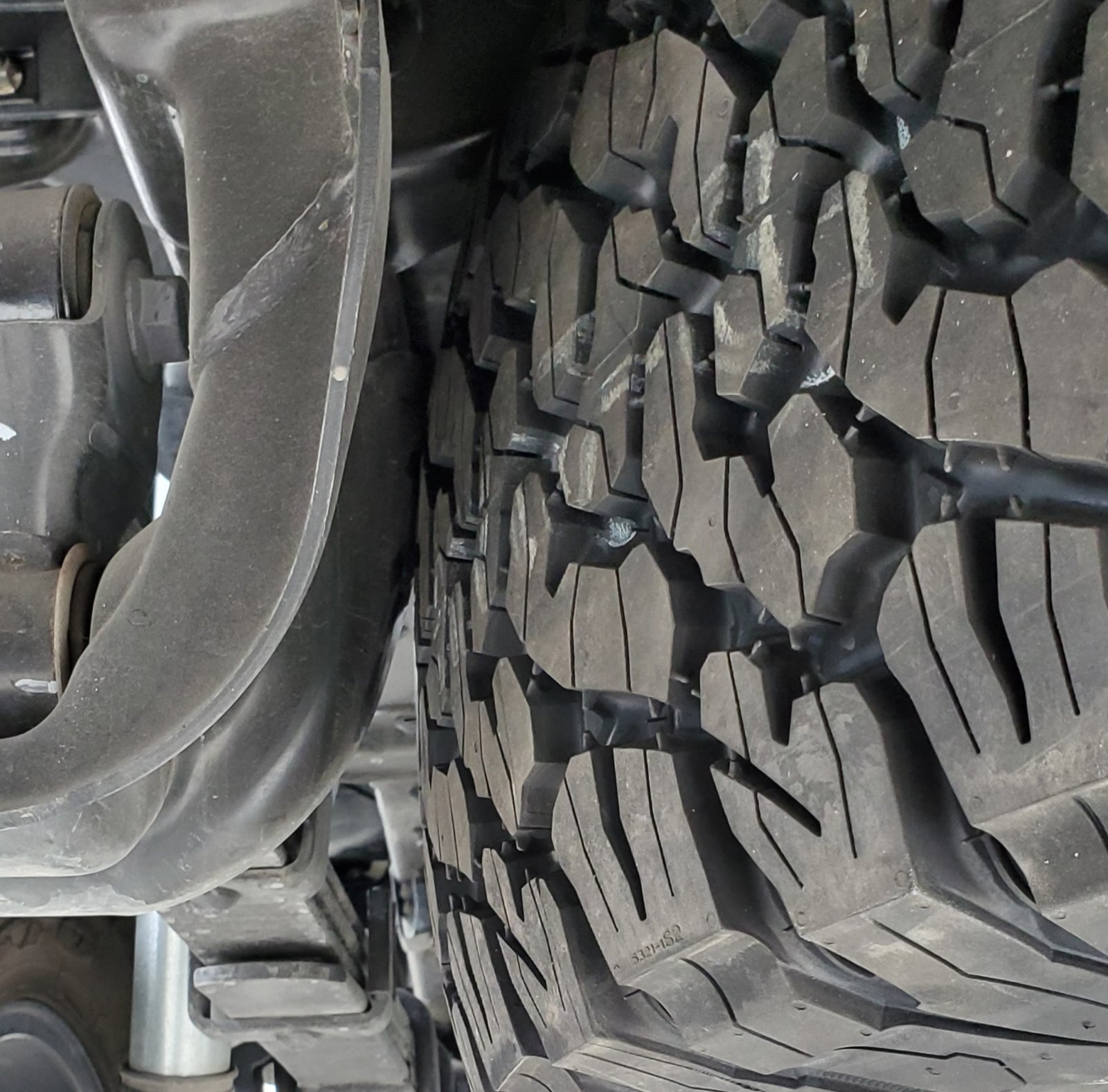

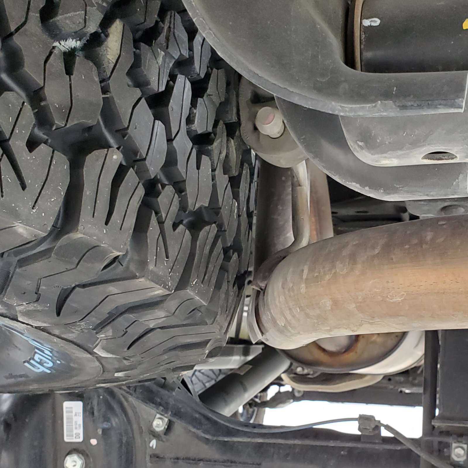

    Do you or does anyone here have any criticisms to the following pics? I did zero modifications underneath the bed. All I did was tug on the 33in BF Goodrich spare (as shown in the pics) towards the rear while I cranked it upward with the other hand. Because of the forward prongs/tongues that used to hold the stock spare in place, this 33 in. spare is angled forward (front portion of spare is drooping downward while rear is flush upward). However, as shown, the right side isn't touching the exhaust pipe and is held in place by the exhaust hanger. The left side is held in place by what I guess is called the leaf suspension bracket. The tire isnt forcefully pushing onto the bracket nor the exhaust pipe hanger, but again, it's snuggly in place which prevents any movement while the truck is in motion.
    Feedback (good/bad) is appreciated, thanks. 20231125_135022.jpg 20231125_134918.jpg 20231125_135040.jpg

    I did the same to fit the 255/85/16 up there, but also bashed the prongs mostly out of the way. It’s also a 33” and is just as close with no issues.
    Later on I redrilled the hanger mount and set it back a bit more so itd be easier and also chopped the exhaust.
    Looking to get a high clearance rear bumper soon.

    I've read about re-drilling. I'm worried that if I do that, it will create rust in the new holes. There's also a YouTube video where this dude got a blow torch and lit up those prongs/tongues. When they got hot enough, he got a mallet and hammered them forward about an inch or so. That did the trick as a 33in tire fit easily. I don't feel like spending money on a blow torch and mallet. I think my current situation will suffice.

    You don’t need a torch, they’re stamped metal and kind of weak….I think I even used a rubber mallet.
    Spray paint anything you cut, drill or scratch and you’re fine.

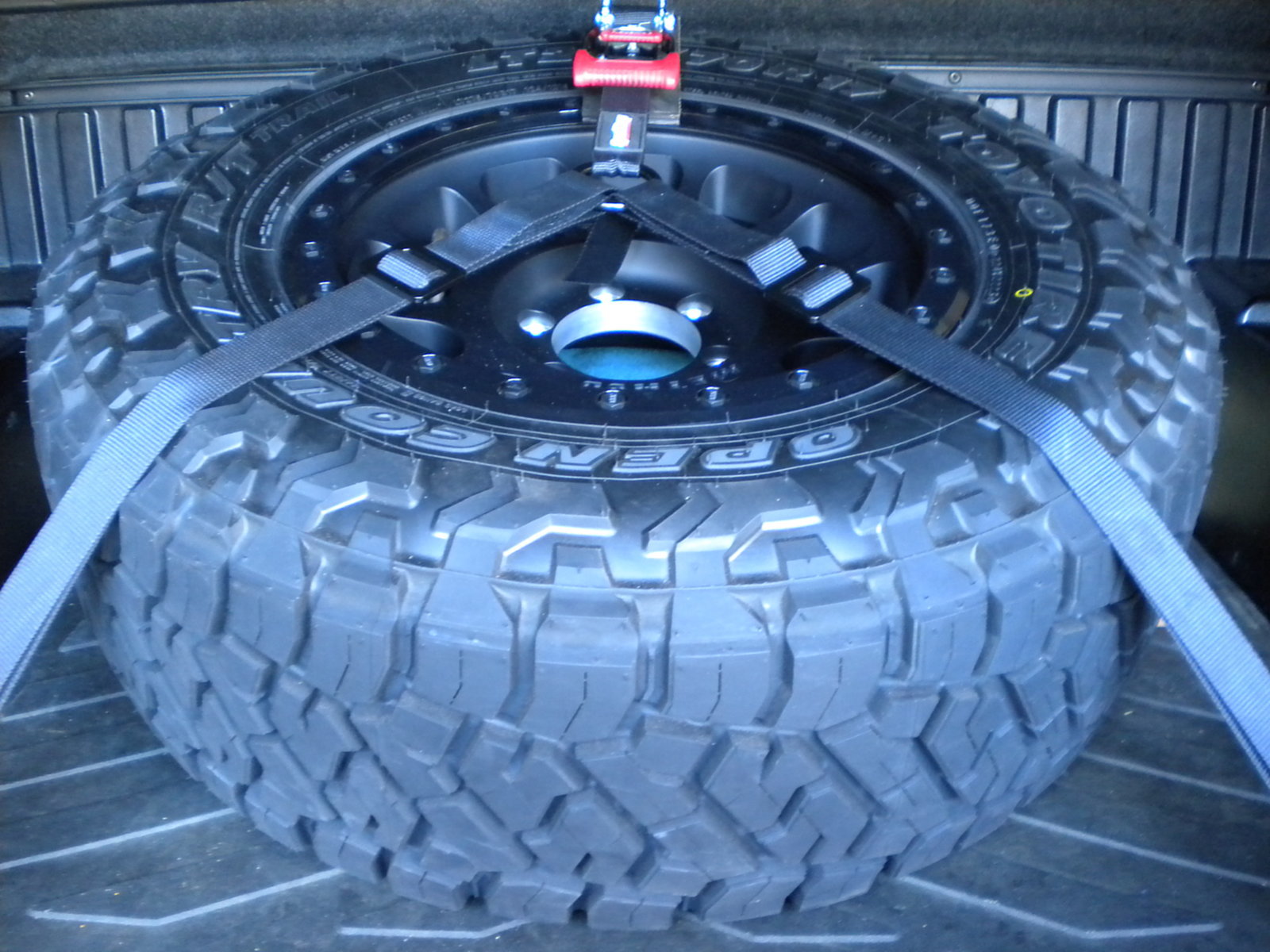

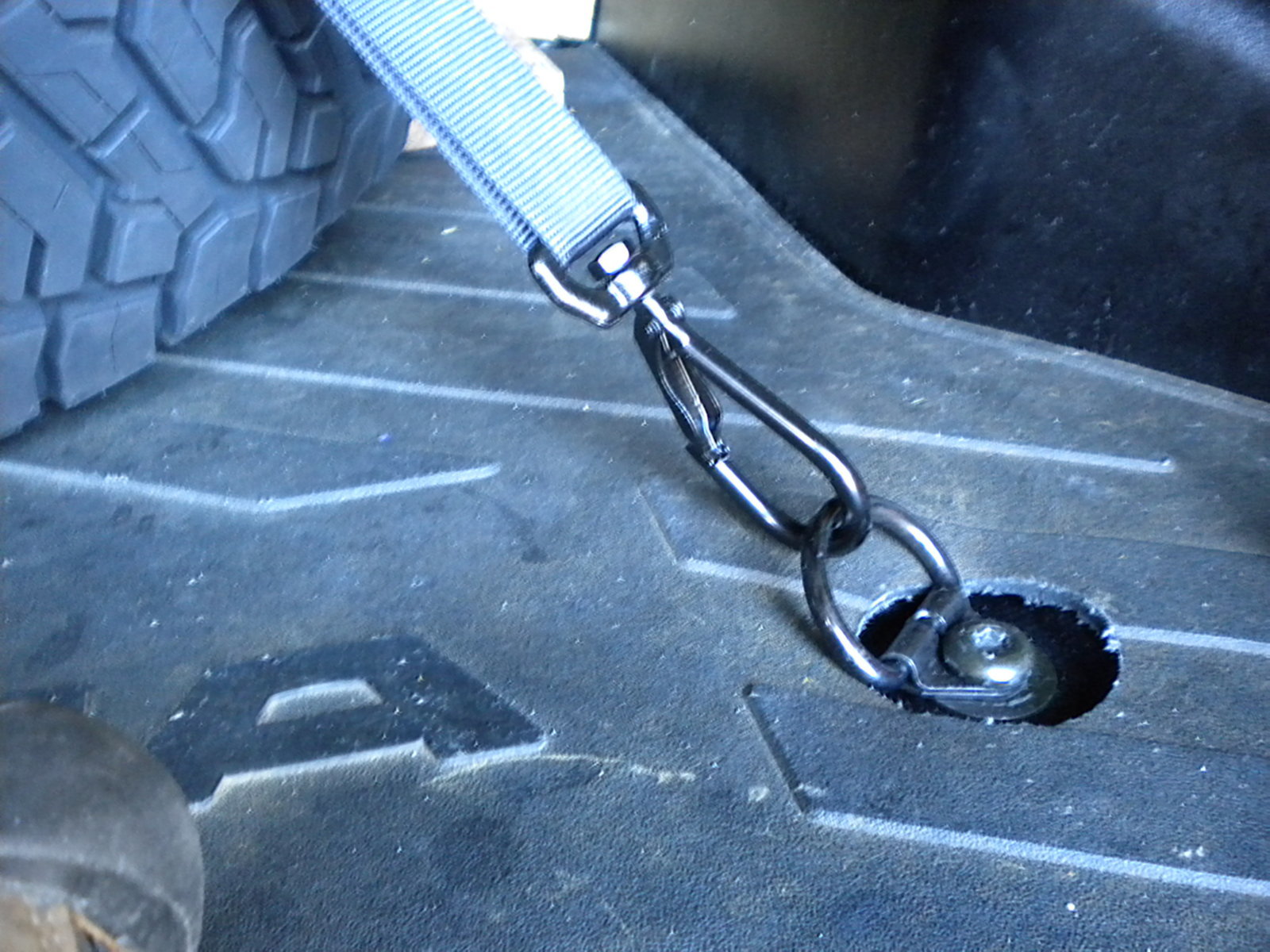

    added a few d rings and store it under the canopy....

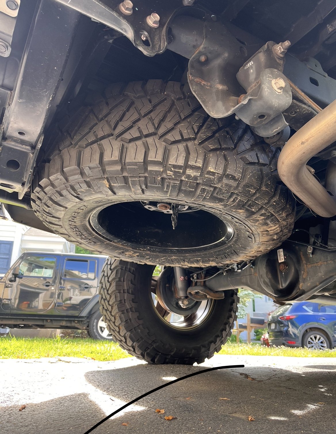

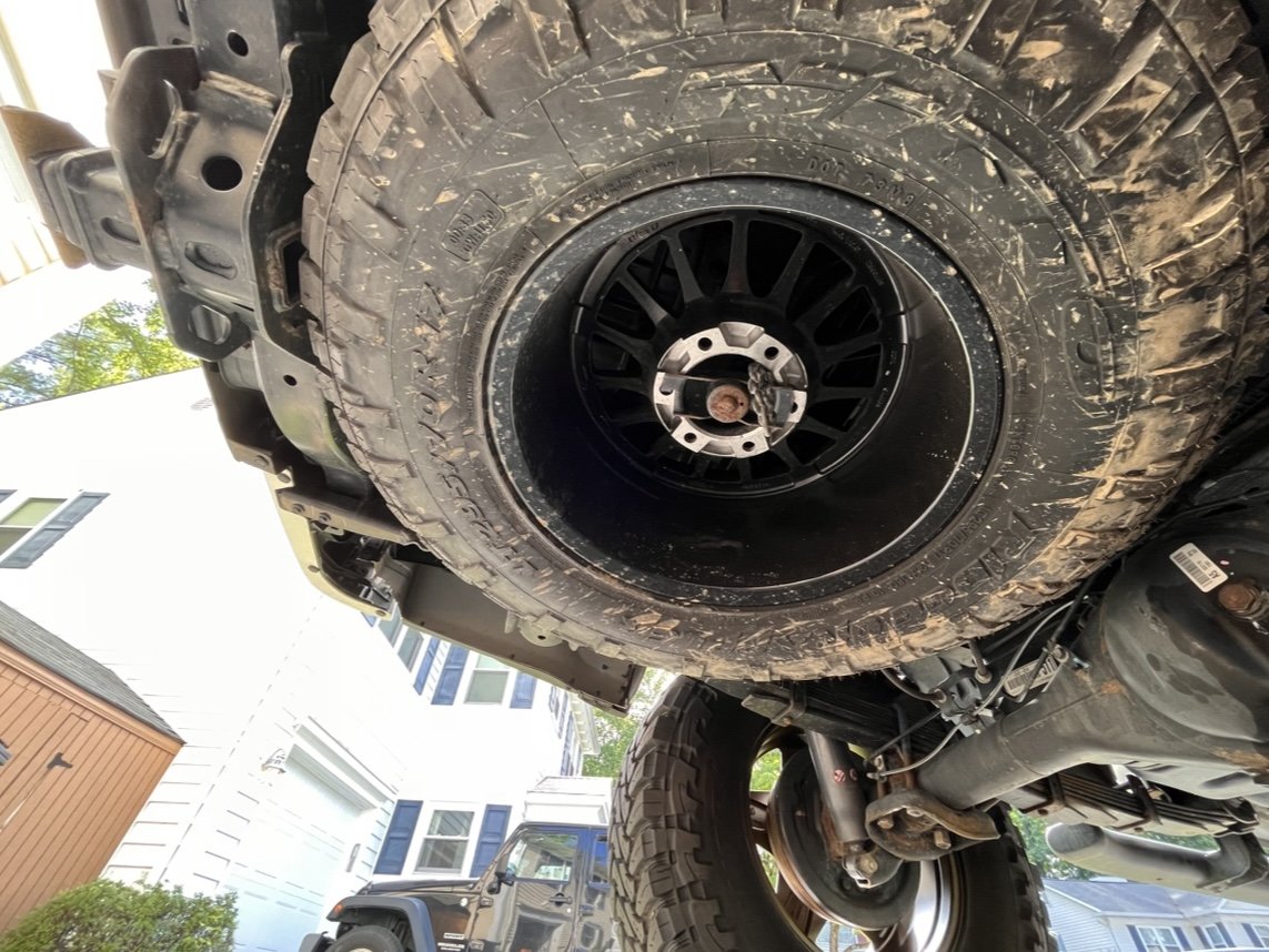

    I had 295/70/17 underneath before this current setup. Did not deflate and had my wife helped me whined it back up. Nitto ridge grab.

    In my case no. Remember, the truck doesnt idle forever. I saw others had to modified the brackets but like said, I didn’t want to do all that.
    Almost 2 yrs underneath no problem. At that time, I didn’t want my bed to turn into a spare bed. The tire carrier option was overkill for me since the longbed was already extra long to park lol!
