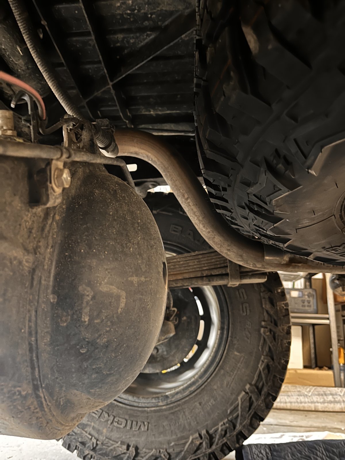

    My tire is about 1/4” away from the exhaust, had it like that for about 2 years. No heat shield (Borla exhaust).
    Only issue was when I was driving for hours on FSRs and the tire shifted closer to exhaust and got a very minor mark from the exhaust. I re-tightened the spare and it has been fine ever since.

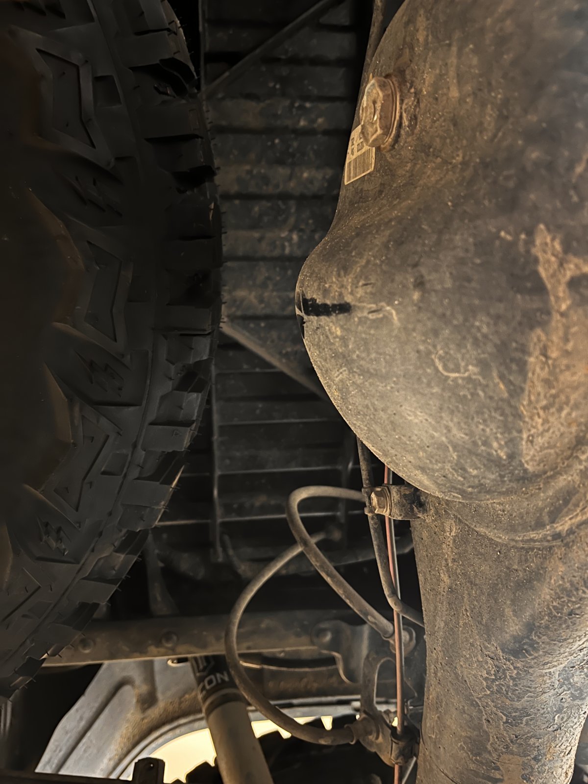

    You can fit a 285, 255 or whatever tire you purchase…will it clear the rear axle pumpkin though? If you’re stuffing it, check that clearance. A misplaced/oversized spare can cause some serious issues(physically limiting axle movement due to size/obstruction). Adjusting the spare tire mount(winch system) aft 1” will fix the axle impediments issue(285 largest I’ve tested). The composite bed will not accept vertical impacts without cracking, think axle impact spare, spare has no where to flex/go besides vertically into the composite bed.

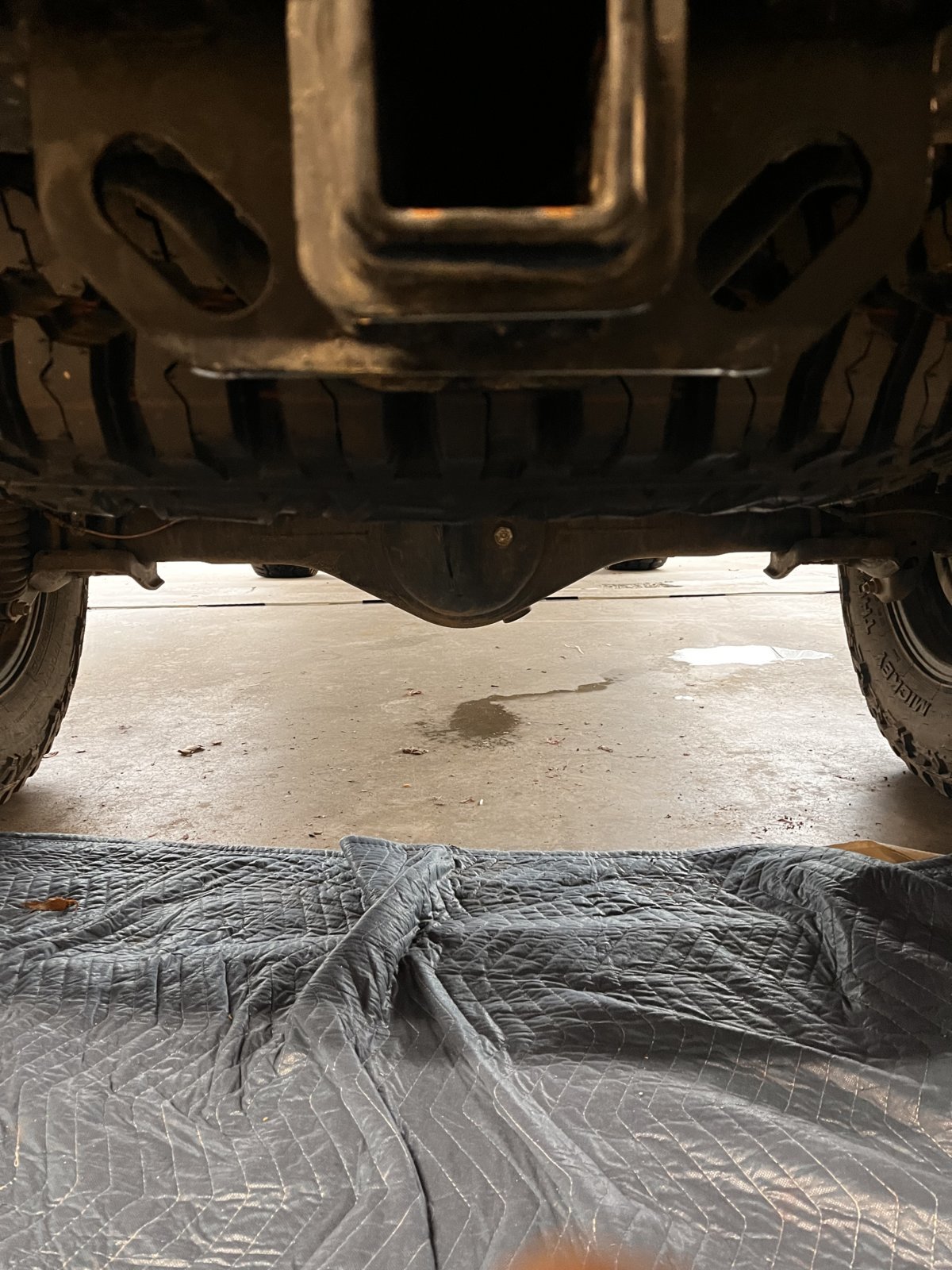

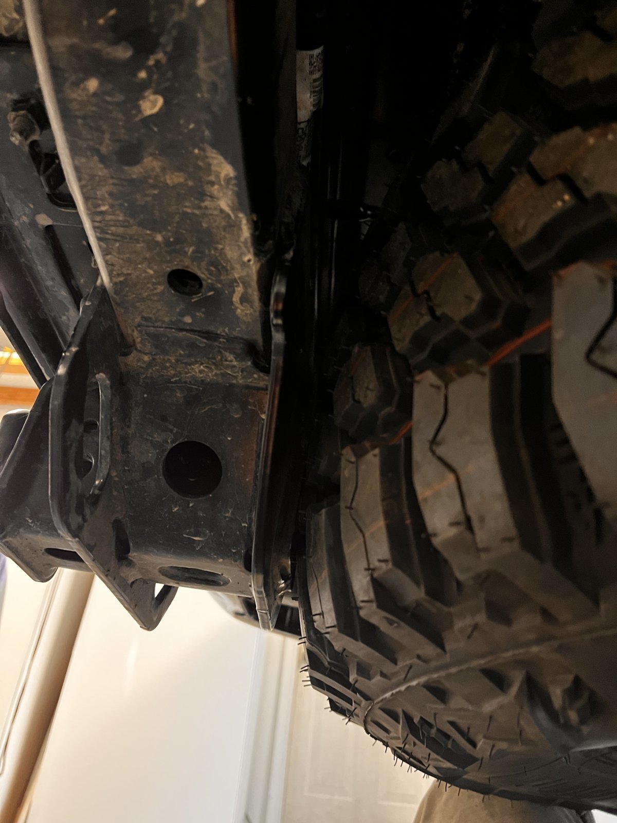

    Finally got around to doing this. Relocated the hoist and pounded on the tabs a little. 295/70r17 fits with air.

    looks like it’s almost riding on the exhaust… are you cooking the tire? I want to put a 285/17 there.. but worry about destroying it.

    This has come up a lot when this is discussed and while it is pretty close to the exhaust, it isn’t an issue IMO. I haven’t had a problem, but I do a 5 tire rotation. If something does happen to the spare being that close after more than 5k miles no one has shared the experience here yet.
    The heat that far back on the tailpipe isn’t enough to damage a tire, but that hasn’t stopped people from adding heat shields to put their concerns to rest
