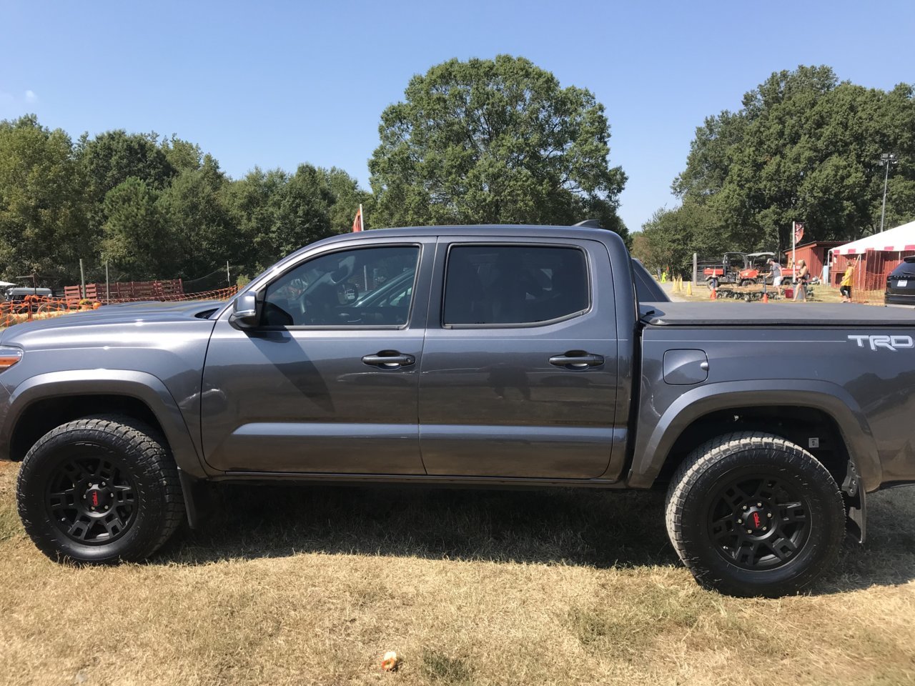

    Thanks for all the input! I’ll probably just stay with 265/70, just too many negatives for what I use my truck for on a daily basis. Also, I’m really surprised how level it sits from the factory. After measuring, mine is about a half inch lower in the front. F243055B-22ED-4ED2-816B-A5E31A6EF2CA.jpg Here’s a current pick.

  16. Oct 22, 2020 at 4:53 AM

    Ron
    DFW Texas
    2018 Inferno Tacoma TRD OR DCSB
    One Mod after another
    You will loose power, you will loose gas mileage, Your needle bearings will wear faster. I lifted my truck 2 1/2 inches and did the CMC. Truck looks great IMHO. Be sure and get get C class tires. I went with 285/70/17 KO2. And yes they are noisier. All of the above.
    The facts are black and white. It's your choice. I didn't change gearing but I did get OVTunes which does help some.
  17. Oct 22, 2020 at 5:00 AM
    #17
    MGMSteelCurtain
    MGMSteelCurtain [OP] Active Member
    Jul 10, 2020
    #334018
    34
    2018 TRD Sport MT DCSB
    Looks great! Did you do the install?
