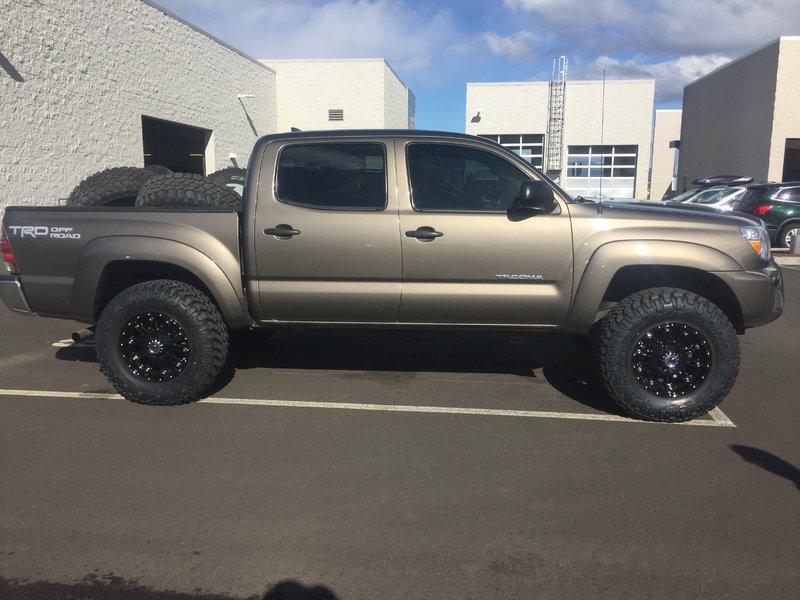

    I think I replied a different way forst lol Sorry never done it. There wasn't much of a downfall. Just had to do a little bit of trimming to the flares and liners. But I need to trim the cab mount I think. At full left turn you can't even fit a finger between the tire and cab mount.

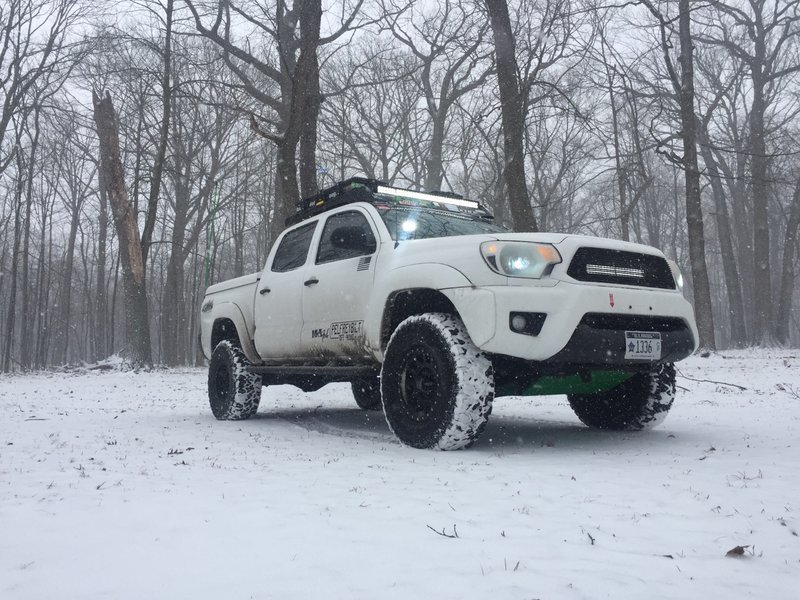

    Just a grocery getter
    285/75/16
    I trimmed interior plastic out. Did a cab mount chop and beat in the pinch weld. No rubbing even at full lock
