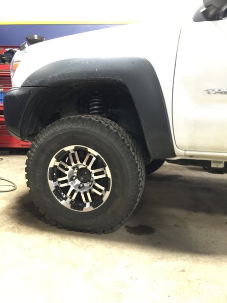

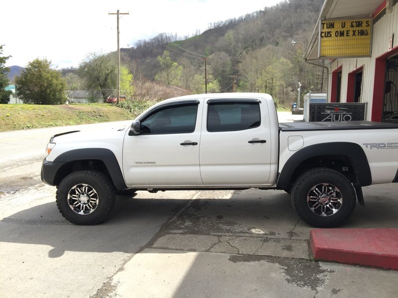

    Well here it is with the new wheels and the 265/75r16 hopefully will have the lift on in the next week or so. ImageUploadedByTapatalk1458357506.066668.jpg

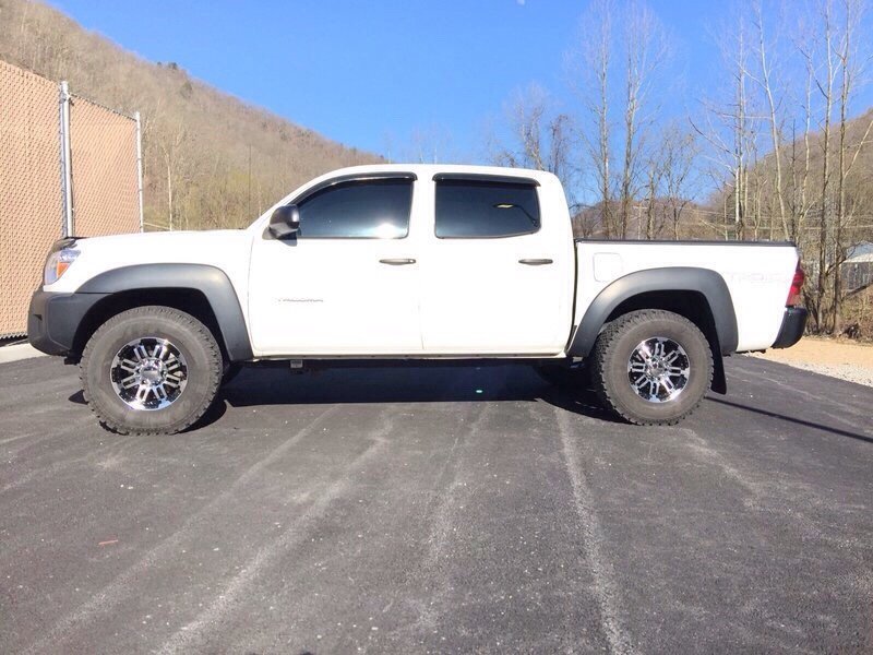

    New pics with the lift installed.

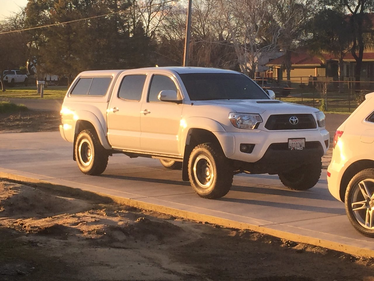

    886/5100s/AAL/UCAs/360 armor/RTT/295 17s
    I have been to quite a few places with my 265s and i havent had any issues wheeling with them yet. Or at least not any issues that i thought 285s would have solved. Also depends on where you live and what you wheel. Wider tires are nice for the mud. With these LT trucks i have heard lots of people swear by 255s for wheeling/driving combo.
    You can also always air down a bit if you need the extra footprint width.
    You can see from the photo below that i was really only having traction in 1 area of my front passenger tire. I dont think that a wider tire would have helped much.
    Personally i think its more about preference than anything.
