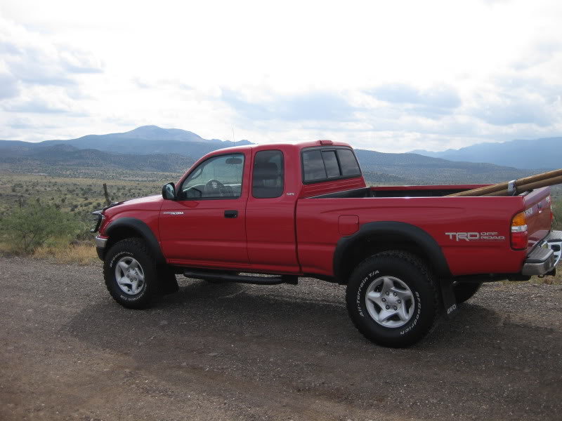

    Here is my old setup. 285/70/17. Bilsteins were set at 2.5" with a 1.5" AAL. They didn't rub much after I trimmed but near the end they were rubbing a lot. I switched back to 265 ATs.

    DAMN that is one clean nice looking truck! :thumbsup:

    Thanks. As much as I loved the way it looked, I ended up hating my Mud Terrains. I hated the sound of the rubbing and just got a headache from the constant noise of the tires.

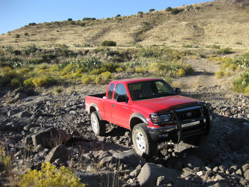

    Here was mine with 285's.....at the time had 2.75" front lift with 2" AAL out back. No rubbing except at full lock on frame. Not bad rubbing tho. My CV's weren't gonna last long though with that much lift.

    No trimming...only rubbed on the frame and only at full wheel lock. But, glad I went to 265's for my purposes...but I will admit I kinda miss the look.:D
