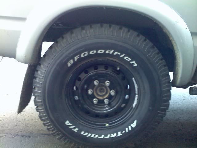

    just installed mine. 3" lift, 1.25" spidertrax wheels spacers, 285/75/16 duratracs. i just hammered the pinch weld a little bit and im good

    Thanks for all your help, I'll post pictures when I get them on. I hope it turns out as good as goldie's. Looks so good.
