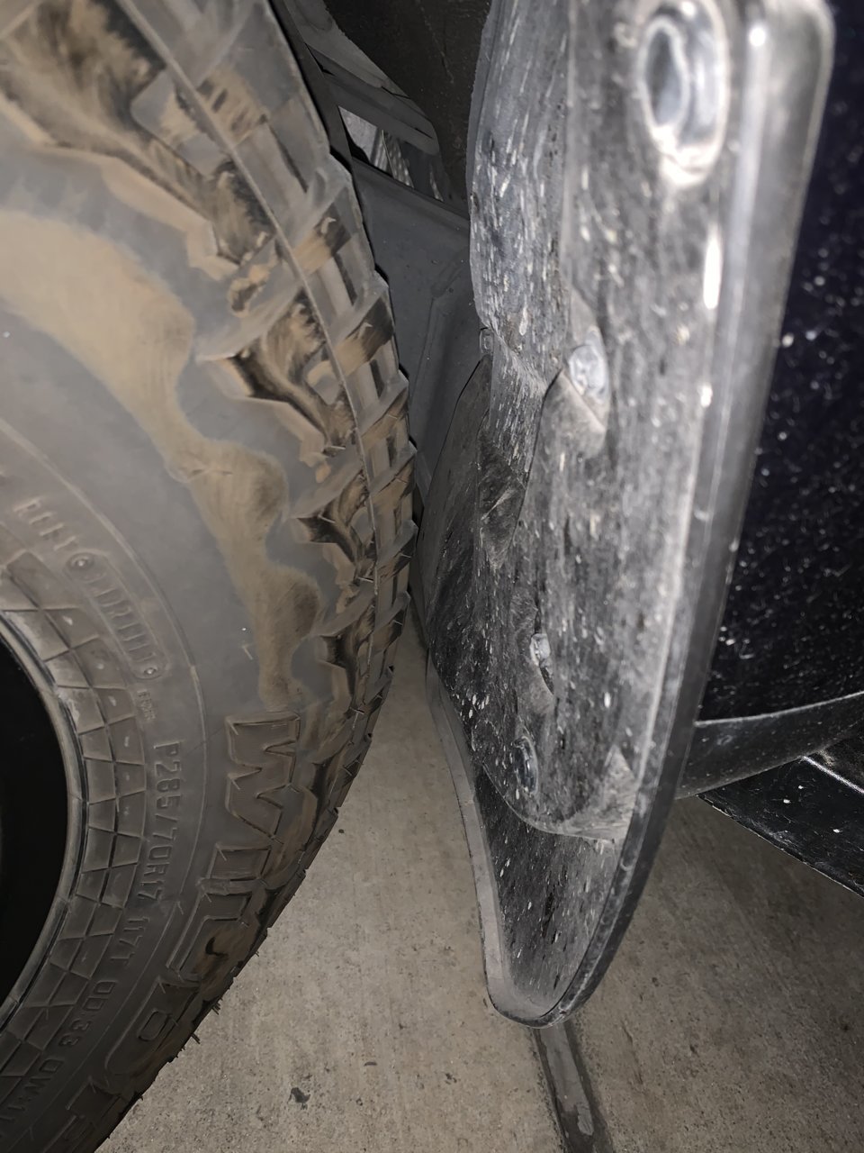

    the fender wells might be slightly different but cab mount should not differ much. Not that I noticed anyway.

    Here is a shitty pic of the wheel (285/70/17 on 17x8.5” -10 SCS stealth 6) at full lock. About 3/5ths of An inch away from the mud flap which also covers some of the cab mount.
    no rubbing at all on that portion. Only rubbing happens at the front of the wheel well (which has already been trimmed). This was thanks to the alignment which pushed the caster forward (as much as possible) on a 2” bilstein lift.

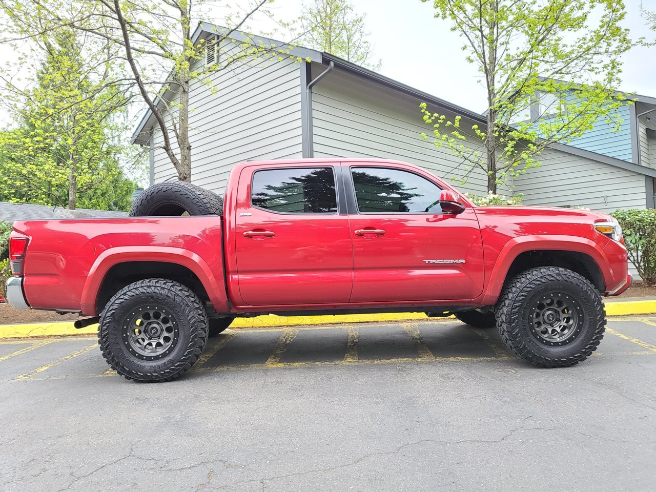

    Maybe it’s the angle or lack of lift, but those tires look too big to me. Could just be the pic?

    Too big is just the right size lol

    Factory to 2in lift and 33s, looks like a totally dif truck. IMG_20200501_210307.jpg
