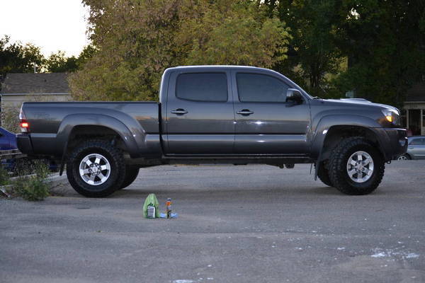

    i have 285/75/16 goodyear duratracs on mine. i put the 5100's in the front at 2.5 and 1.5 aal in the rear. No spacers or anything else. theres slight rubbing but not too bad. I should put in spacers but you can get away with out if you don't mind rubbing a bit when fully turned.

    thanks for the pic.. looks good. maybe ill do the 265/75s for now and plan on lift and tires over the summer.

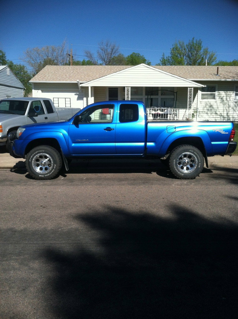

    You will need to trim the wheel wells because the will rub but they will fit. I have stock 265's on my truck with the 5100's all the way around and the add a leaf in the back due to the TSB. My next set of tires I will bump up to the 285's so you should be okay. Here is a side view of my truck with the 5100's on their highest setting with my 265's.
