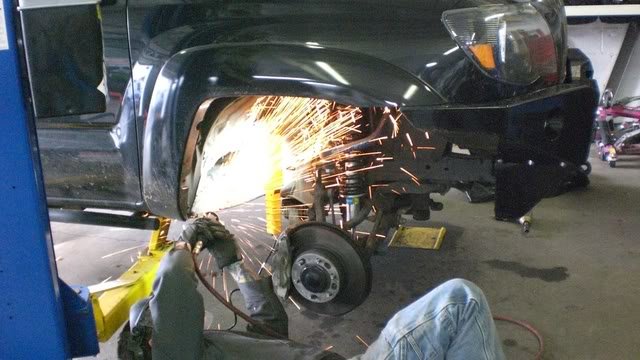

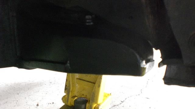

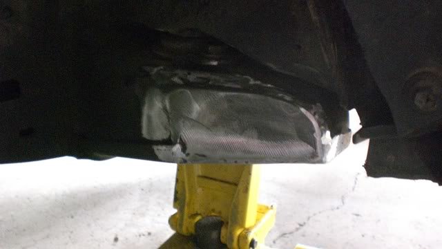

    you mean on the cab mounts? yeah, mine did too- i cut em and plated em.

    It rubs the body mounts while flexing the suspension right where 6shooter has his chopped, I also trimmed the fenderwells and fender flare a little. sorry dont have pics. Longbow has good pics of the fenderwell trimming in his galley that looks just like mine does. It all depends though, just drive a little, trim a little and repeat untill funderwell rub is gone.

    Shooter, do you have a shot from the bottom to see how much you chopped off?
