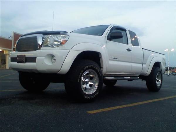

    I have 265/75/16 on mine. Not the best picture...but you can get an idea of what they look like...
