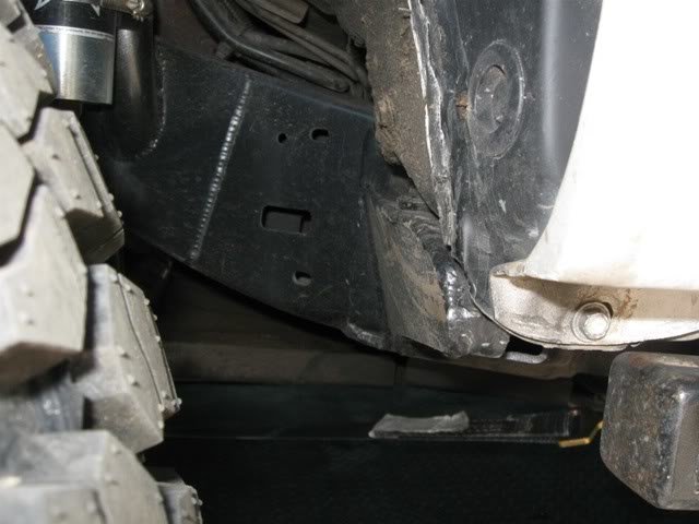

    DUDE! You really did need new tires! :D
    And get those body mounts trimmed.

    Depends on your fabricator. It's easy but time consuming. Torch-cut the stock stuff, spend 2 hours grinding to get everything smooth on the same plane, mark the reinforcement plates, cut along the marks, test fit, cut, test fit, cut, grind for a perfect fit, weld.

    By the way, they don't rub at all on the backside of the fender. :confused:
    The front rubbed like crazy though. Albert did a FANTASTIC job cutting, but I still rubbed a little when backing up so I tried to give it a go. The passenger side looks good. :D
    The driver side needs a bit of a touch up though, so I'll let Albert fix it for me since he's such a cool guy. :cool:
