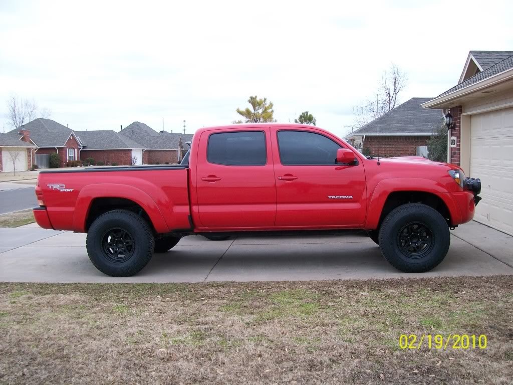

    I'm running 285/75/16 Yokohama Geolandar AT-S on 16x8 with 4.5" backspacing, on 5100s at 2.5" on the front and the rear is stock TSB spring height. Only had to do very minor plastic trimming under the fender wells. The tires balanced just fine. Balancing has to do with the type of tire, there are plenty of 33's that balance just fine.

    nice sweet looking truck
