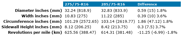

    This is probably your best bet, I hate metrics, 285 is somewhere between 32" & 33" its not quite either one......:confused:

    32.8" almost a 33

    IIRC 285 would be the width
  11. Feb 18, 2012 at 4:56 PM
    StAndrew
    StAndrew Wait for it...
    Feb 8, 2010
    #30950
    7,600
    Hampton Roads, Va
    SR5 4x4TRD
    Intake, exhaust, lift. Typical stuff.
    Gonna say... 75 refers to the size.

    check out (rimsntires.com)they have some cool applications that will alloy you to put in specs for your current"wheel/tire" set-up against the size you'd like to fit.

    if i was in your situation i would just get the 285's the difference between the 275 is minimal.
