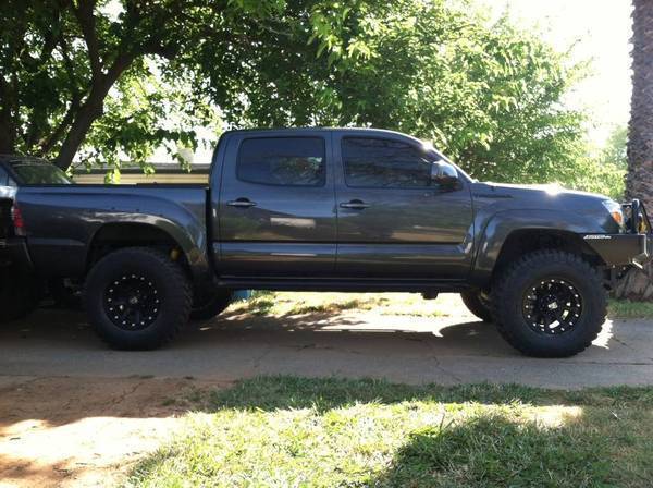

    [​IMG][​IMG]
    I will get better ones later! I didn't go with the 305 because they would of rubbed badly. I went from 305/65/17 to these 285/75/17's and I don't think I will need to trim anything more than I did for the 305/65's. The 305/65/17's tore off the rear flare because of the width, they were like 13" wide on my 9" wheels.[​IMG]

    So when you getting an axle relocate plate? Without it those will rip off your replacement flare and tear out the fender liner in back on your first rear stuff.

    Those only fit drop bracket or spindle lifted trucks.

    I just took the truck to my local off road area and i stuffed the tires as full as they could possibly stuff and the rear no longer rubs at all, Thanks to the allpro rear springs! The front rubbed a tiny bit on the fender flare so that needs a slight trimming, cab mount cleared fine with the current chop. As for performance in the sand and hard packed dirt I was pleased but not super impressed. I missed my claws when I got to the park, but I sure didn't miss them on the highway to the park. The claws definitely destroy these in offroad capabilities, by far! With the claws at 25psi I can climb most all the hills in 2wd with the rear arb engaged. With the BFG's at 15PSI I had to lock it in 4wd much more often than ever before. I didn't want to air down too low because I was there with only my 3 year old daughter, and she wouldn't have been much help resetting a bead;)

    Might be the case for a truck that hasn't been trimmed, but my trucks been trimmed a lot. And I have the allpro rear standard pack that relocates the axle back 1".

    Damn! Truck looks badass with those 34's on bro! Thanks for sharing pics with us and if you have a pic with a head on view that would be nice to see. Did you take any pics while flexing the truck out?
    Good to see you don't have to trim the flares much more and you didn't have to beat in the pinch weld in as well.

    I think the fact that these are 285's makes a big difference between actual 35's. They are much skinnier than my 305's were but are 1.5" taller. I flexed the truck at full stuff and had a tiny amount of rubbing on the front plastic flare, 10 second fix. I will get some better pics asap

    I am looking at the pics of you wheel placement and unless you have longer than factory bumps to limit wheel travel you did not stuff the wheel fully because you would not have a flare left if you did that with a replacement flare on there. Im getting quite familiar with the distance the factory spring location and shackles moves the wheel forward under negative arch and noone can run your tires and factory bumps without a relocate plate or repositioning spring pack or they will do damage to their flares... probably ripping them off, breaking tabs and causing a three figure repair. The fact people did not warm of this is why I tore mine off with 285/70r17. For anyone considering this tire size... you have been warned. Perhaps your springs cause a different movement. My tires pushed into bolts and other metal items and were not that close.

    The rear of my truck rubs ZERO, so not sure why you say it will rip the fender off??? I trimmed the plastic fender flare a little but it doesn't rub at all. I also have the all pro springs and they relocate the axle back 1", I promise you the rear doesn't rub at ALL. I will post some pics of my truck with the tires fully stuffed tomorrow, there is no rubbing and I run an arb locker. Before the allpro springs i rubbed horribly.
