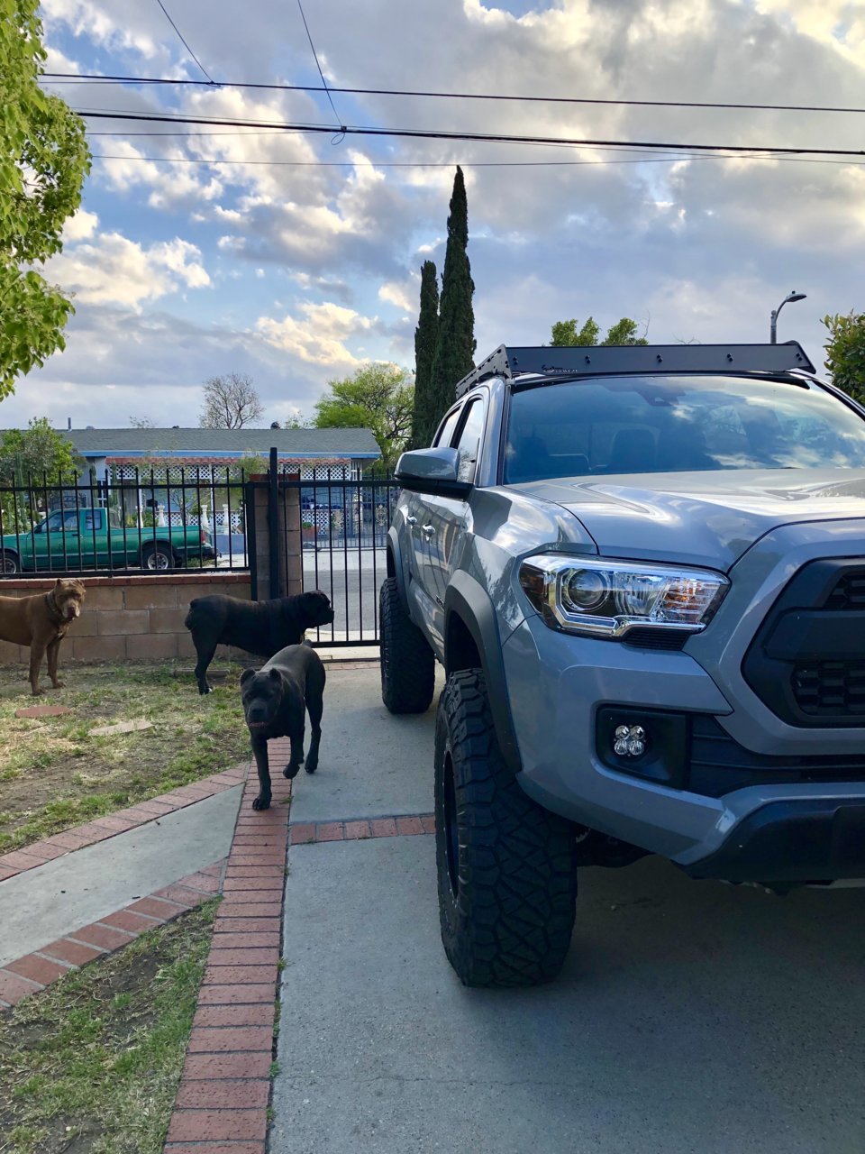

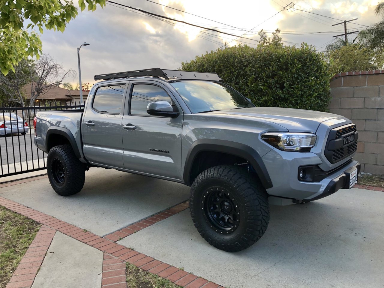

    Really digging these 285/75’s80EFAA23-14C9-4B95-8AB1-FC1C6F6B44AB.jpg70999D36-980B-4A99-A132-851C58DAA359.jpg

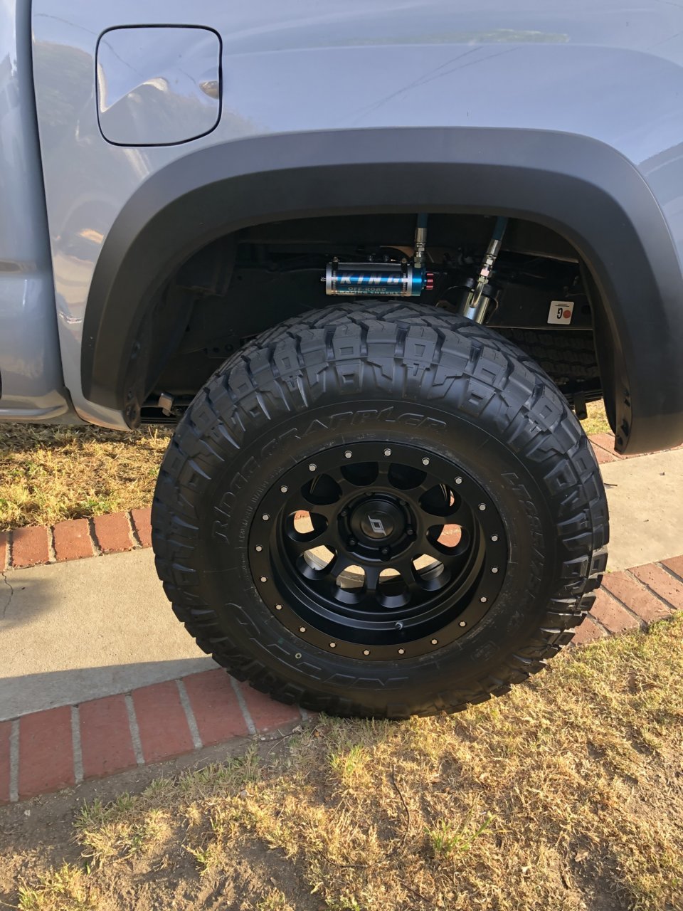

    Those on the -38 Ray 10’s? Can you post some shots down the side showing the poke?

    BC8C8665-68FE-4D29-95F2-968DD3D0564C.jpg 3B4B1C0B-01C7-4D3F-A6BA-B9F4F5F513C0.jpg

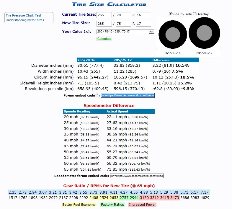

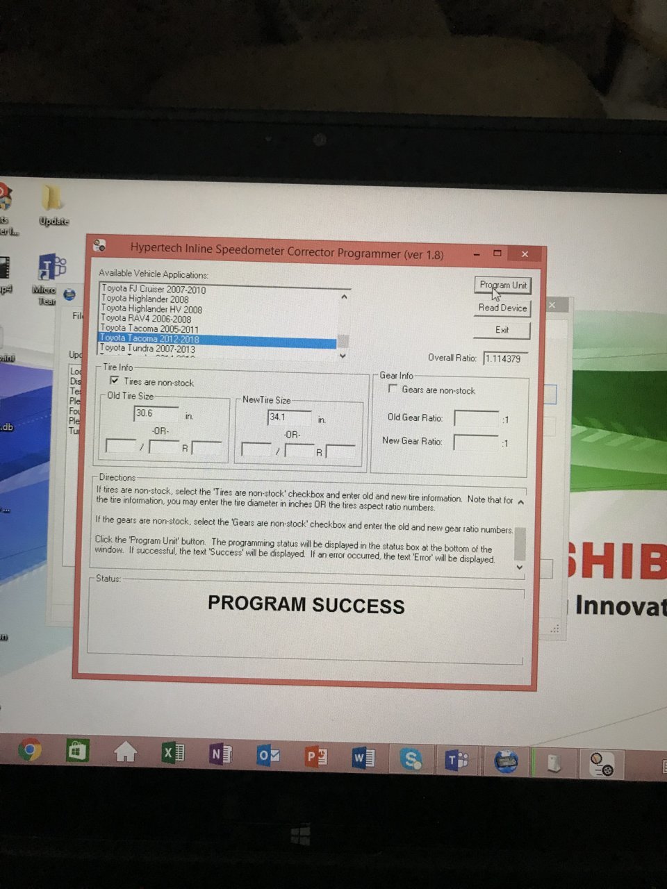

    how much is the speedo off on 285/75/17 when the stock size was 265/75/16???

    Thought stock tire was 265/70/16? Atleast that's what I have. If so, see below:

    yea “70”
    but holy shit i’m about 7mph off on the freeway! damn this upgrade is about to get me a ticket from the cops in certain areas... thanks for the info

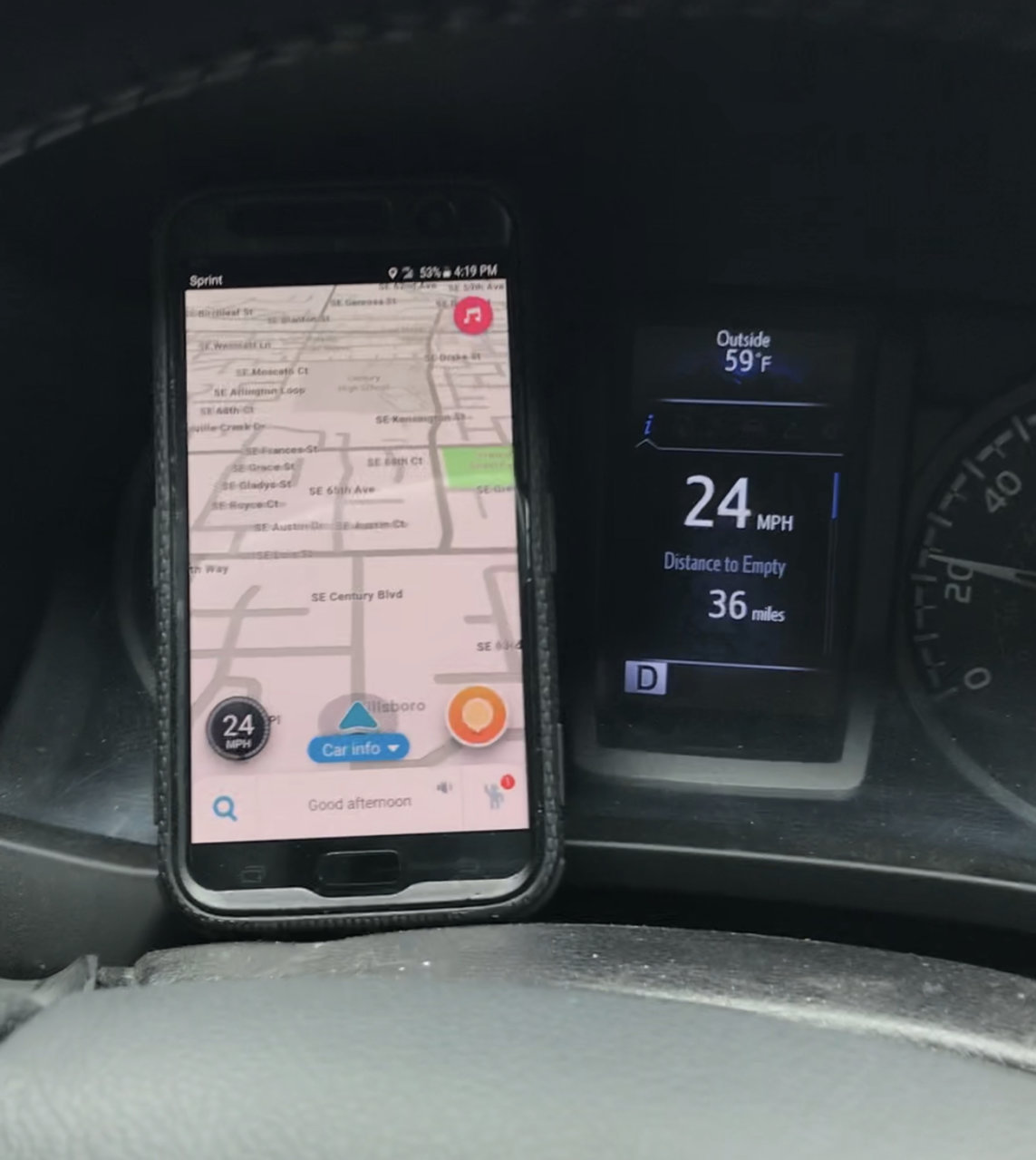

    My speedometer was off by 7MPH. I used the Rough Country calibrator and now it’s on point. It uses the Hypertech module but costs cheaper than the Hypertech. https://www.roughcountry.com/speedometer-calibrator-90043.html

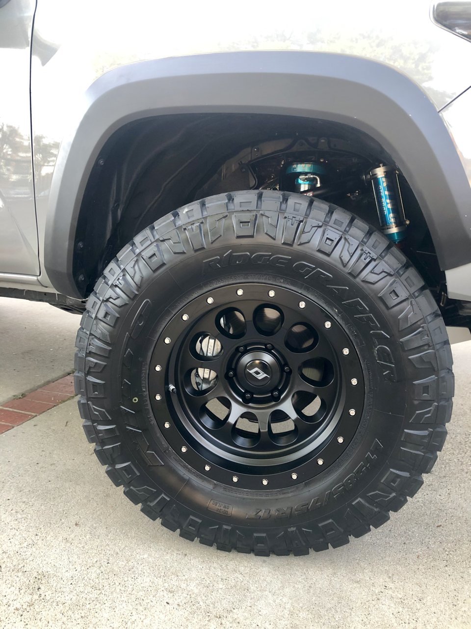

    19
    Matthew
    2013 Toyota Tacoma TRD Sport
    Icon Stage 2. 285/70/17r Nitto Ridge Grapplers. 17" Black Satin Icon Rebounds
    Those and the Ray10s are my fav for tacomas.

    I have the hypertech speedometer calibrator and it works great.

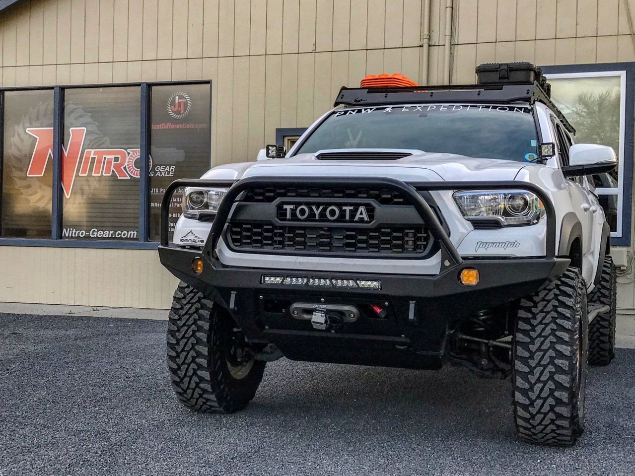

    Since I live in a place where there’s lots of hills and mountains I believe I needed to. I can feel the lag going on inclines. Actually I just got to Nitro Gear & Axle lol!

    hell yeah! That thing looks great! Im hoping to ride it and see first, Im in a pretty flat area. Understand the need at altitude though!! Great looking truck!
