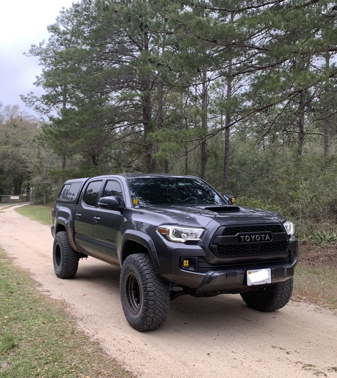

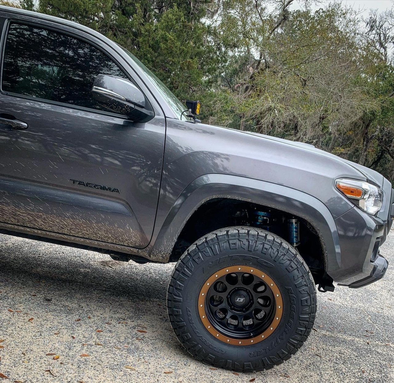

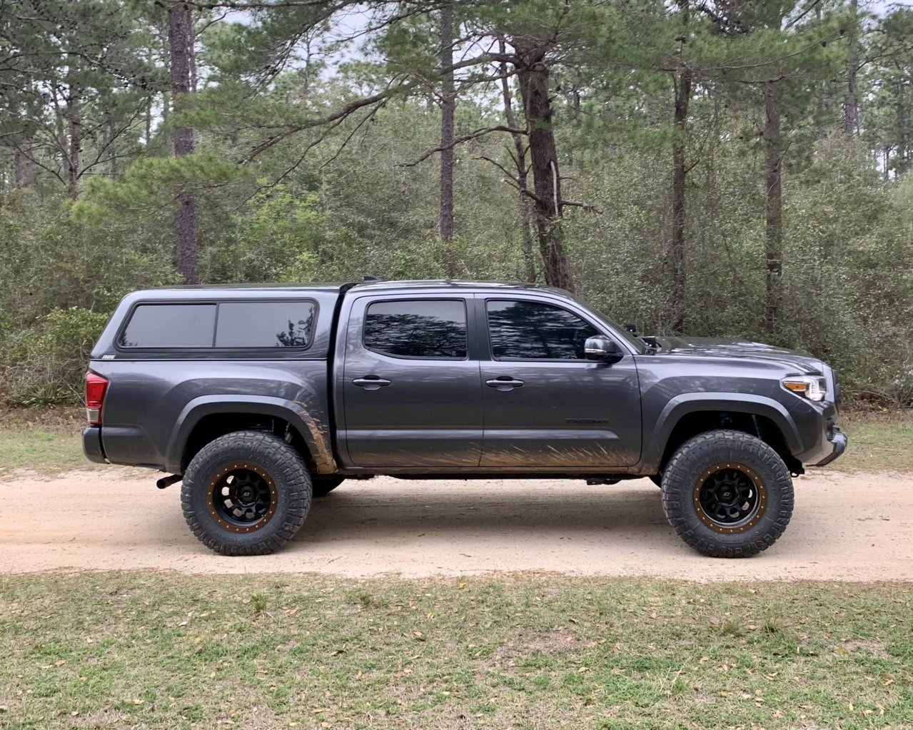

    0EE17C1F-2147-48F0-AC3A-3DAD79C0A875.jpg 17746CF2-9AF7-4A06-AD9E-7F5F53792C35.jpg 577FED1A-6FEE-4937-B13B-373EEB01B47F.jpg 285/75r17s C load ridge graps. I have them at ~26psi front ~25psi rear. Rides like butter. About 2 inch lift front. Icon AAL rear. Gonna get the Icon RXT pack as the shell and full size spare makes the rear sag. “Aggressive” CMC, pinch welds and in my opinion some light trimming to fit. It’s been said before already I’m sure, but a good alignment is key. SPC uppers. Zero clearance issues. The -38 offset wheels

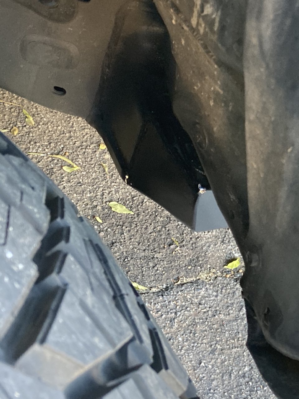

    Trimmed up in anticipation of wheels/tires. (cmc/pinch weld)
    I figure ill wait to trim the majority of the plastic to see what needs to go
    ... or i may just take off 2" from all the fenders lol
