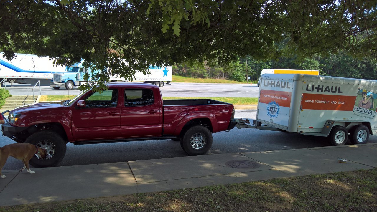

  6. Nov 21, 2017 at 4:15 PM
    #46
    Hennessy
    Hennessy Well-Known Member
    Oct 20, 2013
    #114857
    396
    Charlotte NC
    13 Red DC TRD Sport
    Demello Baja bumper, Mcneil Fiberglass, Fabtech Uniball Upper Control Arms, Emu Dakar leaf springs, Fox 2.5 Factory Series Coil-over IFP, Fox 2.0 Performance Series IFP
    I make a little contact with the foot well area when I really stuff it, but other than that Fiberglass for the win! :D
    I could not find a good shot from the side so this one will have to do.... 285-75-17 nitto
    Watt maker likes this.
