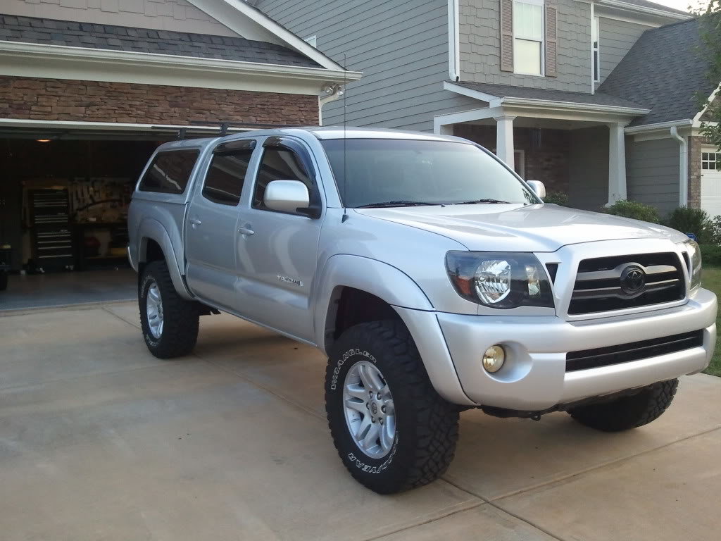

    I haven't heard of 285/75/17's. However, I'm running 285/70/17's duratracs on the OEM tundra/sequoia 17's (they have 4.5" BS) with 5100's set @ 2.5 and the only rubbing I have is rubbing the UCA at full lock in reverse. I had to trim a little plastic and remove the mudflaps but that's it. I don't rub the cab mount even stuffed. It just clears it.

    You shouldn't need to trim much of the fender flare. I just trimmed a small corner off in the front and a small corner in the back, then trimmed the black plastic fender liner.

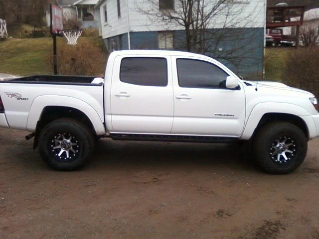

    I put 285/75/17 Terra Grapplers on the stock wheels and as stated in previous posts, they were rubbing just slightly on the UCAs with 3" coil spring spacers in front. Just changed the wheels to XD Series Addict - 17x9 4.5" BS and -12 OS. The tires are clear of the UCAs, but are now rubbing at the pinch weld and a little on the flares. Gotta get in there and do some cutting now. Not sure of the cab mount chop. I need to get a little more detail on that one. :cool:
