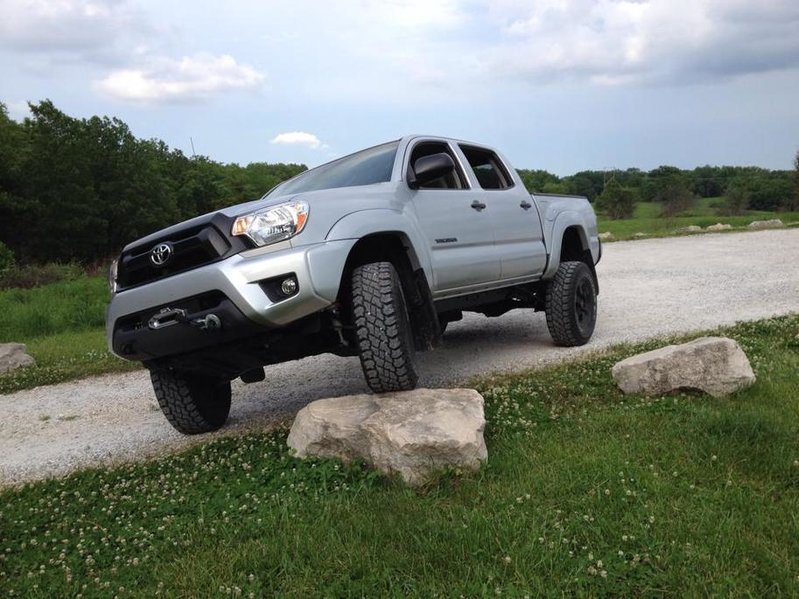

    AlanLoshbaugh
    AlanLoshbaugh Well-Known Member
    Dec 26, 2012
    #93754
    593
    Alan
    Columbia, MO
    2013 Tacoma Double Cab 4x4
    Poseur shot.
    No rubbing.

    I know this is old but how close were your tires to the UCA? I want to get this setup
  7. Jul 31, 2015 at 6:27 AM
    #47
    Boone
    Boone Vaginas are rad.
    Jul 16, 2012
    #82731
    7,015
    Boone, NC
    Airbags deployed
    About 5/8" away.

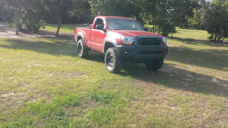

    Jstn87
    Jstn87 New Member
    May 30, 2016
    #188250
    3
    13 reg cab bad model 4wd
    3" lift 285/75r16
    285 75 16 km2s with a 3" coil spacer no rubbing or trimming needed yet
