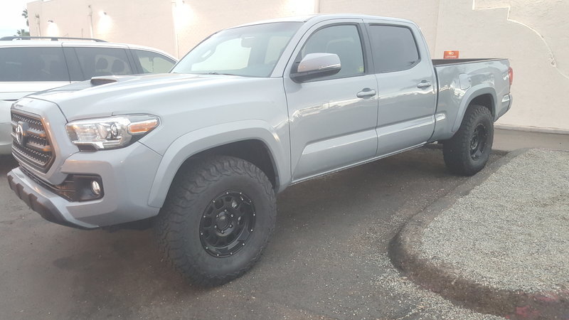

    2016 Cement Gray TRD Off Road
    Hey guys I went with the 285/75/16, its rubs a bit at full lock. Not sure what would work better 2-1 or 3-1. I mostly do freeways here in San Diego and minimal Baja roads down in Ensenada and Rosarito.
