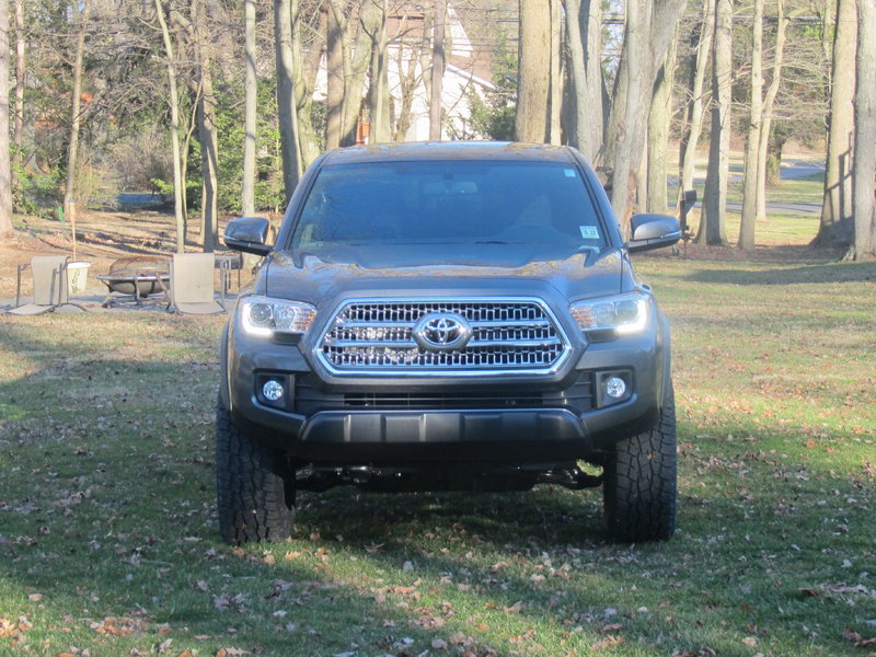

    Here it is if anyone was curious.

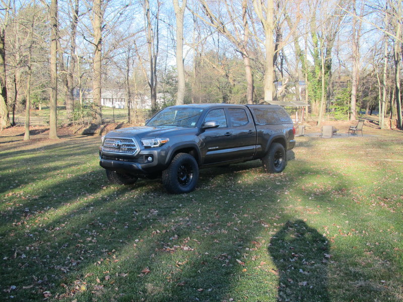

    And the stance...

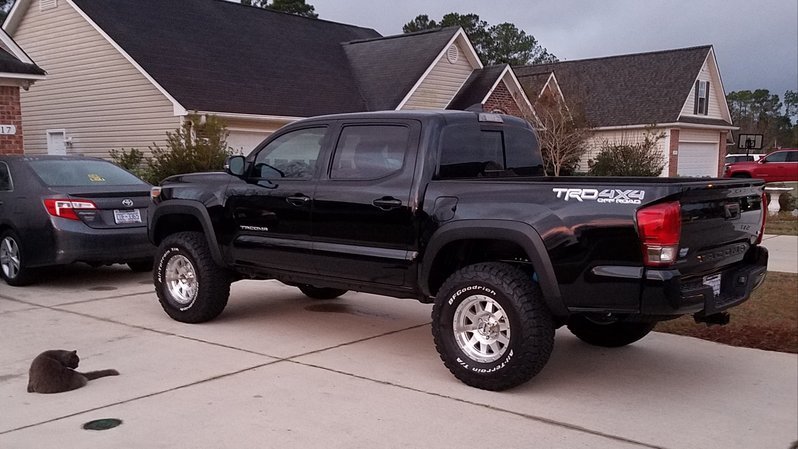

    2017 BLACK TRD OFF ROAD DCSB
    3inch lift,285/75/16 on method 301's
    Mine with 3 and 1 lift with 285/75/16 BFG

    Nice @lsutiger1 . Did you do a CMC or did you have to just use a heat gun on the fenders? Whats the offset of your wheels?

    I haven't done anything, dealership installed the lift and have not had any rubbing issues at all.
