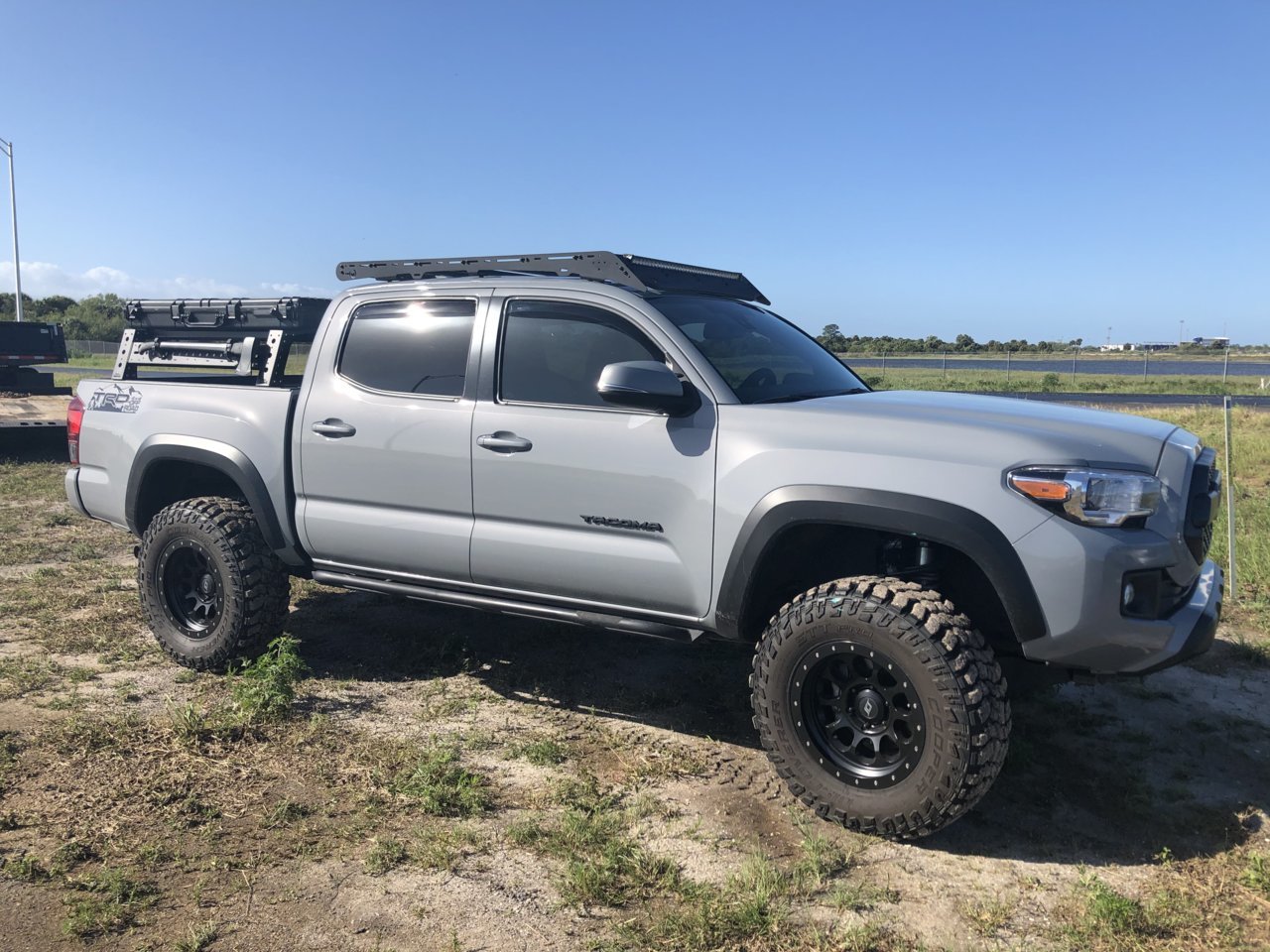

    taco_feevuh
    taco_feevuh SUUUUUUUUUUUUP?!
    Sep 29, 2018
    #267830
    252
    Merritt Island, FL
    2018 cement Tacoma TRD OR 4x4 DCSB
    Rci sliders, Trd pro grill, Fox 2.5 fronts, Fox 2.0 rears w/resi, SCS Ray 10’s, Cooper stt pros
    It’s a total process to eliminate the rubbing when running 285’s. Every truck is different but I’ll tell you what worked for me. 3” lift, Spc adjustable uca’s, heat gun plastic in the front with some trimming, cmc, hammer pinch weld and an alignment setting the wheel more forward in the wheel well. Prolly not gonna happen over night. But now I can bounce up and down trails all day and not rub at all. 3A3A974F-5492-4A9C-B5AA-D8FD27F65060.jpgThe struggle is real but worth every bit of time and effort
