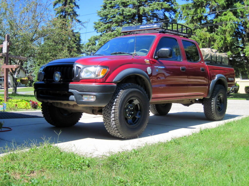

    '04 DoubleCab "3 Lift on 285/75/16s
    All Pro rear bumper with an Ironman Offroad swing-out spare carrier, Bajarack on top, blacked-out grill, Lightforce 140s Mombasa Rooftop Tent
    I have been running 285/75/16 Treadwrights on black powdercoated FZJ80 wheels since July. I have a SuspensionMaxx coil spacers with AALs in the back. I get some frame rubbing at pretty much full lock in the front but nothing on the UCAs. I had to do some trimming too but nothing too major. I get an occasional rub in the back too but not very often. I do sort of wish I went with the next size down but not that big a deal. I am hoping to get some Bilsteins next spring all the way around unless I find something else. They would be on there now but noone had Bilis most of the summer.
    BTW retread naysayers, the Treadwrights have performed flawlessly and balanced easily.
