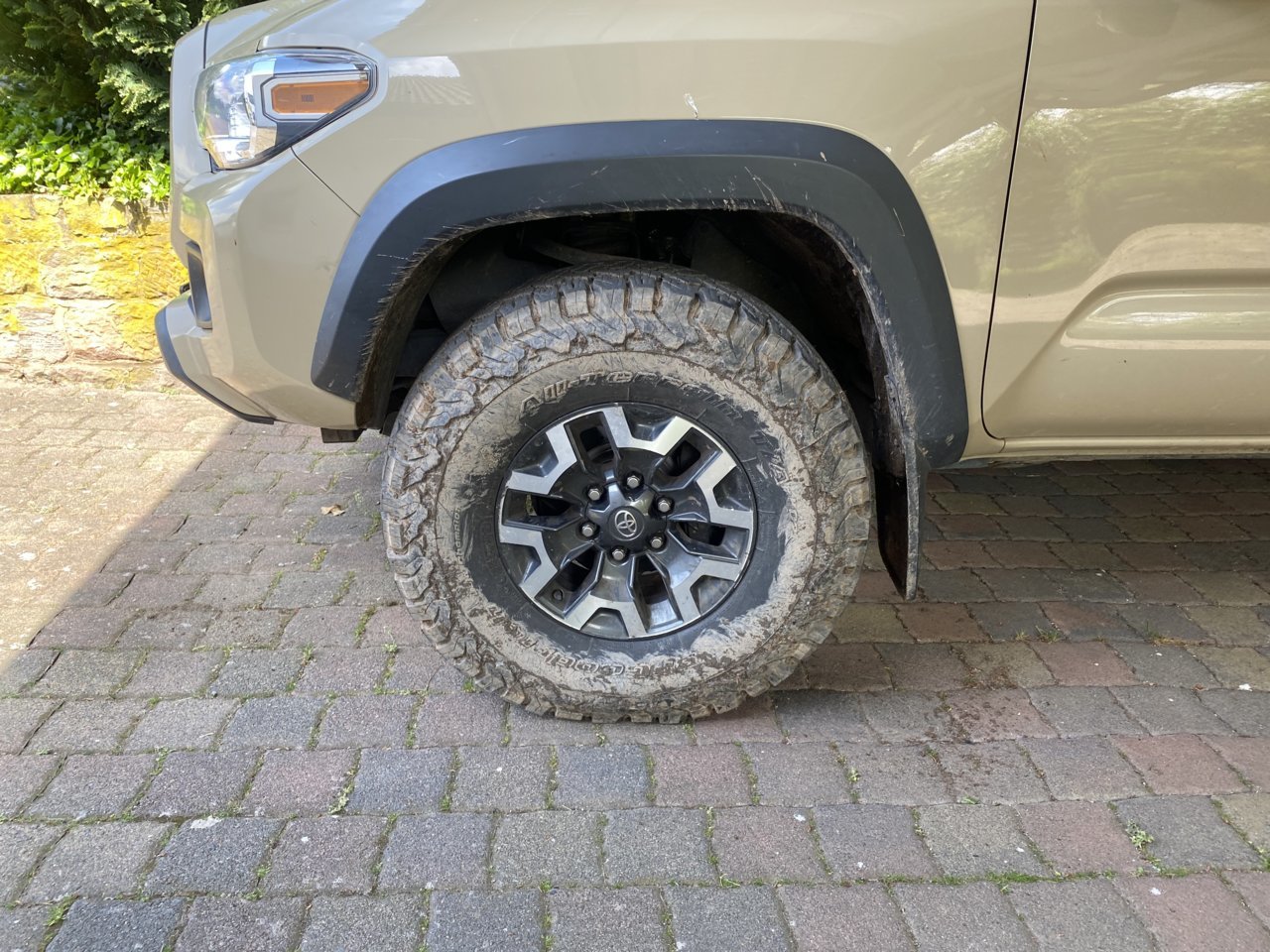

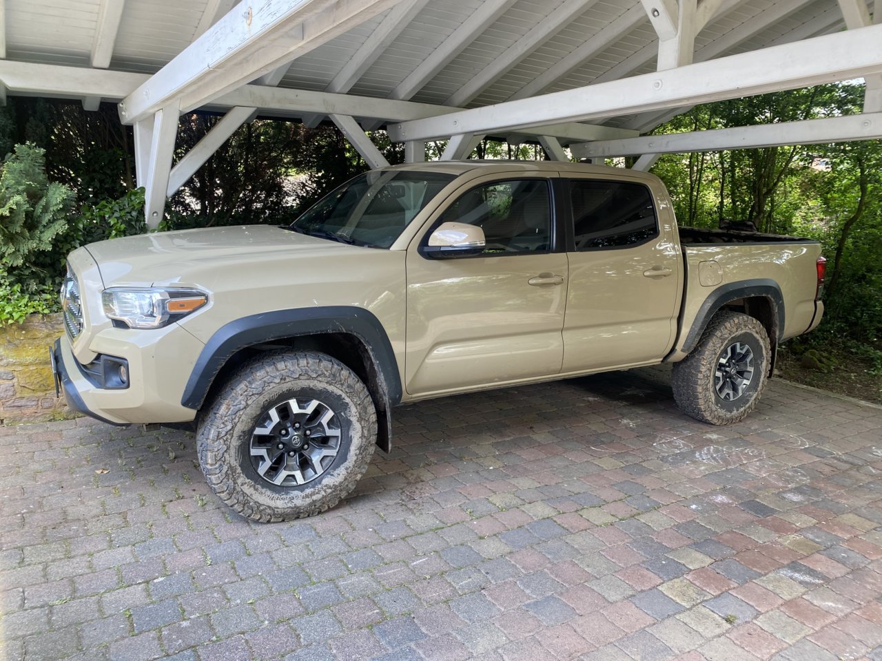

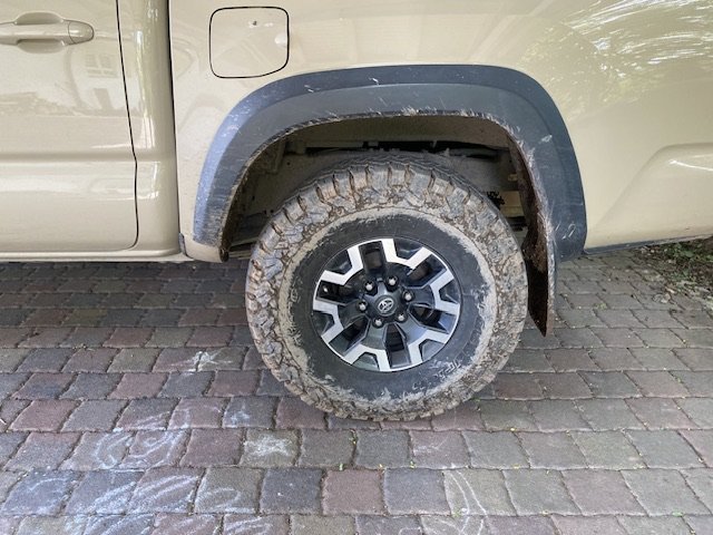

  18. May 20, 2023 at 9:46 AM
    #38
    Nautiq176
    Nautiq176 New to this world
    Aug 4, 2021
    #373234
    8
    Mitch
    Germany
    Tacoma TRD Off-road
    Coming soon
    Did mine today with 285 75r 16 and a 3/4 inch spacer and no lift. Had to remove the front mud flaps. No idea on gas mileage yet IMG_1063.jpgIMG_1065.jpgIMG_1064.jpg
    Taco_Elite likes this.
  19. Aug 3, 2023 at 5:42 PM
    #39
    Ponder85
    Ponder85 Well-Known Member
    Mar 22, 2019
    #287574
    60
    Brandon
    Cincinnati, OH
    19 DCLB TRDOR
    Do you have any rubbing on that?
  20. Aug 3, 2023 at 7:46 PM
    #40
    Nautiq176
    Aug 4, 2021
    #373234
    8
    Mitch
    Germany
    Tacoma TRD Off-road
    Coming soon
    I did on the plastic where the cab is pinched but I took a heat gun and stick now it’s golden. UCA and body mount are perfect so not replacing or chopping.
    Ponder85 likes this.
