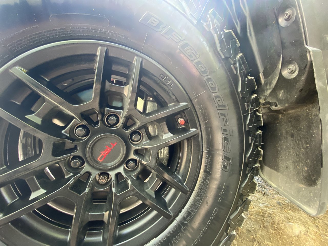

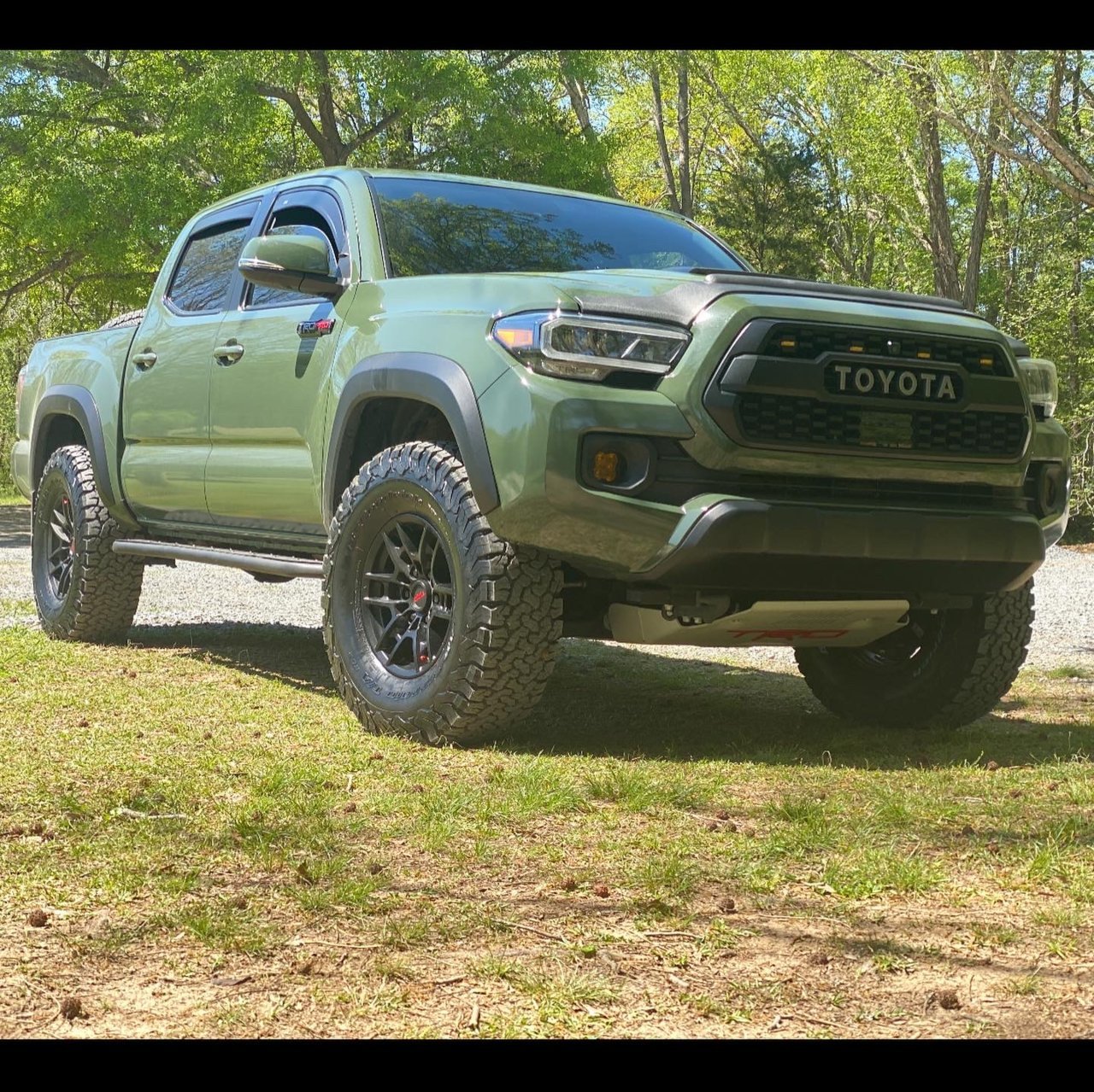

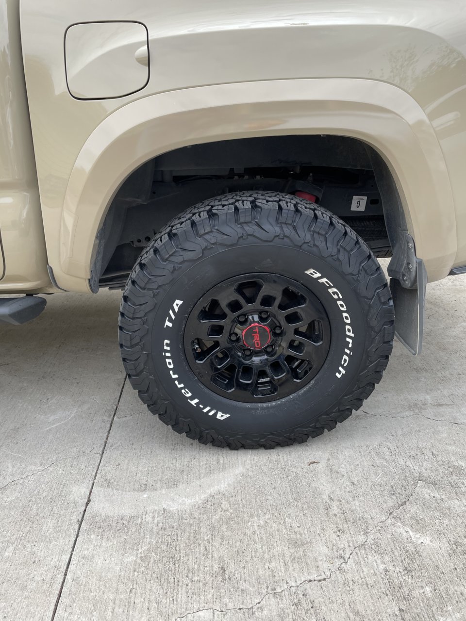

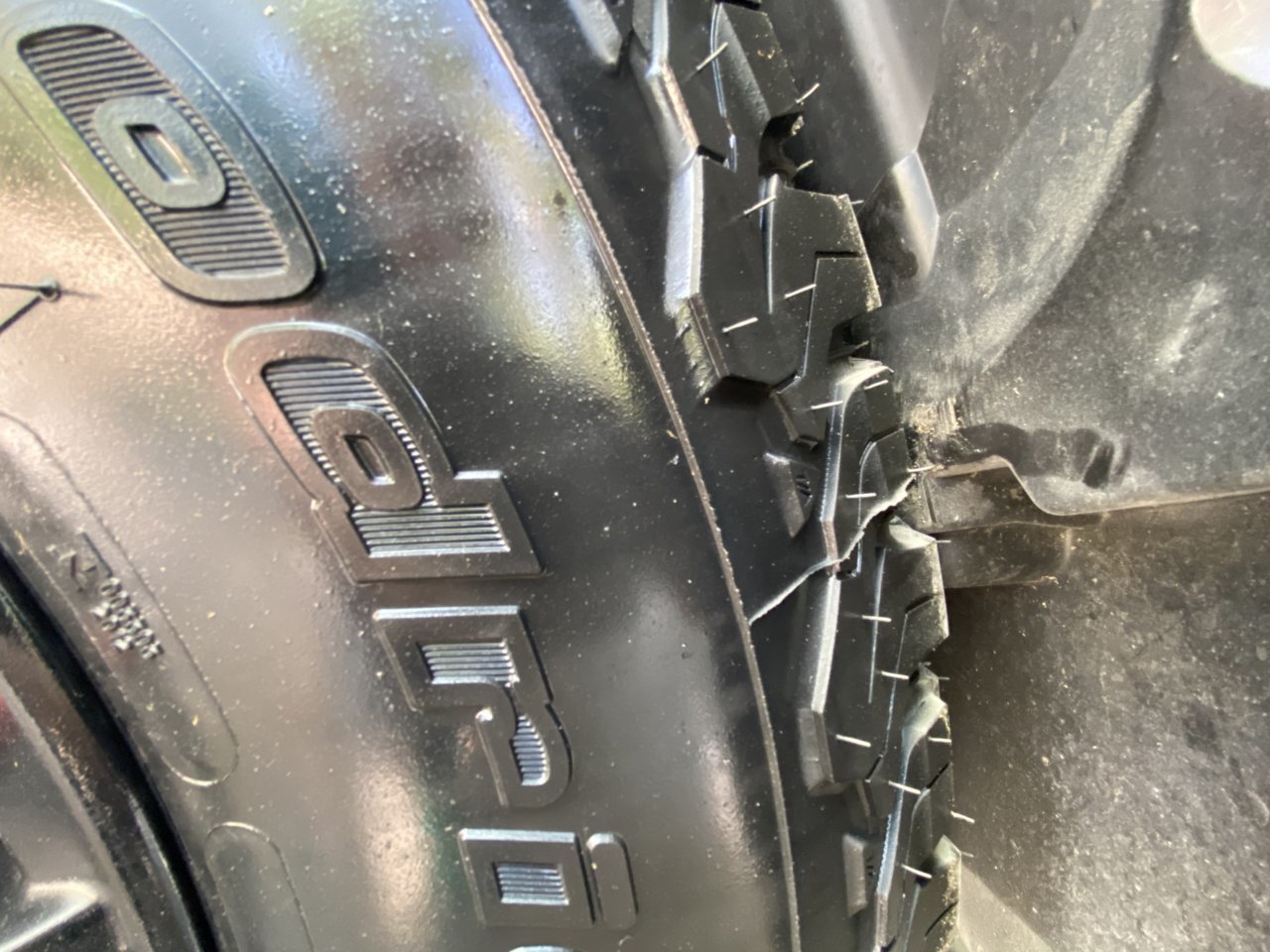

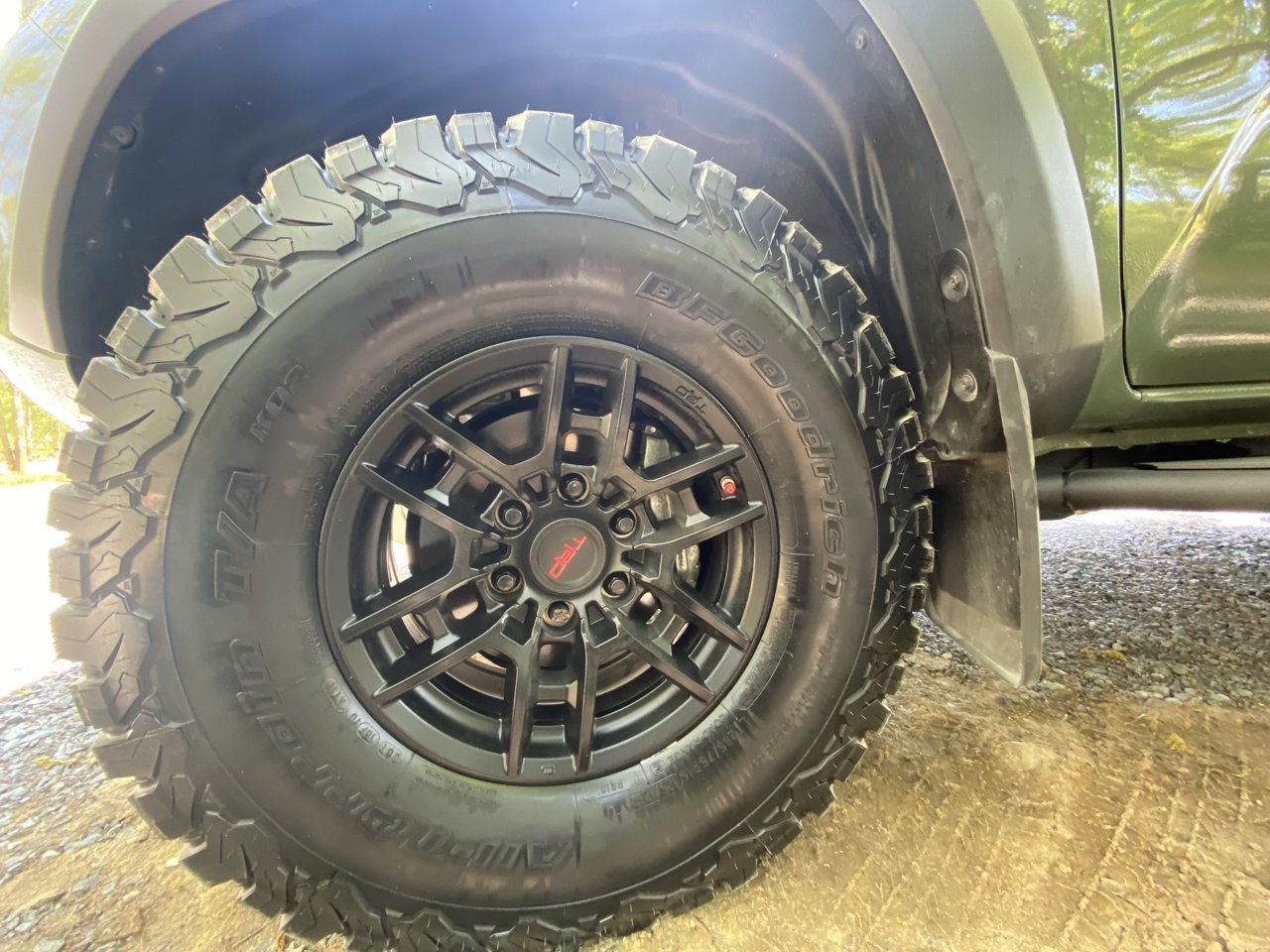

    If anyone is wondering. 2020 trd pro - stock - k02 285/75r16 - yes I know I have mud flaps on and if it is off, if I go wheeling, I would rub like she ain’t never felt before. But if you mall crawlers wondering. Yes it will fit. Gonna put another couple inches of lift on in the future with Uca with alot of chopping and pinching. Trying to go for 295s or some off set wheels.
    stock with 265/70r16
    stock trd pro 285/75r16 BFG ko26B8ACC79-E5F9-46AD-98DD-66F6FAB15AA7.jpg84ACDD7B-7642-4765-9A09-7F050EE9044F.jpg 84765E98-F26A-4C7C-84D9-E8525083A813.jpg33E2683A-03ED-4219-8D7B-0F9839D5C534.jpg
    No I haven’t did any mod on feder wells or cmc.

  9. Apr 12, 2021 at 12:34 PM

    Interesting for sure. Are you getting any rubbing at the front of the wheel well? My 2017 TRD Pro rubbed in the front of the wheel well which a heat gun took care of very quick. I got some rubbing at the rear but only with my mud flaps on. Once I took them off, no rubbing at the rear of the wheel well.

    Has about an half an inch to an inch in front, then as u can see, it rubs with the mud flaps on. I’m sure a heat gun could fix it. But still gonna get the other mods due too wanting to wheel.

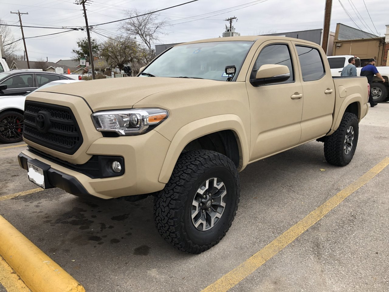

    I trimmed my flaps on my 18 and got an alignment and stuffed em wheeling and no rub. Heat gun would have prolly worked as well. I’m also on the same size tires and brand. I love em. 8605F353-3E26-46B5-B3A6-0CEE1119578B.jpg

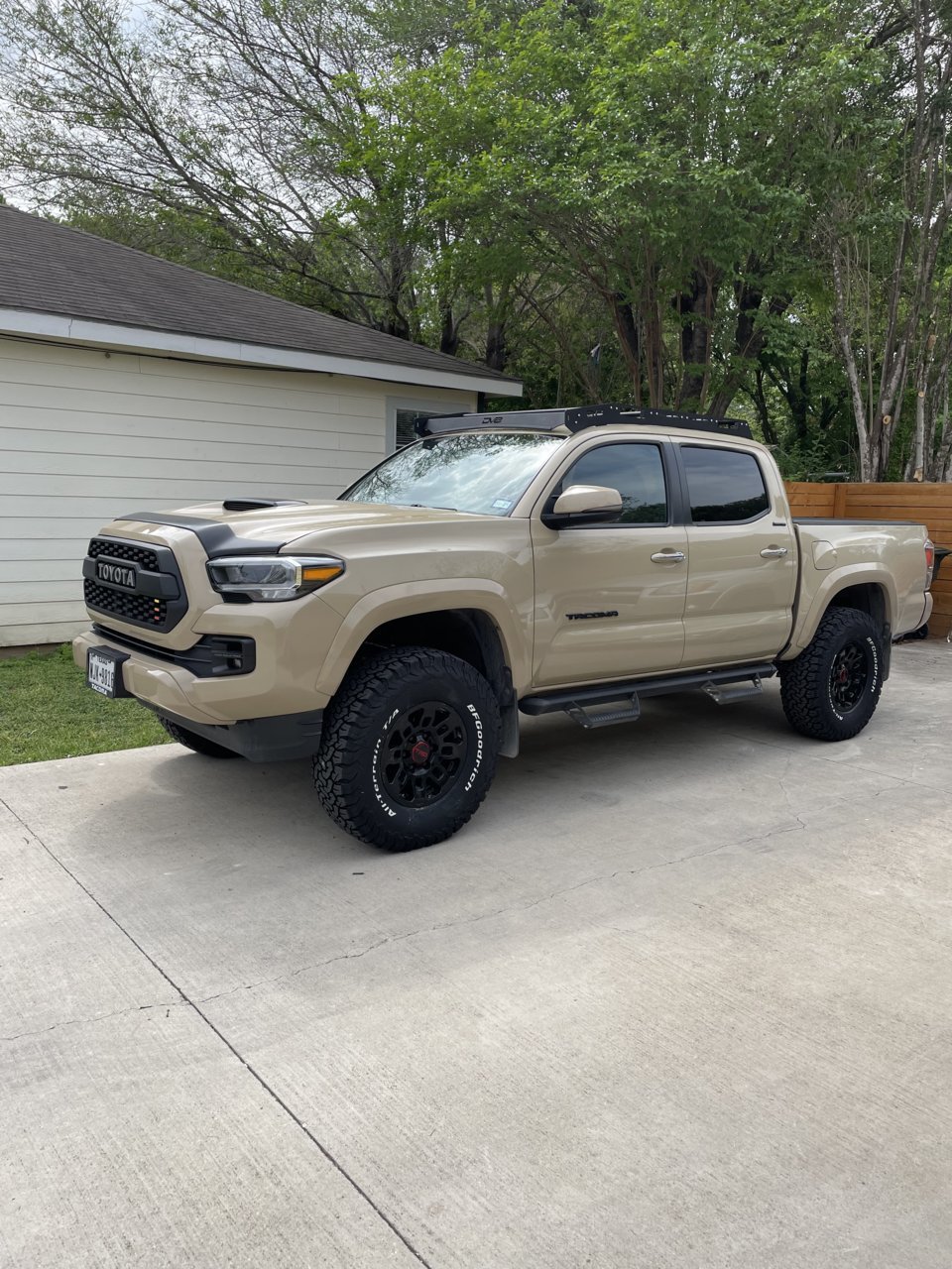

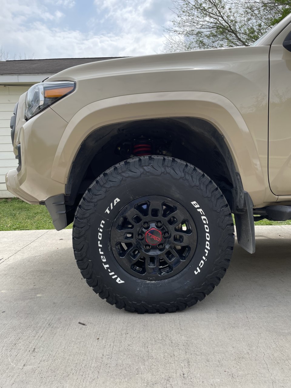

    Adding my 2 cents. I have a limited with pro suspension, icon UCA’s and 3 leaf pack with the westcott kit. Installed 285/75r16’s and so far no rub but that might change on the trail. Sooo glad I did not go 275/70.
    51AD02AE-5E62-4868-8BB0-C4FE3648F417.jpg 8B0BC35E-53FA-4891-80EC-BFB623FA1693.jpg 2B47D2E6-36AF-427C-96AC-0734DA60D818.jpg
