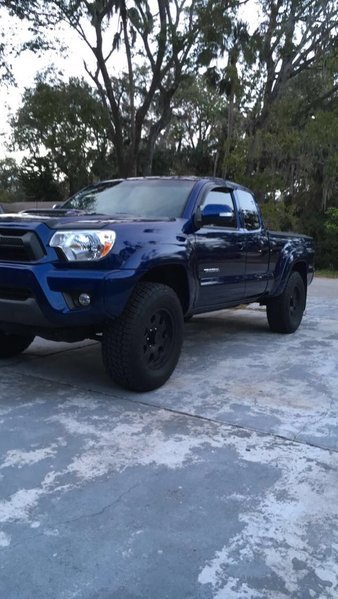

    I have a RC leveling kit and I have 285x70x17 with no rubbing..

    3 inch Toytec suspension lift, 285/75's, Avid off road front and rear bumper guards
