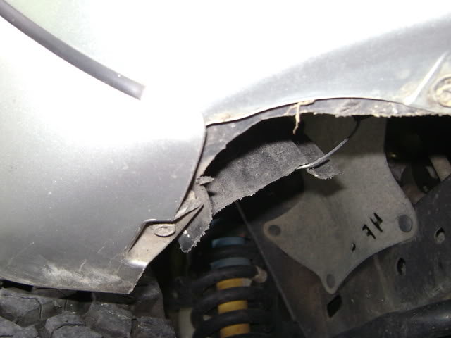

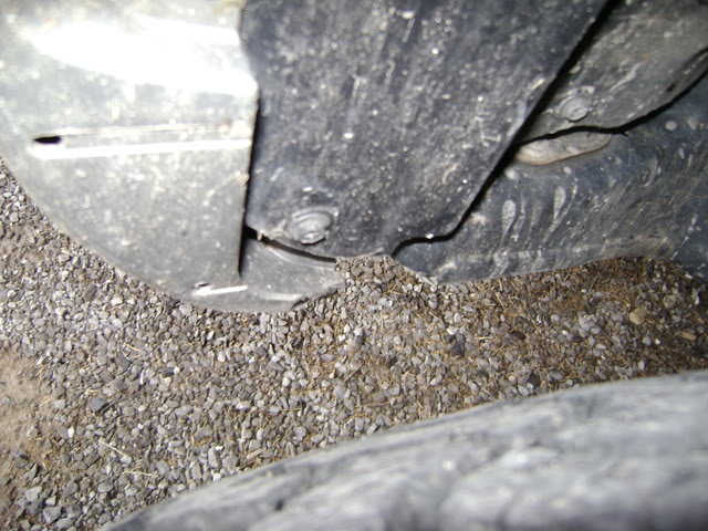

    Here is what needs cutting
    Square piece in front.
    Trim this if need be, the rear near cab.

    1" is whats needed I believe, but some go up to 1.5", personal preference I believe. Let someone else verify before you make a purchase though.
    I posted some pics above your previous post to give you an idea of what I trimmed.

    Thanks for that, it cleared things up for me
