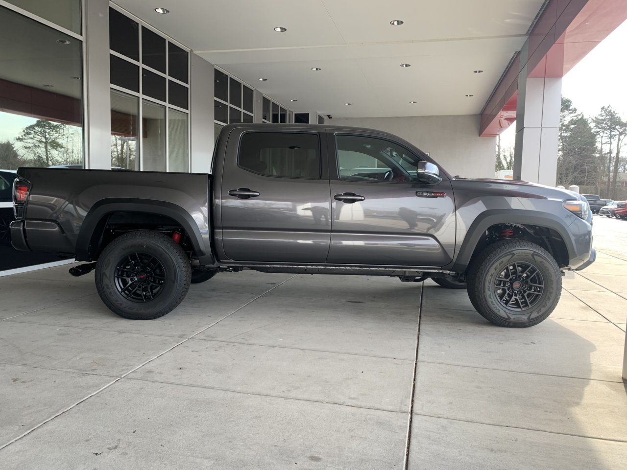

    This one will only be stock for about 2 weeks. I’m putting Fox 2.5 Extended Travel with dual speed compression shocks and coil overs and a full Dakar leaf pack and Total Chaos UCA’s. The 285/75R16’s are going on Saturday. They fit on a stock Pro. It’s what’s on the Voo Doo Blue.

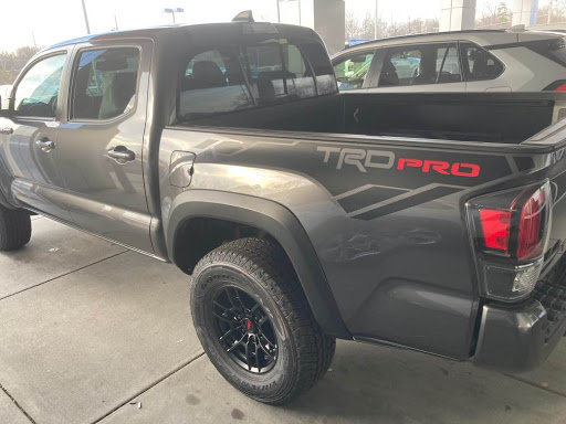

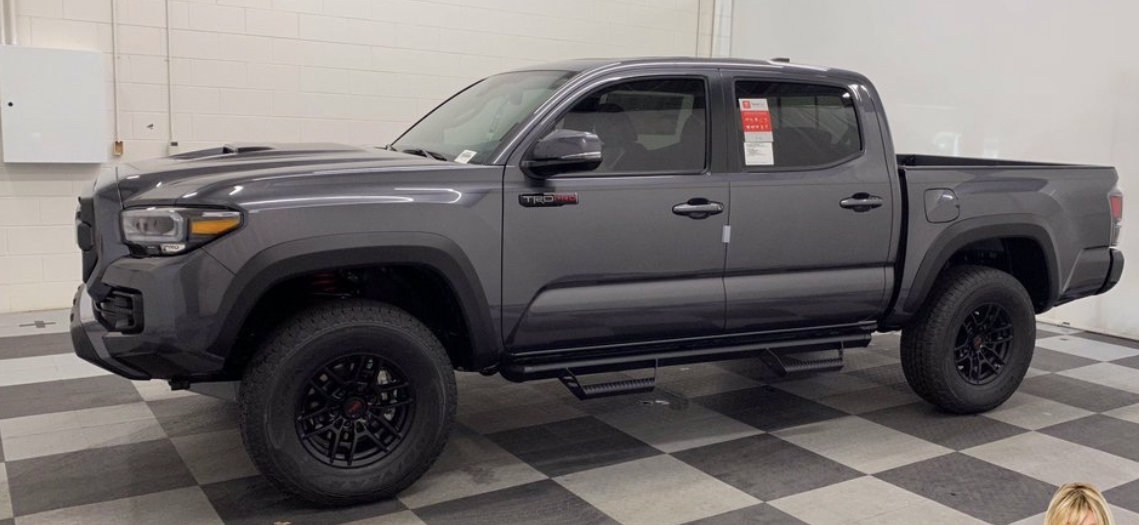

    They ride better on 285’s. More tire = more Cush. They put my graphics on today. Picking the truck up Saturday. Before and after...

    Love that package on a MGM! IMO, it looks the best on that color; I have a friend with that on his black TRD Pro and it looks pretty good also. But looks killer on MGM.....not so much on the lighter colors. Can’t wait to see it with the tires on.
