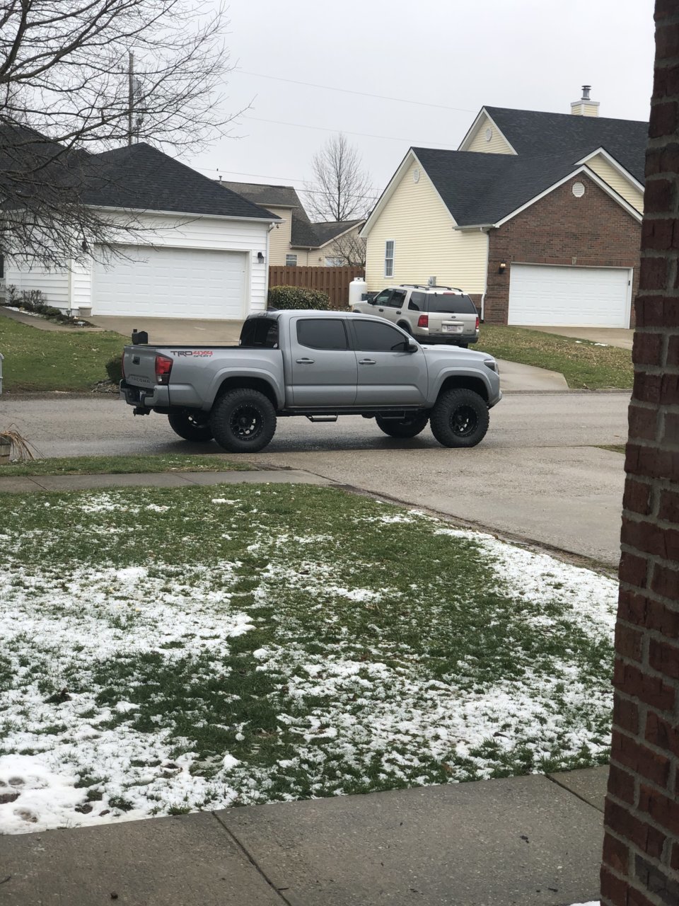

    I think I forgot to post this here :anonymous:
    My favorite picture I’ve taken since I got these on
    elboniecki, alliz86, 4xThad and 14 others like this.
