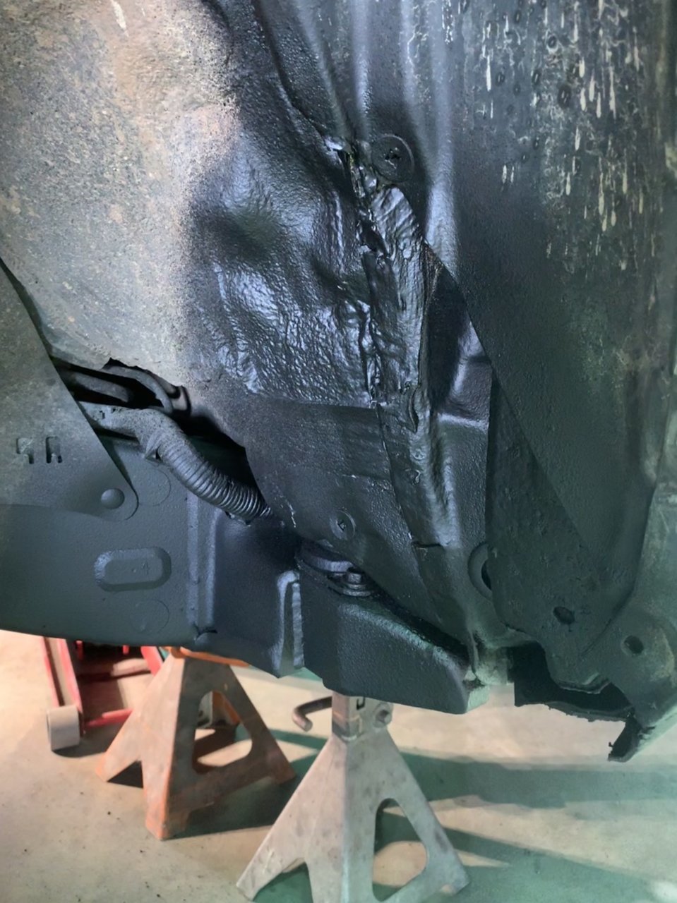

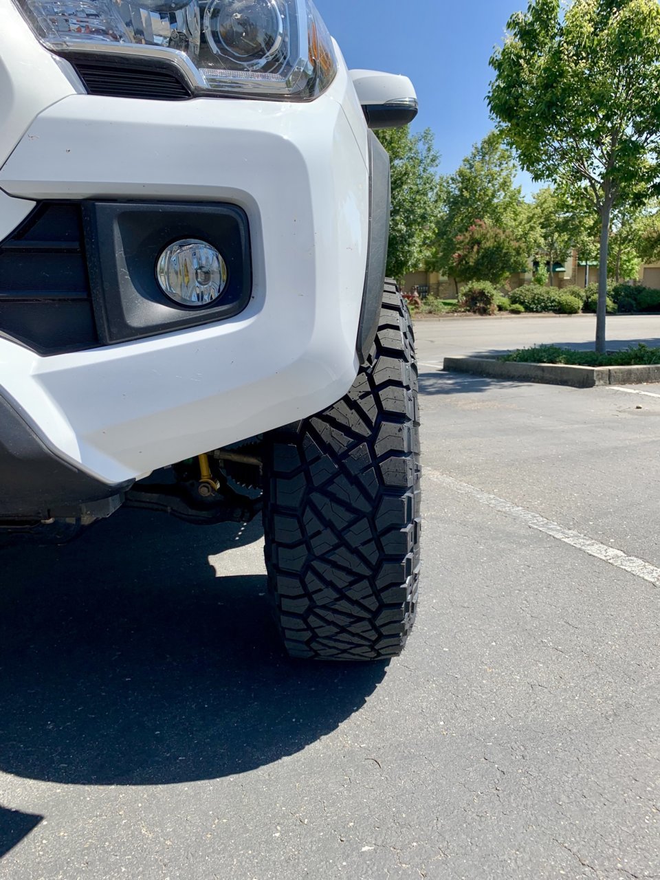

    Wel they’re on! Opened up a can of worms with this -38 offset. Rubbing cab mount, fender liner and the bottom corner of the fender itself. I’ve trimmed back the fender liner for now, still rubbing the fenders, so I tried pounding it back a bit but I’ll have to have the shop trim that when I go in for a cab mount. All in all great tire size and love the stealth blue. BF0C3E9E-9757-4304-8A80-1F5EFA5EE396.jpg4D833FAD-DD47-4F7A-A059-F6E7BD2AEFE3.jpgDF39C105-D292-4B40-B8C6-163B684DE6AF.jpg

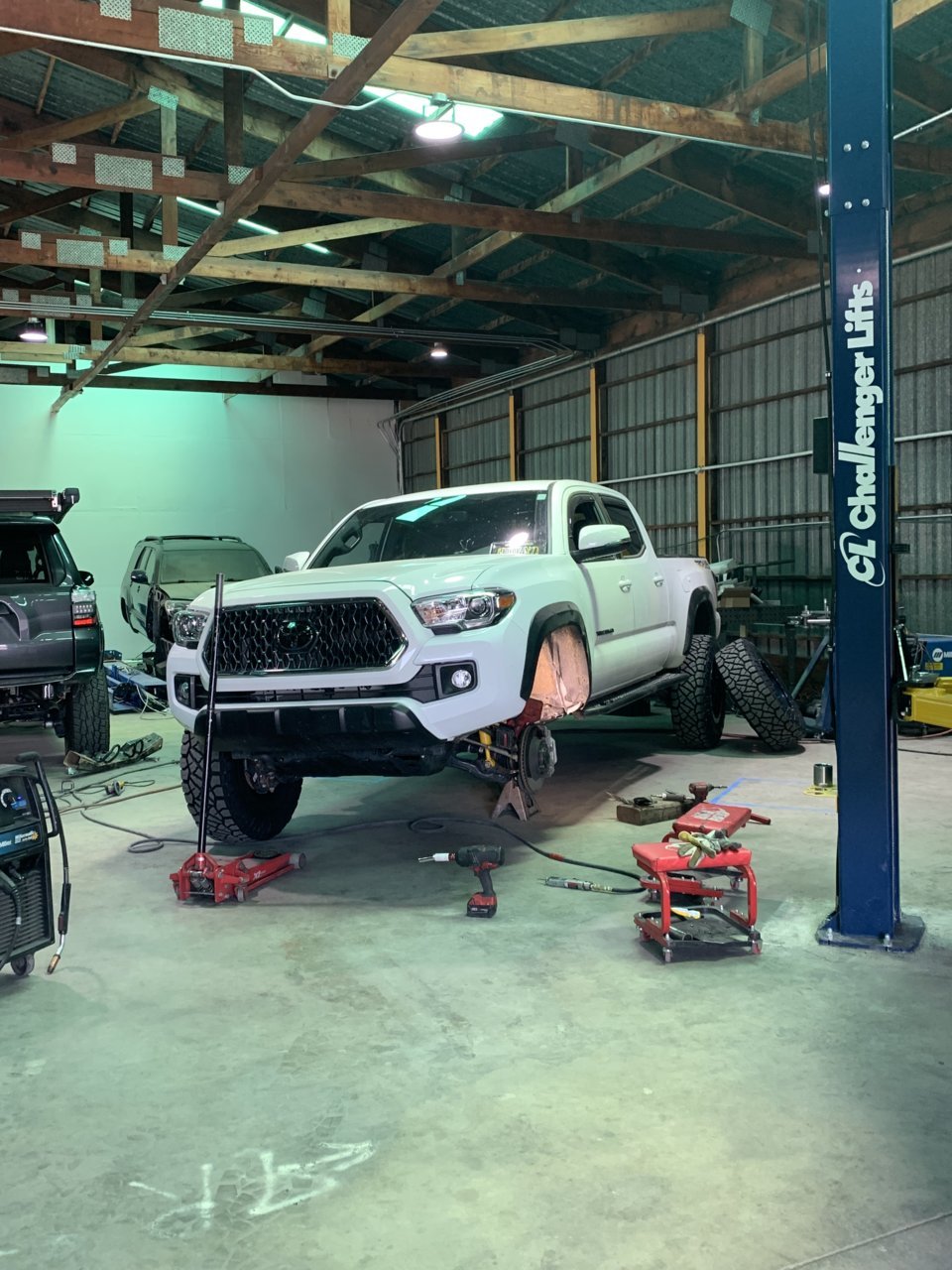

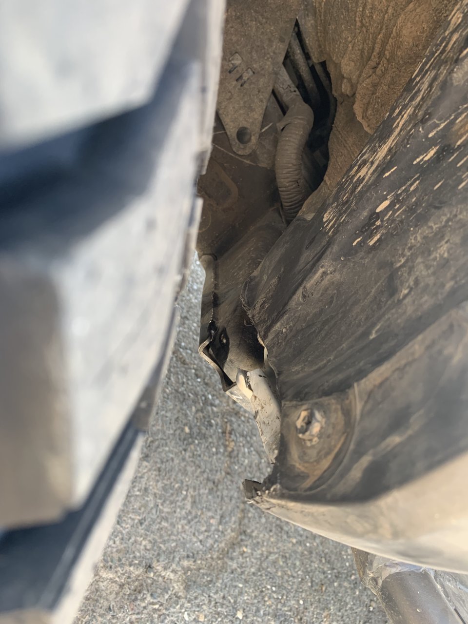

    For those who are curious where it’s rubbing. At full lock, the back corner fenders are the biggest hiccups. The front bumper mount was also trimmed off and will need to heat mold the front fender liner. At the shop to get the rest of the tire clearancing done.

    For those of you looking to run -38 with a Nitto ridge grappler 285/75/17 specifically, be warned that it’s a huge tire. Even after an aggressive cut, 3inch front lift, and caster at 4.7, I’m still rubbing the cab mount at full lock on the driver side. It’s not enough for me to want to do a body mount relocation, yet. It drives great now with no fender or liner rub.

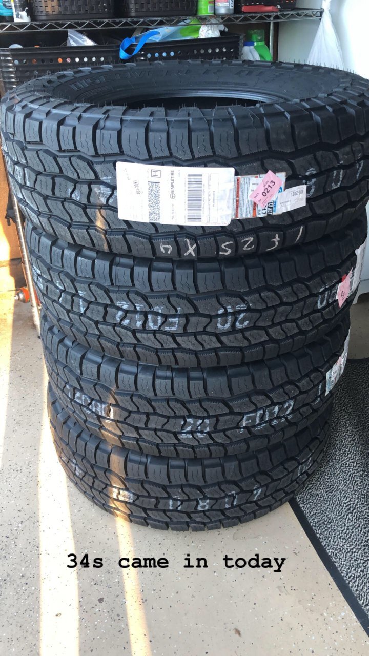

    My cooper discoverer at3 xlt came in today 285/75/17
