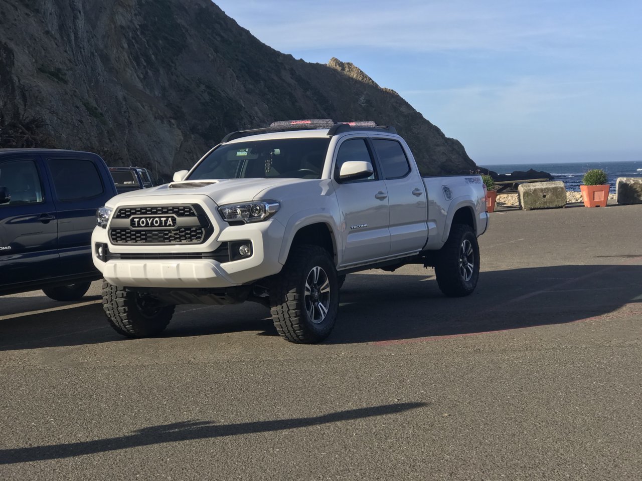

    Like, so many.
    70/17s
  2. Jul 20, 2019 at 10:45 AM
    #302
    blitzkrieg3002
    blitzkrieg3002 Well-Known Member
    May 30, 2016
    #188296
    1,217
    Rick
    California
    2019 Tacoma SR5 4x4
    Awesome. I just don’t want to have to trim around the fender flares. How is the tire holding up I know they recommend 7.5 width tire and up. No issues on the 7 inch width wheel?

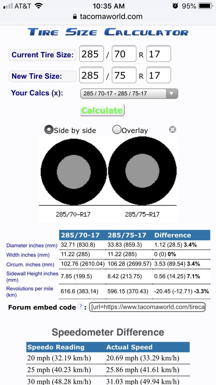

  10. Jul 21, 2019 at 8:45 AM
    #310
    5465
    5465 Well-Known Member
    Mar 4, 2017
    #212289
    946
    South
    2023 TRD Ex Cab
    Are those 285/70/17’s or are they 285/75/17’s ?
    285/70/17’s fit quite easily, but 285/75/17’s are a lot harder to fit and require a bit of work.
    I’m here to checkout the 285/75/17 tire fitment as the title states. Here’s a handy little chart for reference.
