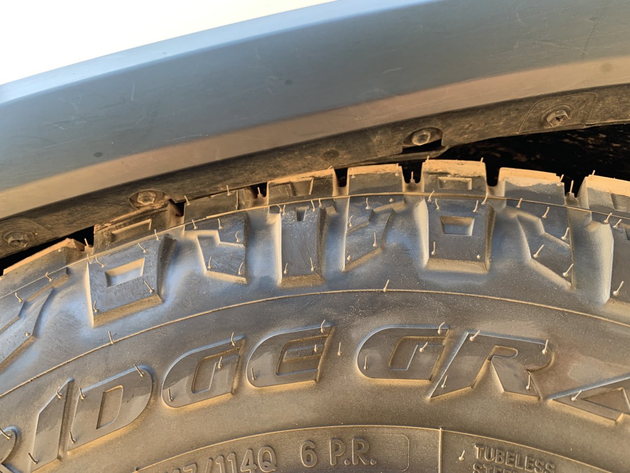

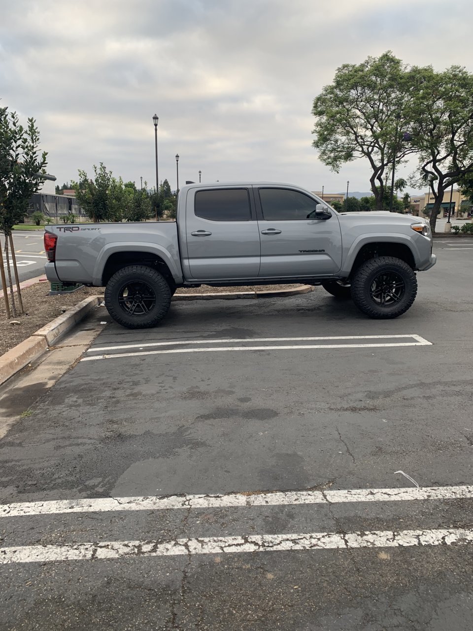

    Having my Cab mount relocation done tomorrow, 285/75/17 KO2, and RRW wheels on order, now the waiting game! 863DB0CC-486C-4D58-B628-0787ECCAEB72.jpg

    That's some clean work

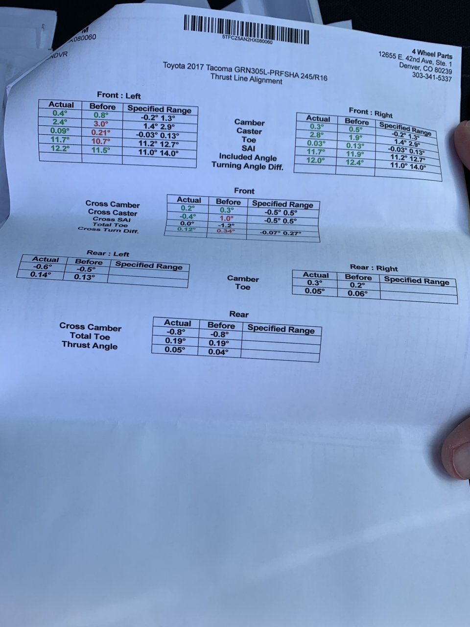

    F9C5386F-CC10-478F-B29F-E449A6A877BE.jpg So looks like I’ll need an alignment adjustment on the caster before I get the new tires?

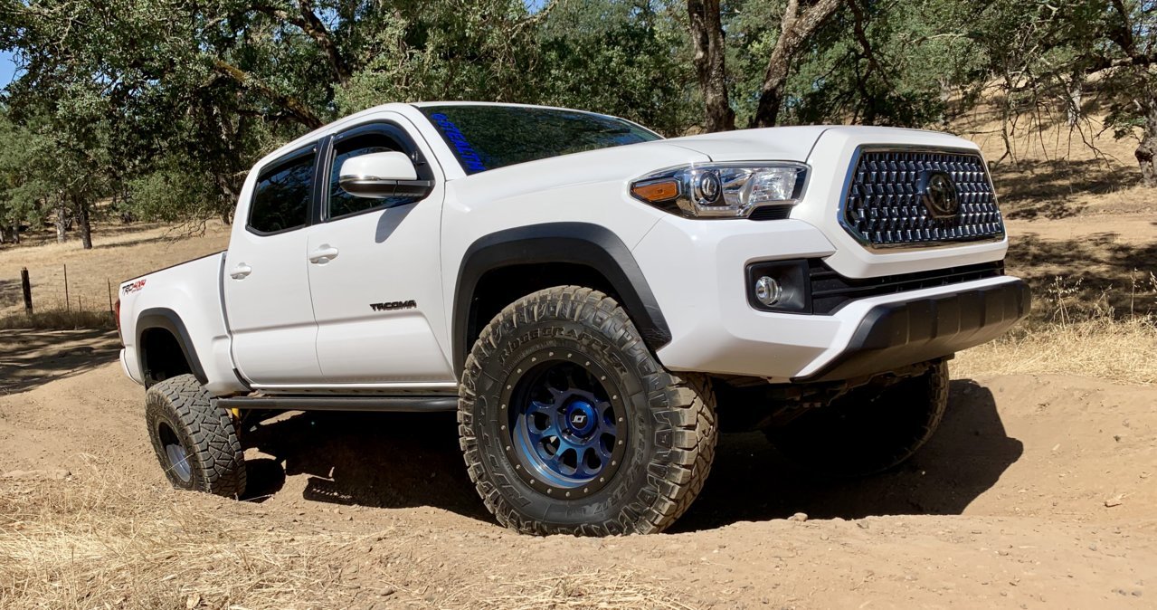

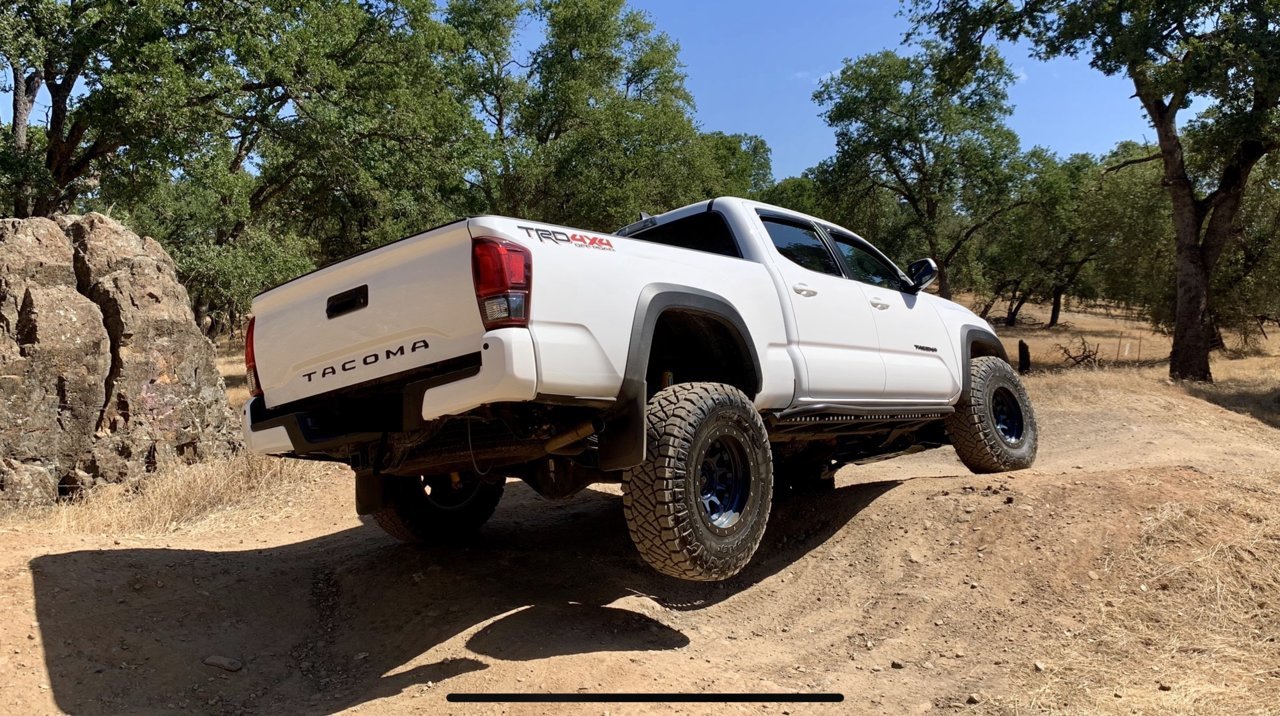

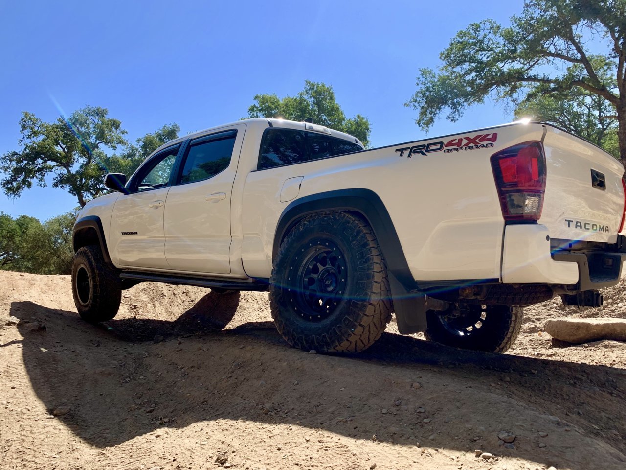

    Can always wait and see if you need to play with the caster more. I’m bringing mine back into to a different shop and see if they can push my wheels a tad bit forward and finally not rub my cab mount.
    On another note, fully stuffed and no rubbing up front. Rears rub at the edge of the fender, so far not enough to need to trim.
    75E756BD-D9B5-42B5-A904-AB47DFD7E2A6.jpg D9163A2B-496B-408C-A6F7-082BF858F7CE.jpg 17A0B953-8A64-4BD1-86CC-69B77C9701B3.jpg 863A3D78-6616-449F-9B1D-260677BCFB38.jpg

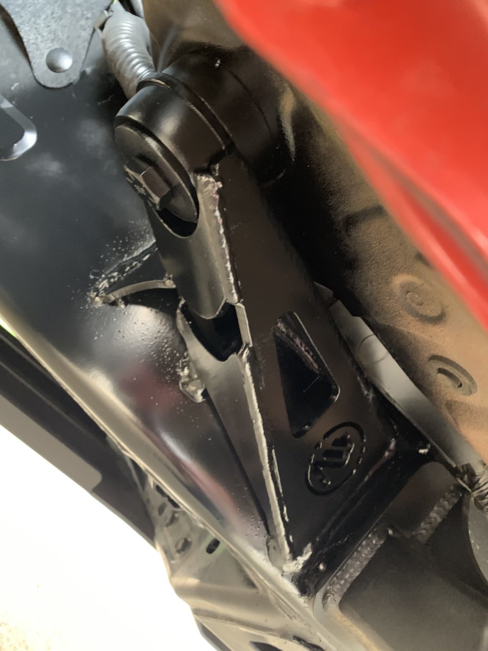

    423A9D89-F359-41DA-8FB8-AE386A19C2DC.jpg Has my Body mount relocation done today.

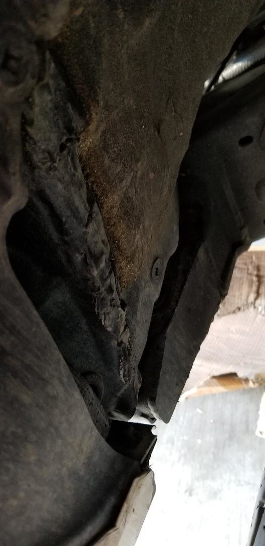

    cmc1.jpgThe CMC, Pinch weld hammered and some minor fender trim.

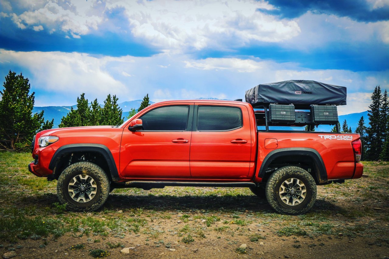

    Finally got my 285/75/17 KO2 mounted on 17x9 0 offset. Just need to do a little trimming on the fender and finish hammering the pinch welds.
    A39F642D-9B56-47B1-A3CE-2F7E65FA84F4.jpg 1A811EC6-F438-4EF4-AAB7-9EF8F052D9A3.jpg
