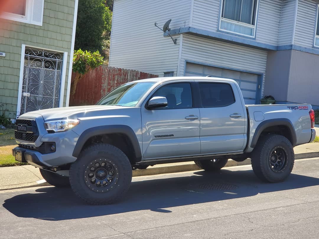

    285/75/17 on radflo suspension

    How do you like the ride on those RAD flows?

    I’m loving it so far it handles pretty well takes all the bump and potholes. Haven’t taken it off-roading yet but soon I will

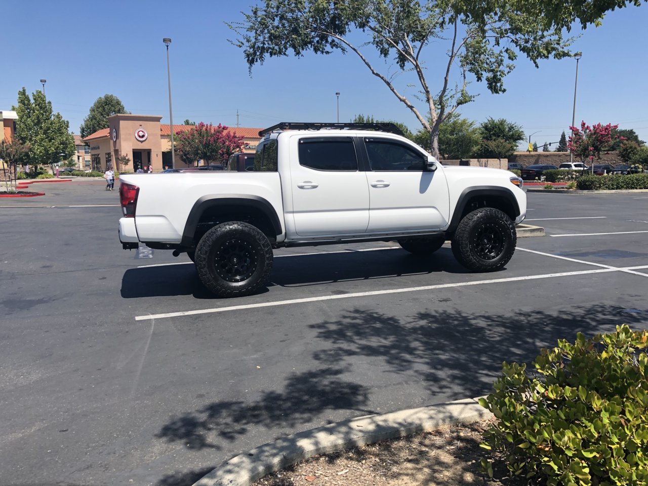

    Did you go with the 17x8.5 4.3bs on the f5’s?
    Edit* just saw your build thread. -38 offset. Looks sweet.

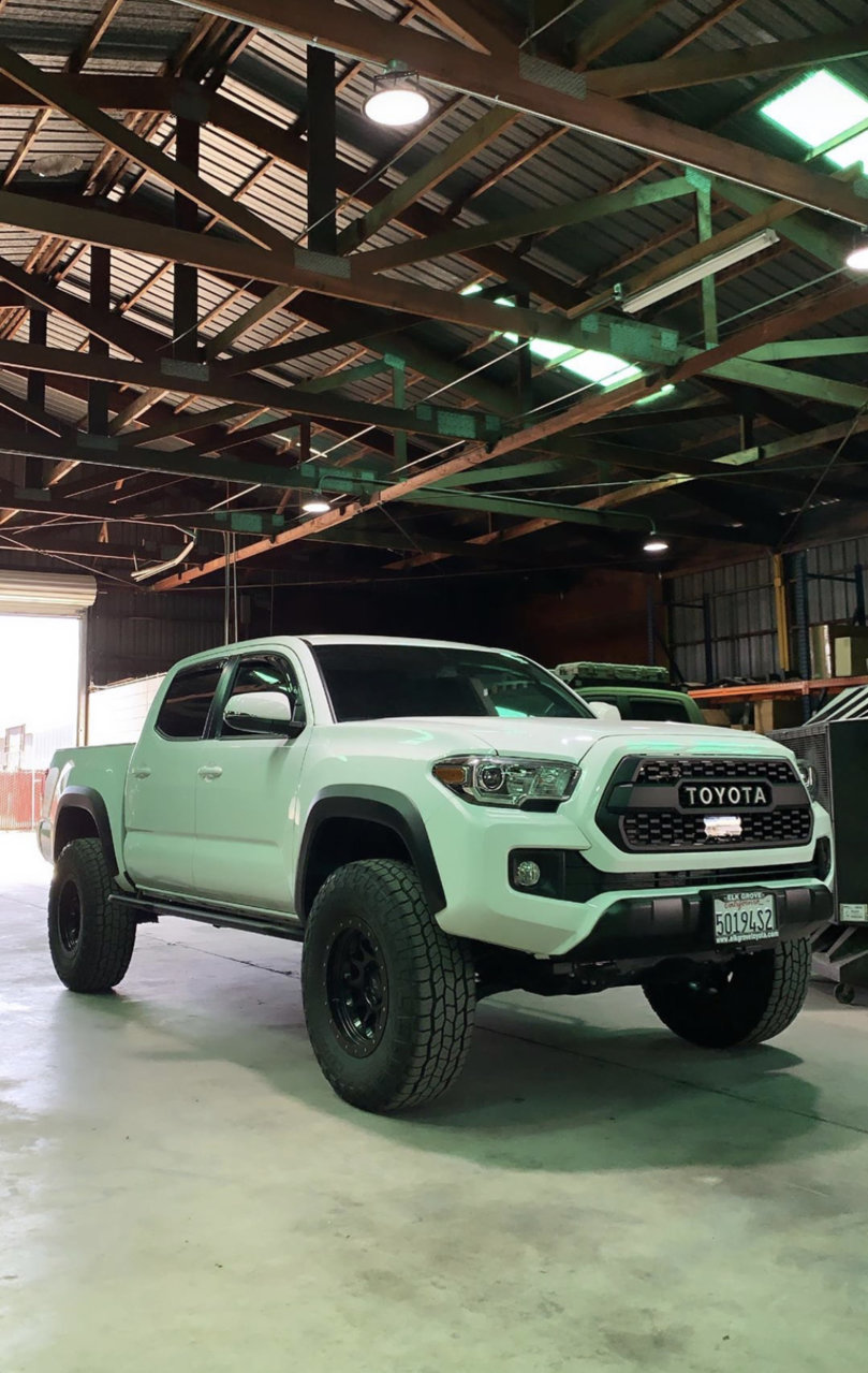

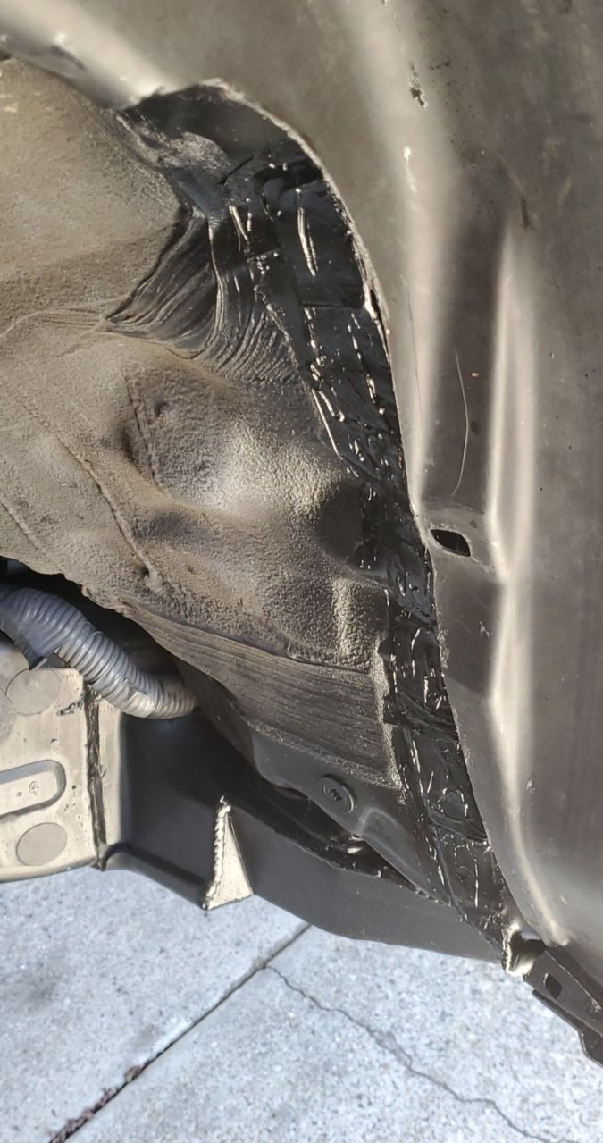

    285/75r17 with scs 17x9 -38
    No rubbing on full lock. I plan to take the truck to hollister this weekend to play around with it. CMC, Pinch weld and trimming done by Milogen Fabrication in Milpitas,CA. Milo's the man!

    Looks awesome. Let us know if there’s any issues in the rear with that offset when it’s stuffed.

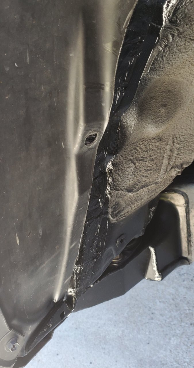

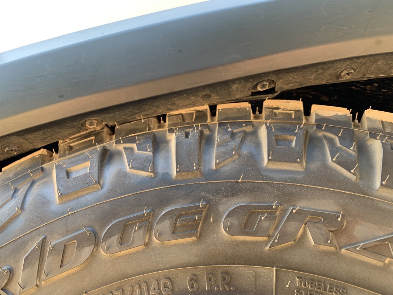

    Here’s a full stuffed -38 with 285/75/17s. Nothing horrible or signs of excessive wear.

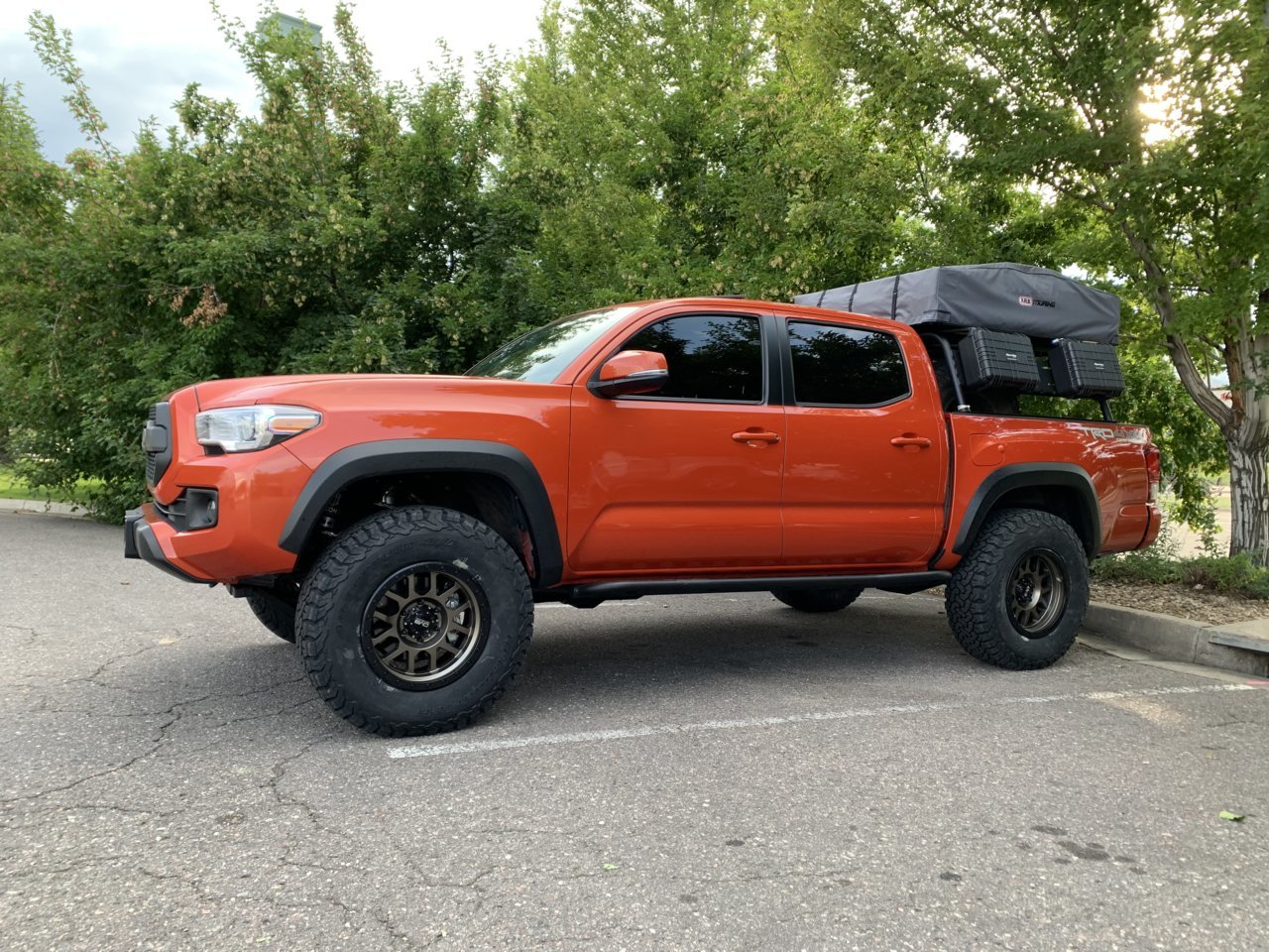

    Nice rig OP!

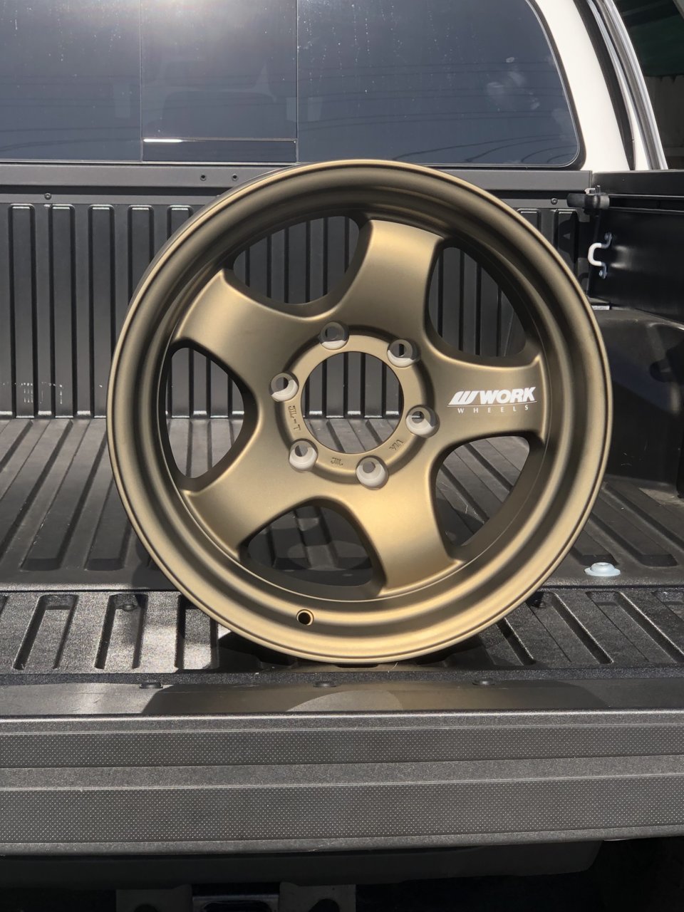

    Will be swapping the ray 10s for my new work wheels.

    looks good to me, i'm going back and forth on SCS F5's 17x9 -38 offset and 17x8.5 -10 offset. I feel like the -10 will fit better but I like the look of that -38 offset, what upper control arm are you running? did you have alignment push your wheel forward a bunch? anyone running some scs 17x8.5 -10 offset wheels with this tire?

    I’m running Dobinson’s UCA. If I were to do it again I probably would have done the 17x8.5 just so I didn’t have to trim my fender I. The back so much. But I love the stance. So it’s a compromise. I’m at about 5.1/5.2 caster. I may switch my UCA to SPCs to push it forward as I still rub my driver cab mount a tad in reverse driver full lock.

    They’re stout and gave me about 5 degrees of caster. All trucks are different as even with that alignment spec, and with 17x9 -38 and 285/75/17, I still slightly rub my driver cab mount
