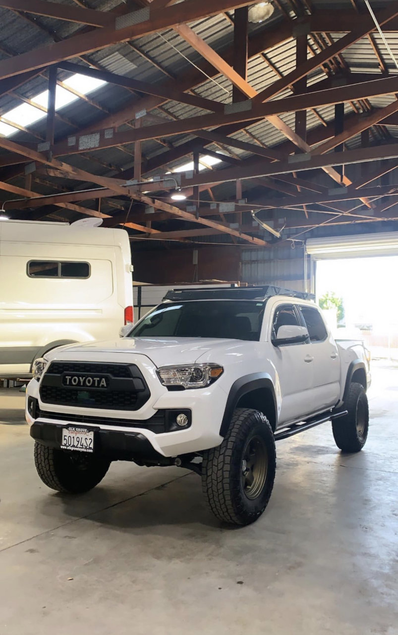

    I went with cooper at3 xlt
    My suspension is between 2.5-2.75 inches
    I only get some rubbing in the front bumper when I’m turning out of my driveway

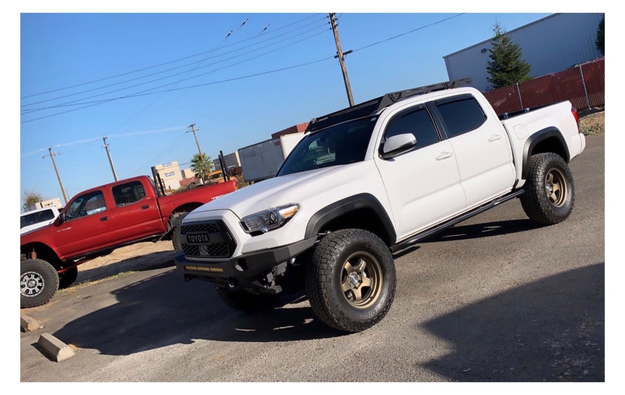

    No more rubbing!!

    Looks really good

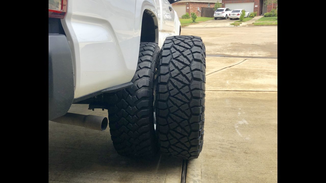

    Tires arrived, just had them mounted on the ray10’s, now they get to wait a little longer :(
    Too many other primary duties today, hopefully I can test fit them Saturday and see how much I’ve got to cut.
    A bit taller than my hankook MT 285/70’s with about 12K miles.

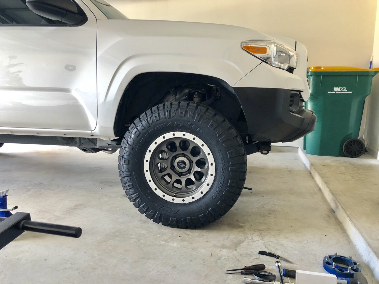

    A little test fitting, but they will need to wait until BMC to run them, don’t was to F them up. Will most likely install the TRD Silver center caps.
    This setup weighs 90lbs.
    SR5 4runner wheels & 285/70/17 hankook mt weighs 91.5lbs + around 3lbs for the spidertrax wheel spacer.

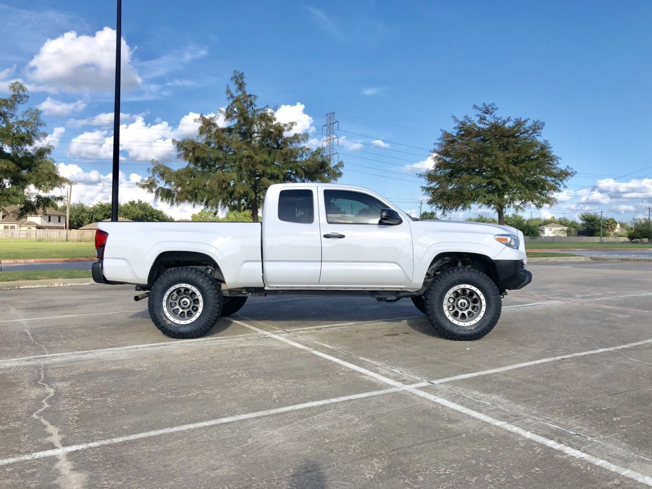

    Ran it around the block, cycled the wheels left to right and did not rub. I think I’ll be ok until next Thursday for my BMC, so I’m running them now !

    Is that on stock height with 285/75/17?

    Doesn’t look like it. I think I see some Icon coilovers up front.
    Looks like you have the -12 offset wheels you should be good. I need to get some SPC control arms. My Dobinson’s isn’t giving me enough alignment adjustability to clear my -38 offsets im a little over 5 degrees on each side but still rub a hair reverse driver lock. I figure I’ll go to 35s on my next go around and will need the SPCs anyway.
