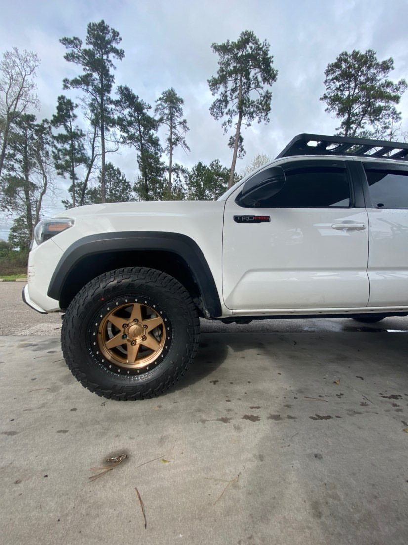

    Get the br6 in brushed copper! My buddy is rocking his

    What lift did you need for your Pro to run those tires?

    Yeah that extra 0.8” makes all the difference. ;)

    More-so the width. And yes the height of course :) I run a skinny 35”.
