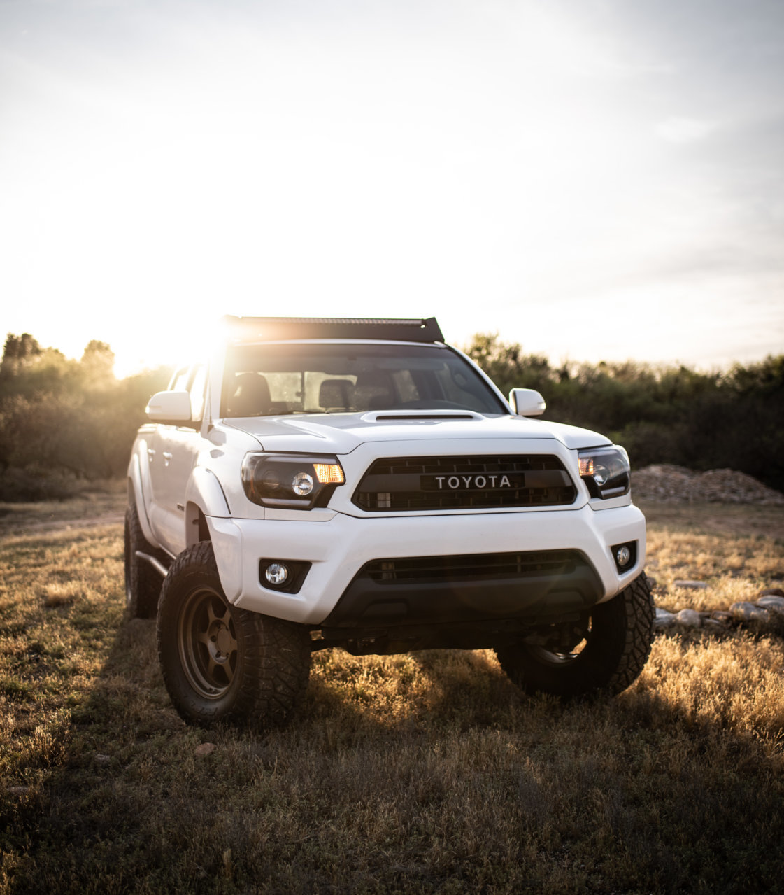

    Perfect size for the 2nd gen too. Still need to do my CMC, but running 5 degrees of caster with very minor rubbing at the moment. Love the new stance.

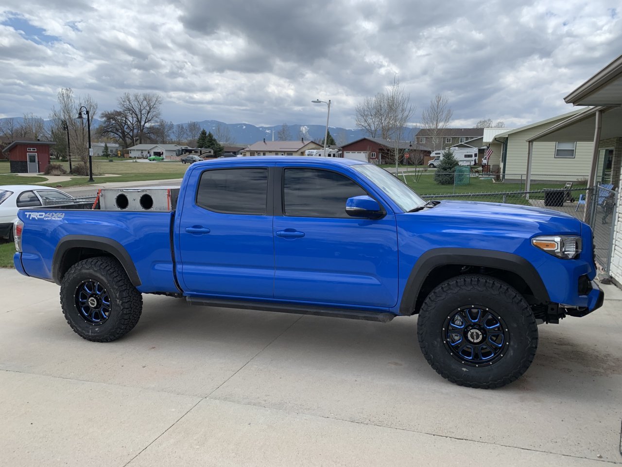

    Could I run 285/75R17 (33.83") on just the 4" spindles up front or would I need the CMC? Tires are going to be mounted on 4Runner TRD Pro wheels (17x7, 4.5" BS, +4mm offset)

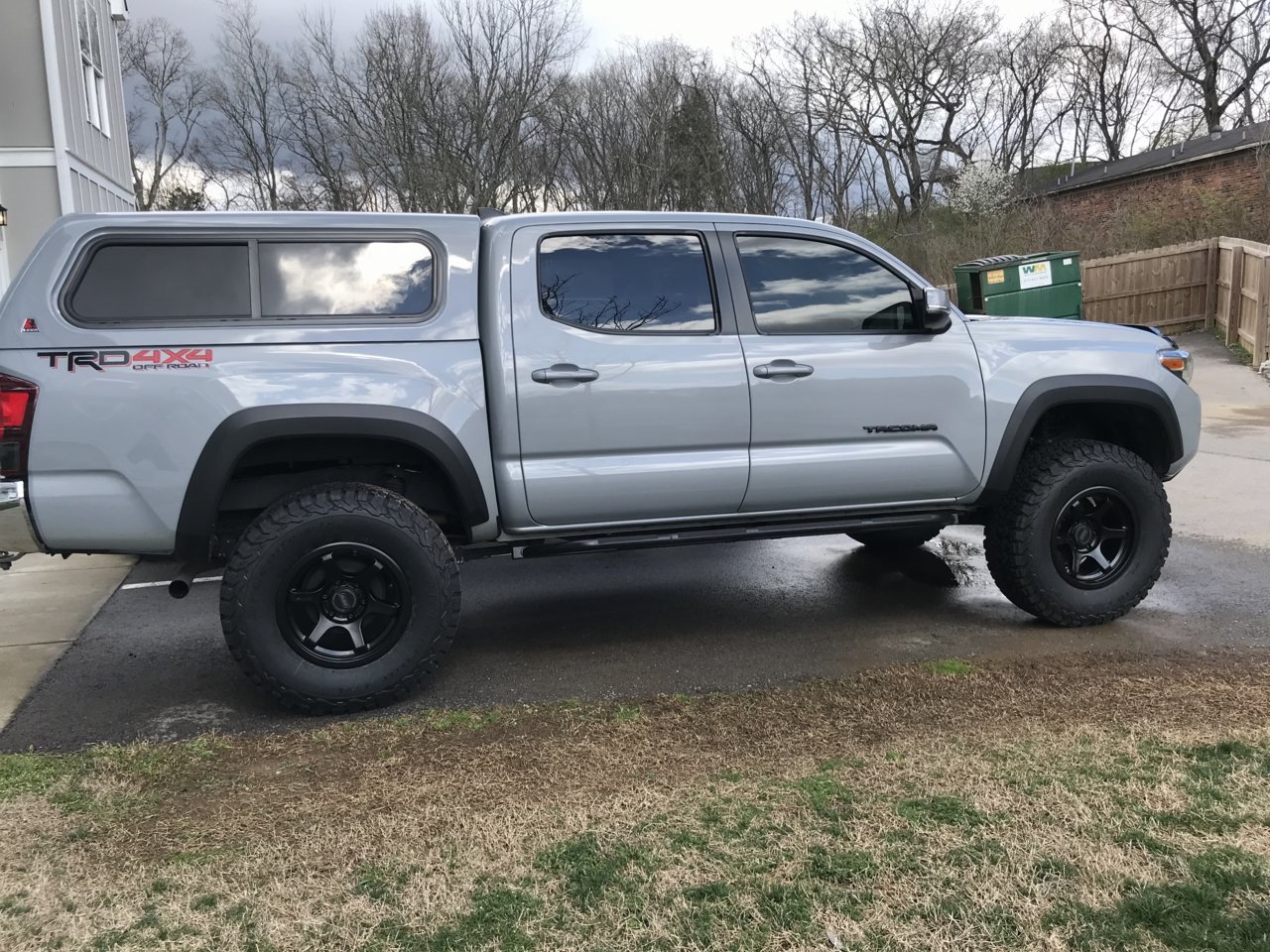

    These have been sitting at my house for months. Finally got them mounted up to some 285/75r17 BFG KO2’s and I freaking love them! This size is perfect for me. Still need to get my CMC and other clearancing done but it’s fine for driving around town for now.

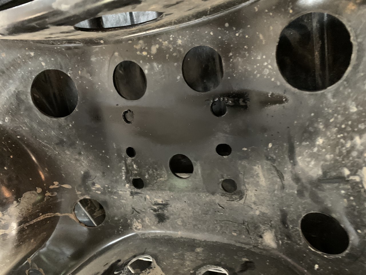

    For those wondering, yes you can fit a 285/75r17 under the bed. I moved the hoist backwards a few weeks ago, and already chopped the exhaust. The passenger side tire tab needs to get hammered nearly flat (I bent it up slightly once everything was in place), the driver side one I don’t think needs to get touched at all (I hammered it and then re bent it). It’s a bit of a two person job to position it because you have to push it back and towards the passenger side, but it is solid once it’s up there. As you can see, it’s a very tight fit, but there appears to be adequate room for the brake lines and diff. Time will tell!
