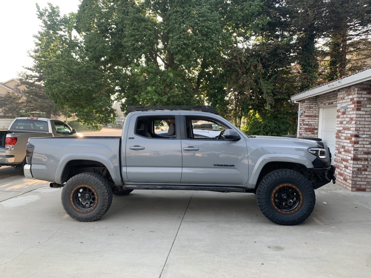

    Figured I add mine here - 285/70/17
    Funny thing is I didn’t rub until after my CMC... Which makes no sense at all... but oh wells...
    demiTacoma and Jacked Burton like this.

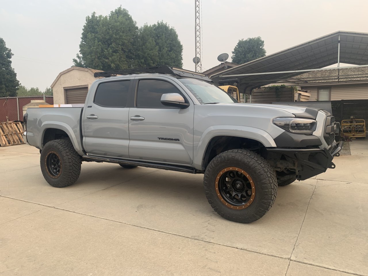

    2019 Cement Tacoma Sr5
    Going to 35s anyways! (35 up front versus 285 in rear) - No i don’t drive like this, just a spare to get an idea of what trimming I need to do.

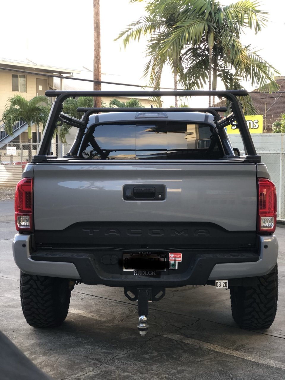

    Trying to plan out my build, for those of you running a 5160 and 6112 with spc or jba upper control arms, what did you do to make this fit on a 3rd gen? I have a set sitting on ray10 with -10 offset.
    CCWTaco and BroID like this.

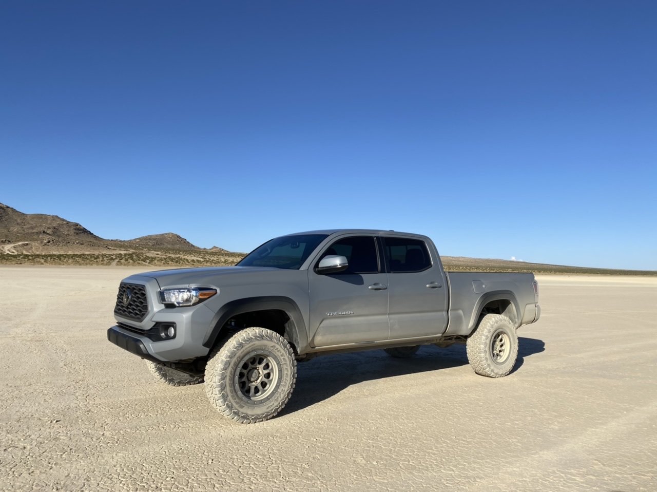

    Old post I know, but that should work. I was initially leaning this way as well, until my local shop pointed out that:
    - The methods are strong, but really heavy. Compared to an SCS in the same size, expect to be 7-8lbs per corner heavier on the wheels.
    - Unless you routinely touch single digits you probably don't need bead grip. They said they regularly go down to 15psi and couldn't blow a bead even trying with a fully built Tundra.

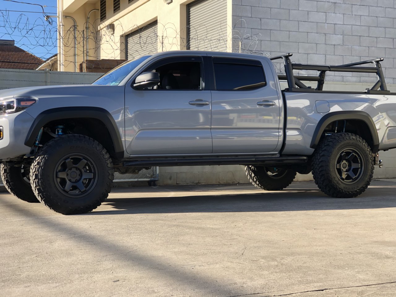

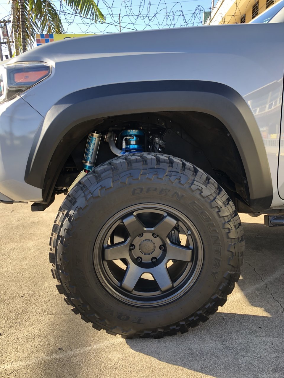

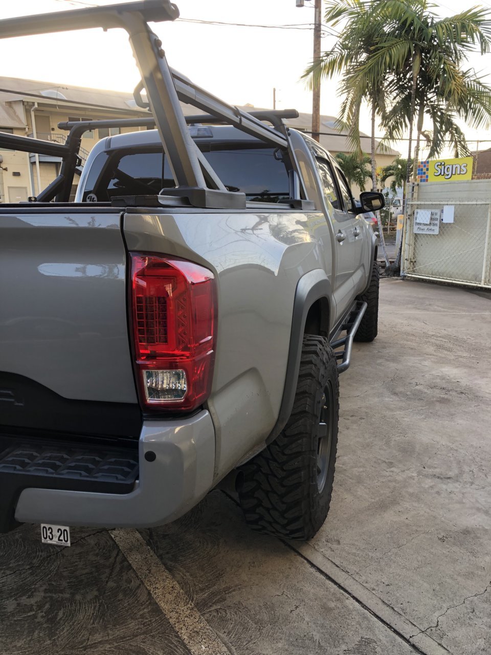

    Thanks man - depending on your wheel offset, more than likely you'll have to flatten the pinch welds too and possibly trim the rear corners of your plastic fenders. No rubbing on the street, but some minor rubbing when off the pavement.
