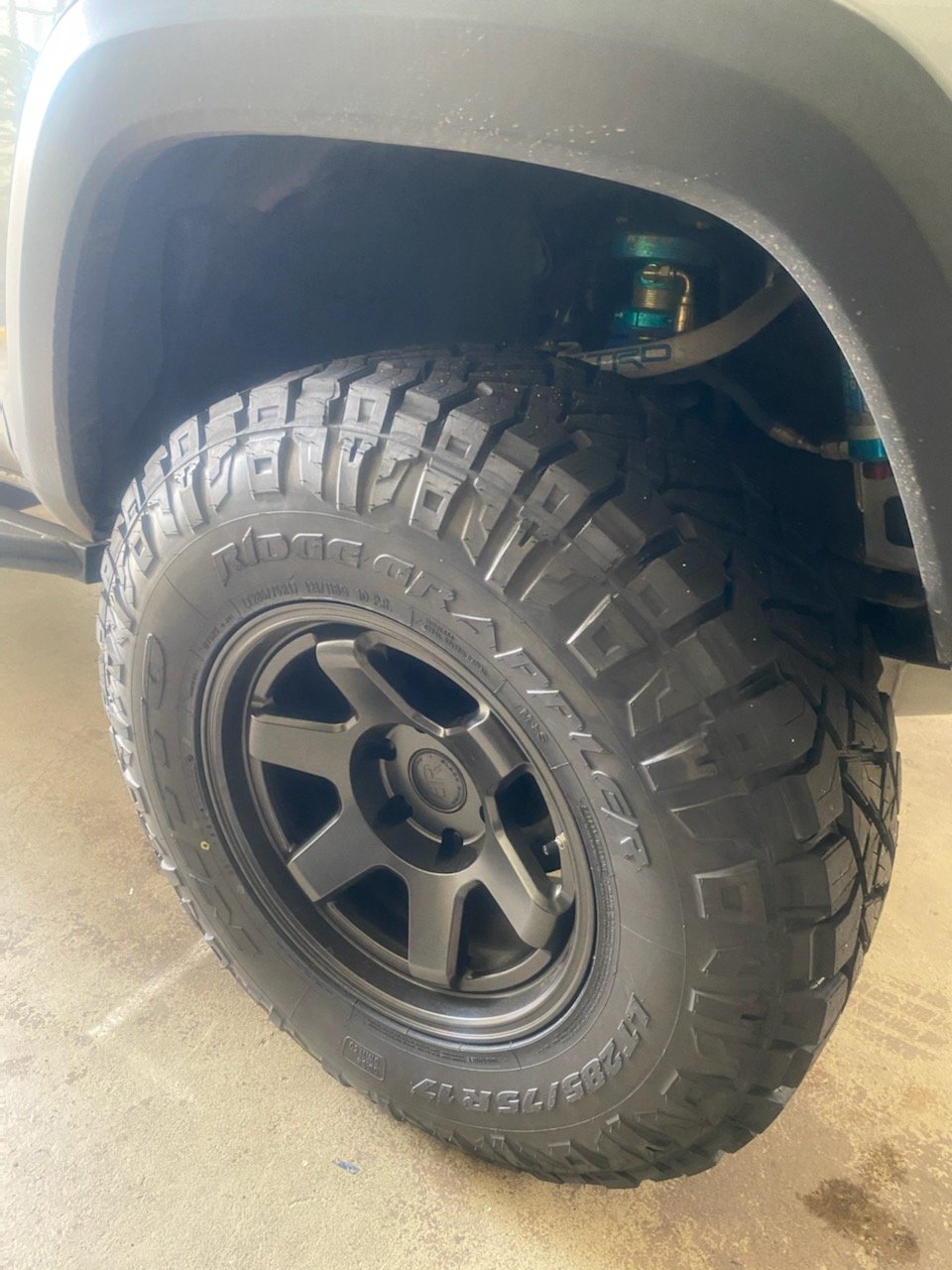

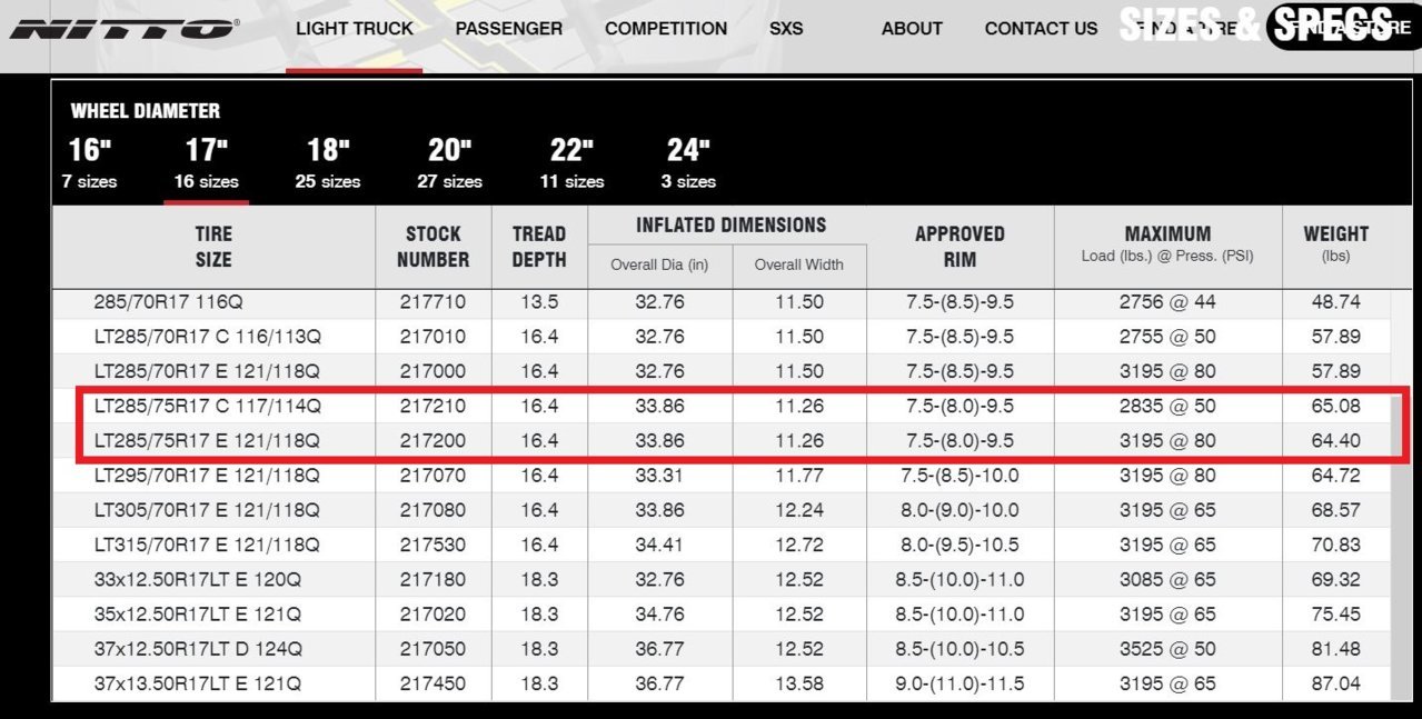

    mlr69
    mlr69 I had a savings account before I joined TW
    May 3, 2018
    #252413
    726
    South Carolina
    2018 TRD Sport 4x4 DCSB
    2" ToyTec/Eibach Pro Sport Lift Kit -SparksParts.com 3/4" ToyTec Front Top Plate Spacer Kit -SparksParts.com SPC Performance Upper Control Arms -SparksParts.com Nitto Ridge Grapplers 285/75/17 (34") -SparksParts.com 1.25" Spidertrax Wheel Spacers -SparksParts.com Hypertech Speedometer Calibrator -hypertech.com Predator Tube Steps -SparksParts.com BAKFlip G2 Tonneau -SparksParts.com OEM Rubber Bed Mat -SparksParts.com OEM All-weather Floor Liners -SparksParts.com Gentex Frameless Mirror with Homelink @RJP869 Subaru/Kicker Tweeters -amazon.com Kicker Door Speakers (x4) -crutchfield.com Radio Knobs @Tacowiede Vehicle OCD Glove Box Organizer -amazon.com ‎JoyTutus Center Console Tray -amazon.com FormulaOne Pinnacle Window Tint -SparksParts.com ACDF Horn Kit @BartMaster1234 Total Tail Light S1 Kit @MESO ECT Button Relocation Kit @Tacowiede Minimalist Key Fobs @MESO Ultimate Map & Dome Lights @MESO Fortin EVO-ALL Remote Start w/Cell Module @jmeitz Coin Bucket with Lid @MESO GermesLab Camera Control System @FreshMexicanTaco Natika Front View Camera -amazon.com VLEDS LP Reverse Light System -vleds.com LIFTd Customs Fuel Cap Cradle @JIMMEISTER OEM Power Tailgate Lock -SparksParts.com OEM 2022 Limited Grille -SparksParts.com OEM 2022 Limited LED Headlamps -SparksParts.com LED Headlight Conversion Harness @daveeasa Headlight Trim Plates @MESO OEM Door Sill Protectors -SparksParts.com Diode Dynamics Elite Fog Lights @memario1214 Fog Light Backlighting PNP Harness @daveeasa TacomaTime Dash Cubby Drawer -etsy.com FPE Fogs + High-Beam Module @memario1214
    I have E. E=10 ply, C=6 ply. E will be stiffer and will carry a heavier load.

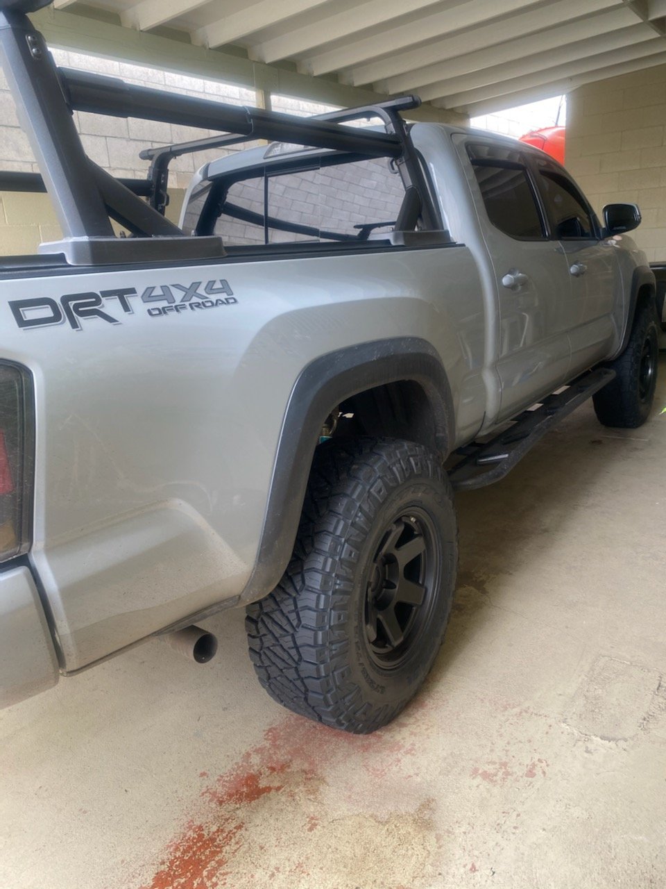

    #595
    jhipwundah
    jhipwundah Well-Known Member
    Jan 9, 2018
    #240779
    146
    Oahu, Hawaii
    2018 Cement TRD Off-road DCLB 4x4
    Made the switch from Toyo MT's to Nitto RG's. Definitely a quieter and softer ride. Not the best pics since it's stuck in my driveway lol.IMG_1908.jpg IMG_1909.jpg
