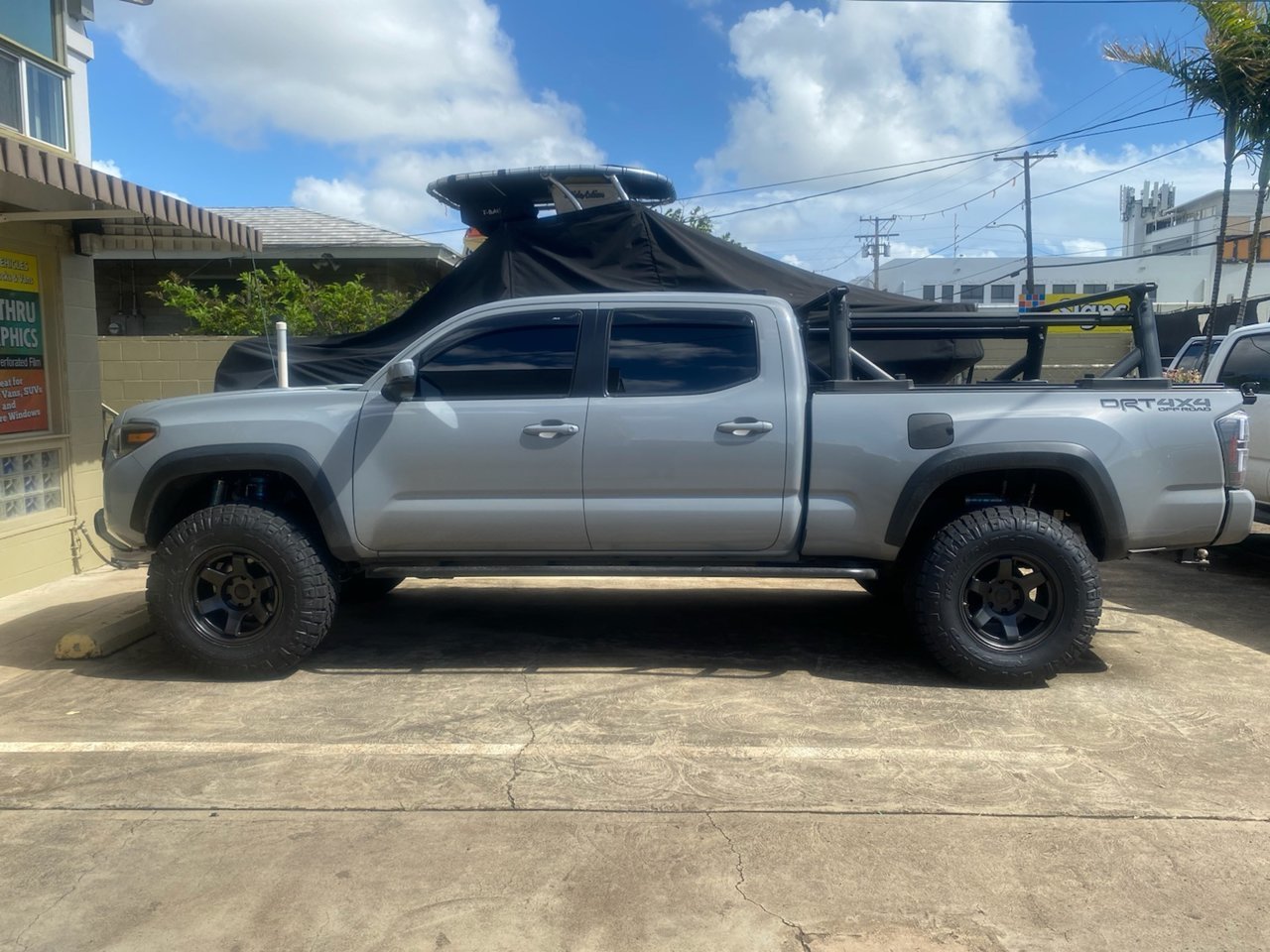

    Nice build - I went with Black Rhino's myself (17x9.5 -18). Tried to go with a brand wheel a little different from most.

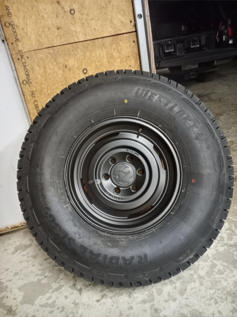

    My brother and I just scooped some Fifteen 52s for our company trucks. They are low on the flashy side. We put them on next week so we'll see how they ride Westlakes on 52s.jpg

    #235337
    721
    The Gem State
    2017 Tacoma TRD off road
    BFG KM2 255/85r16 Bilstein 5100s OME 888, HD Dakar’s, JBA control arms, BAMF Shackle hangers and shackle.
    Those are freaking sweet!!!
