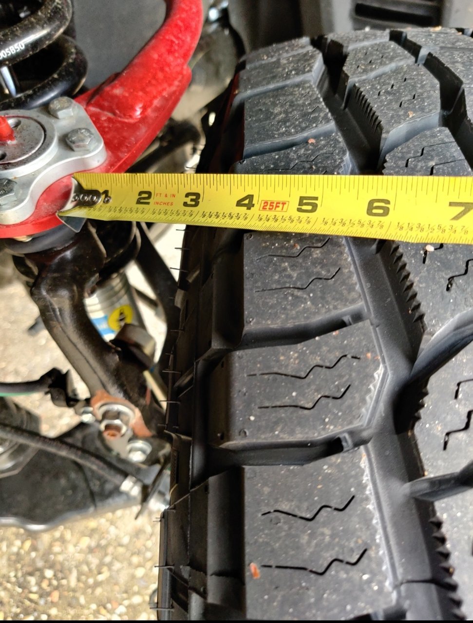

    Looks great! U got a picture of the clearance between the tire and uca? Trying to get an idea of what the smallest spacer I can run. Thanks!

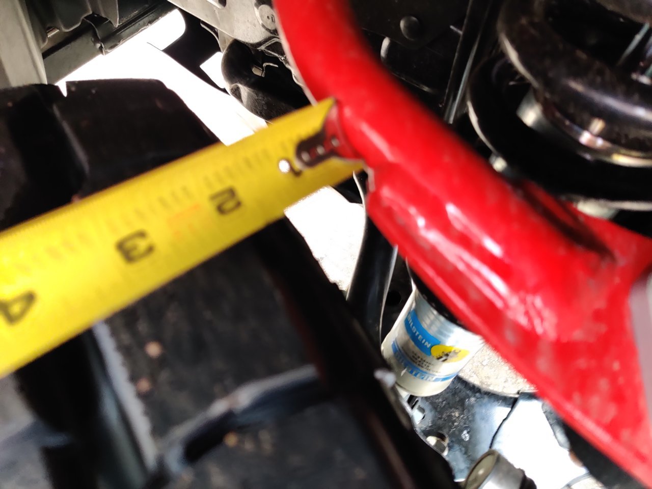

    Full lock driver

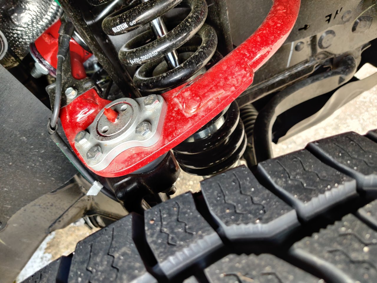

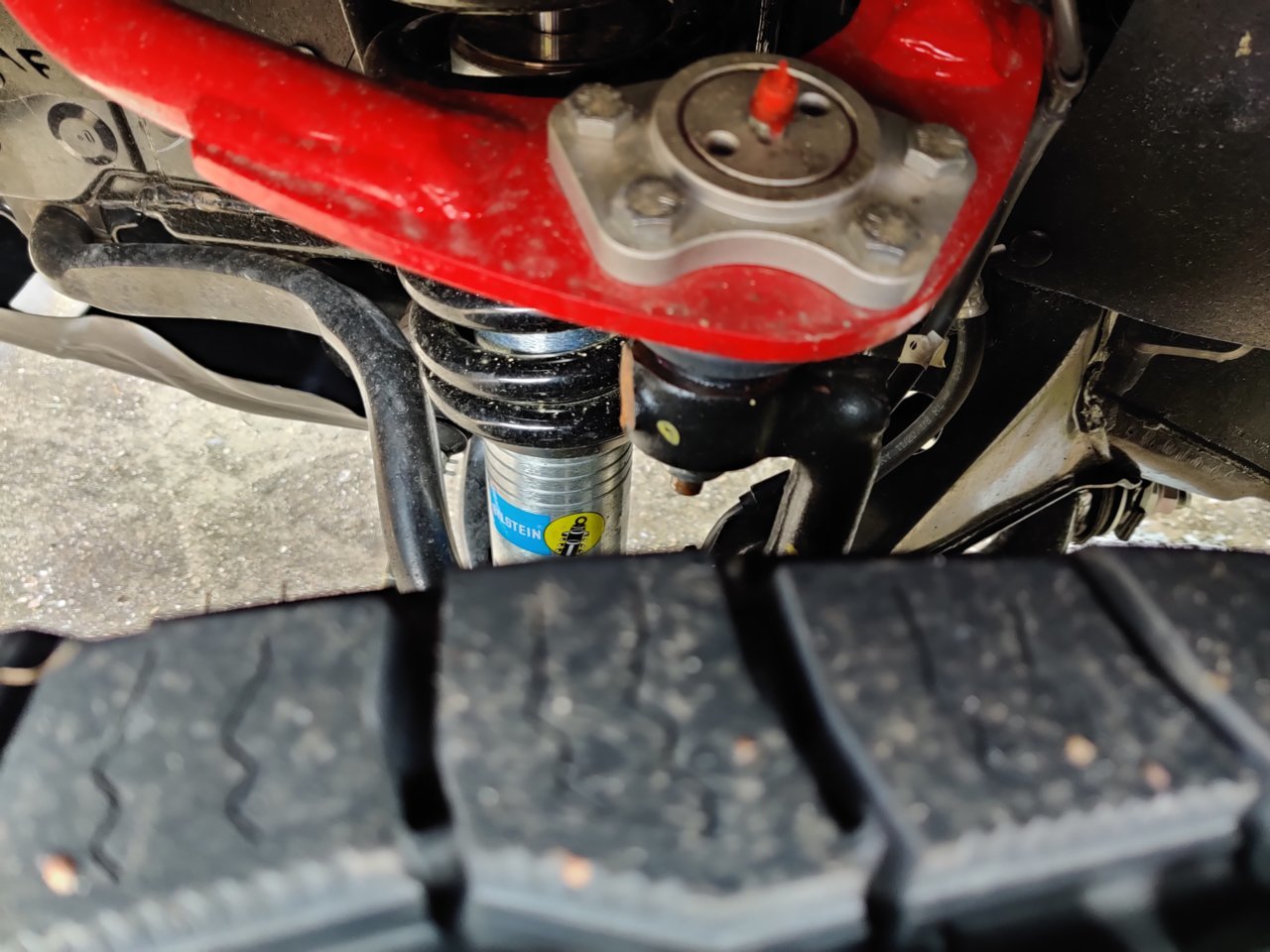

    A lot of clearance. Wish i had gone .5" to minimize rubbing which might be a non-issue after alignment.
    17x8.5 0 offset 4.75bs

    Thanks for the photos! Think I will go with 1/2” spacers to start with. I have spc ucas but I’m sure the size is similar to the jba ones.. damn 0 offset :annoyed:

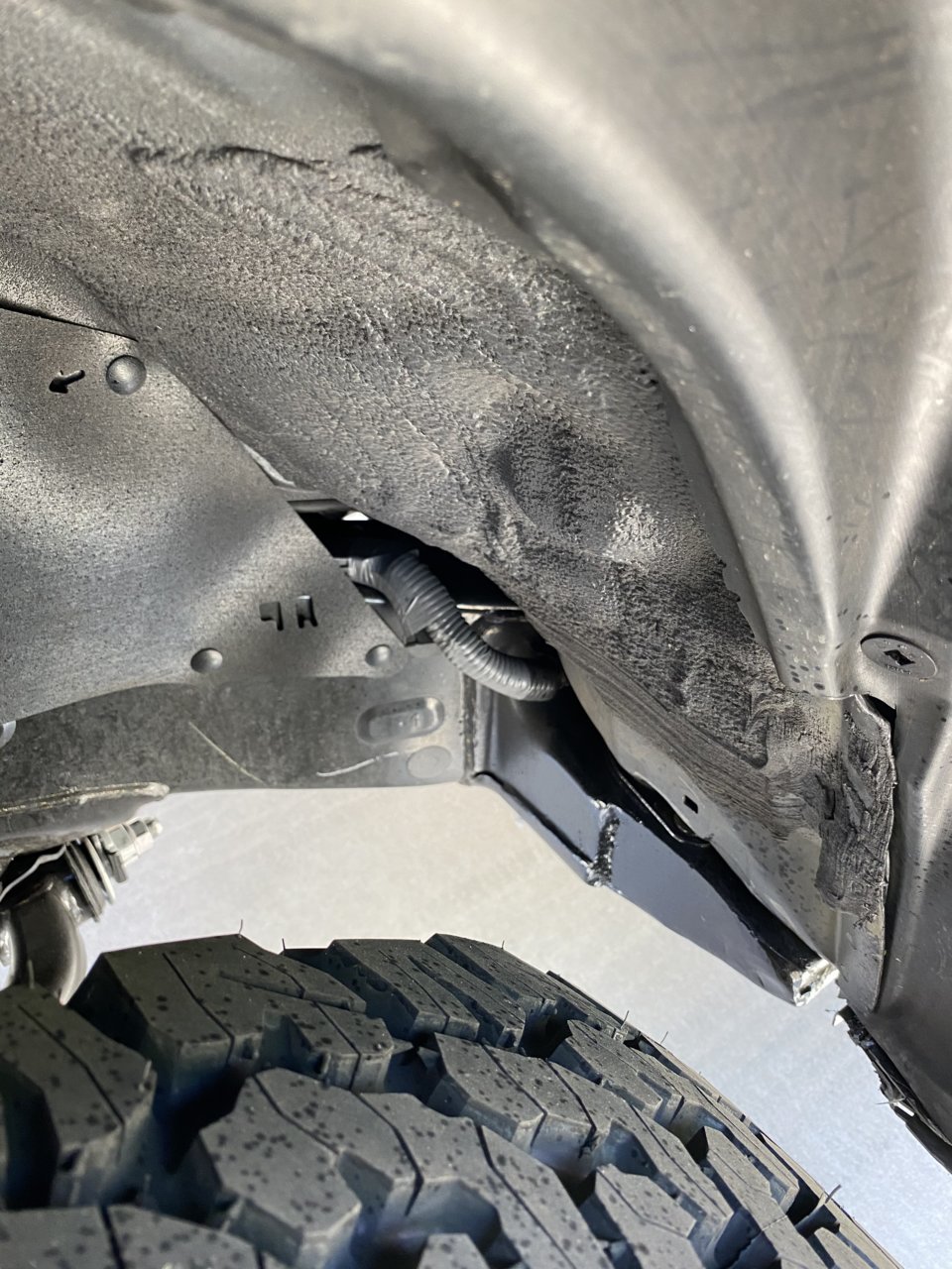

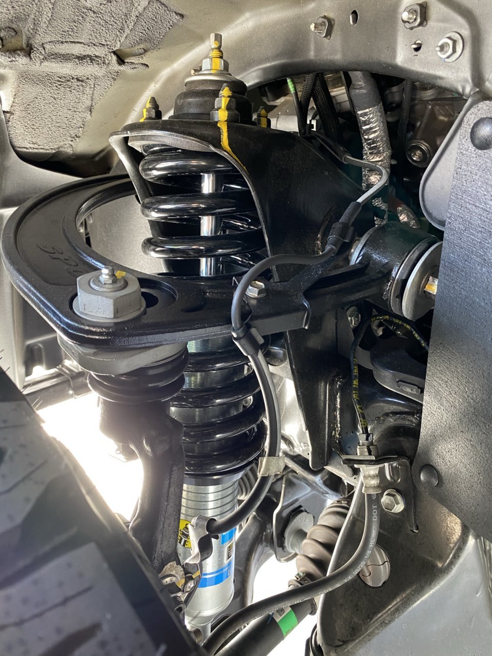

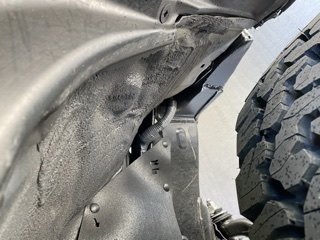

    You got it right, SPC’s and 6112 with 0 offset. I didn’t run spacers, but had to do a pretty considerable CMC to avoid any rub.

    You able to drop some clearance photos? Trying to gather all the parts and things necessary beforehand to make the job quicker. Also you said you had to an aggressive cmc to avoid rub, was that before or after alignment?

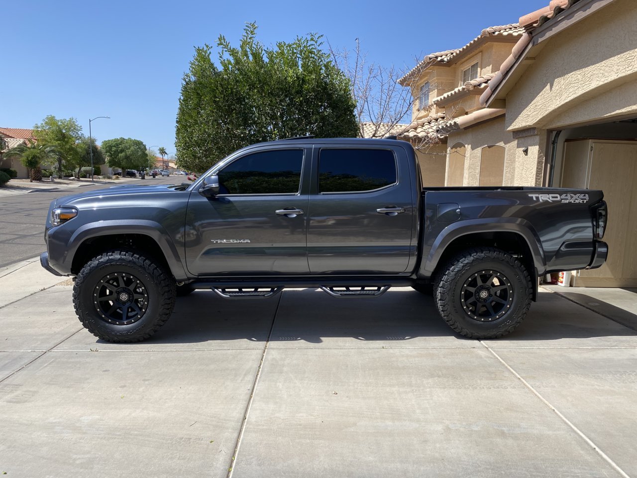

    Niiice! Truck turned out super clean @Sig Taco !! How’s it ride? Looks great! Shouts out to the fellow icon rebound family

    I keep trying to upload these pictures and they turn out sideways, not sure why... so I’m going to try individual posts maybe

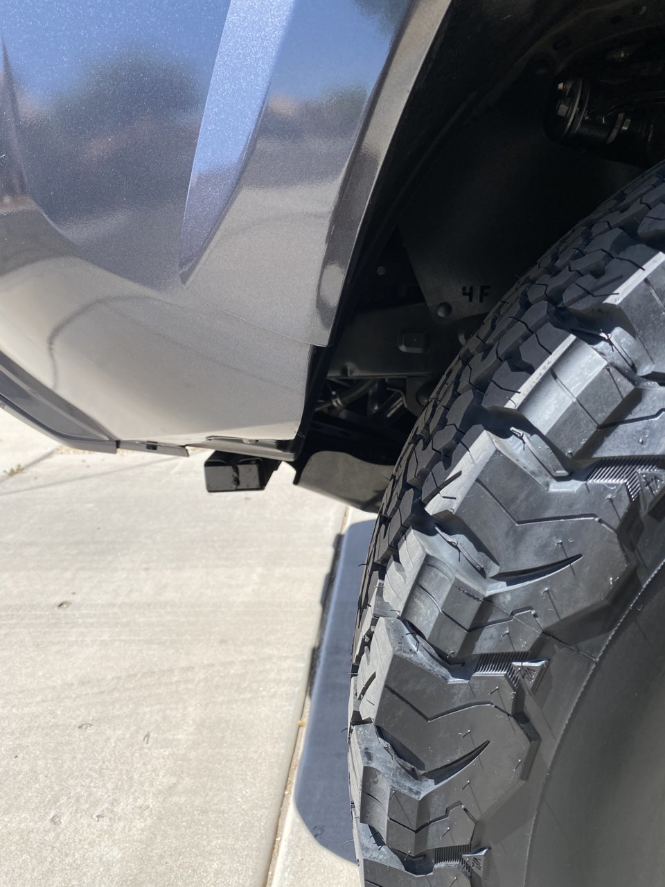

    CMC

    Slight fender cutting for front clearance, but local shop here in AZ, State 48 Overland, made it look insane clean

    @Jmillie52 looks good!

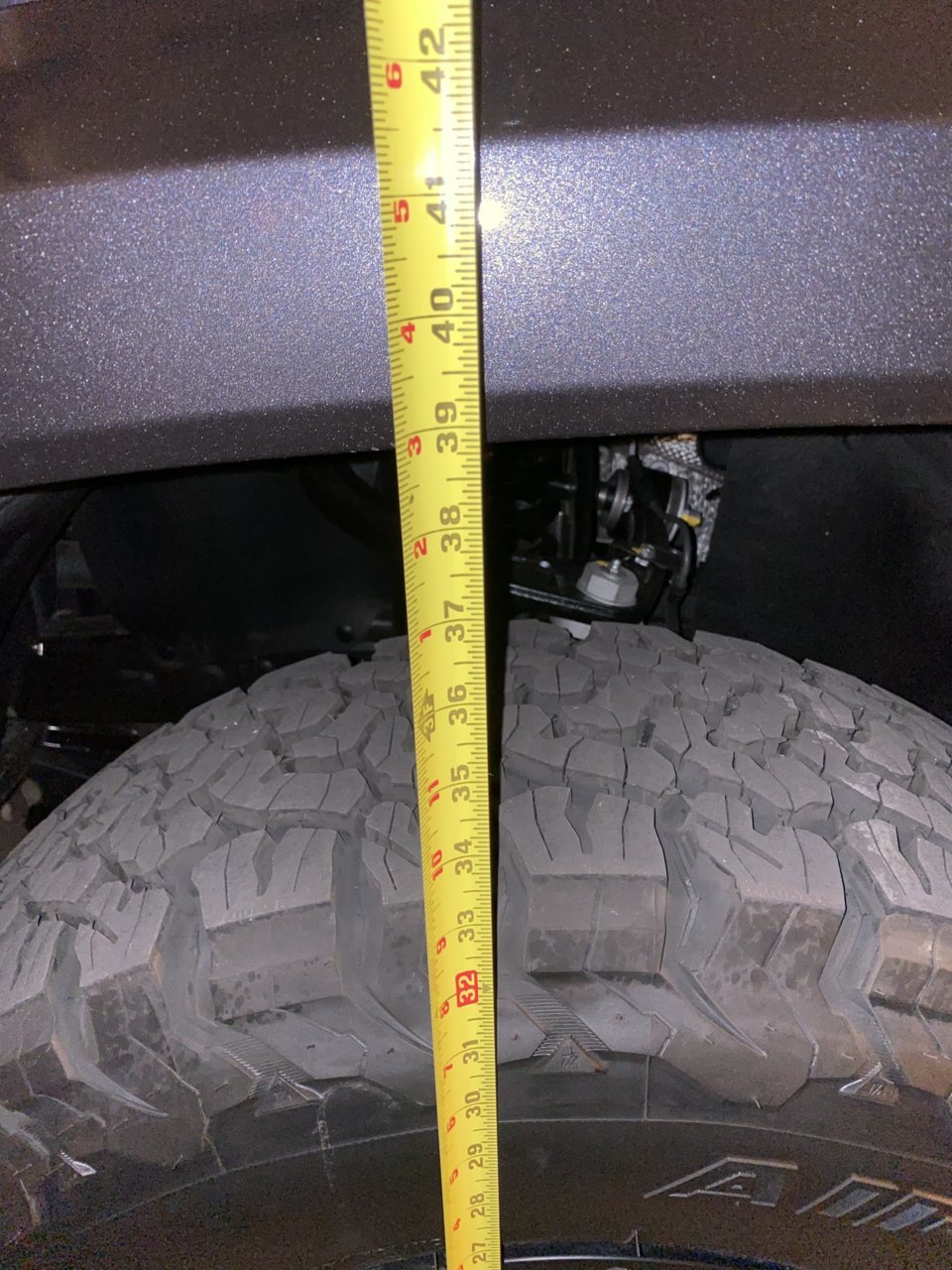

    What was your before and after Caster? Did it look like it help considerably moving the tire away from the cab mount? How much are you from ground to fender?
    My hands are tied right now til my alignment appointment next Wednesday.

    So... zero offset 17x8.5, whats the backspacing on those wheels @Jmillie52 ?
    I thought i was told UCA rubbing might be an issue with those wheels specs but it looks like you got plenty of space

    I think JBAs have the issue of rubbing the most. I could be wrong. How do the SPCs compare?

    On the Icon 17x8.5 0 offset, BS 4.75
    I've seen multiple members stating it rubs on the JBA UCA. JBA website says 4.50 BS is needed.
    More of an issue with JBA than other UCA.

    Seen the clearances between the UCA and the tire on their website? It’s like .125inch! Hahaha

    Caster on the left went from 3.1 to 3.2, the right went from 3.6 to 2.7.
    This gives you a look at ground to fender 8846FF0C-8E90-46BB-8850-4DEFBE719CD6.jpg
